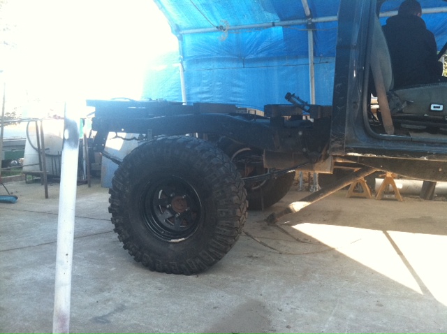

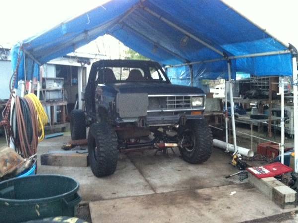

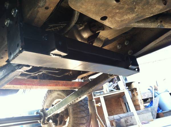

Starting the build is very easy, I started on the rear end first to get some confidence. To make a Full Size axle fit under a ranger, you must move the leaf spring mounts in. I did not weld them up immediately cause I wanted to set the pinion angle. I already had the 63s mounted up on the stock rear end so this was very easy.

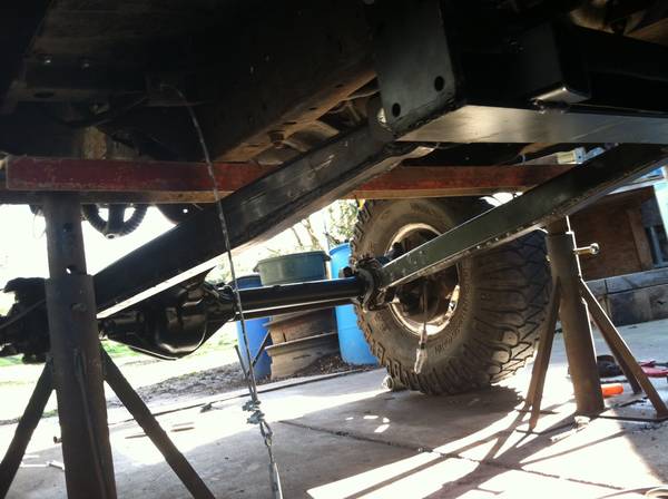

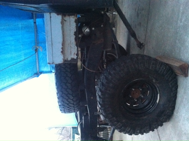

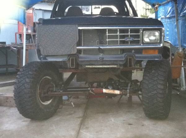

more pics, front axle is completely out, rollers under the front for perspective
What are your plans for the front suspension and steering? ... I'm assuming your extending your wheel base as it looks to be mocked up like...
Im running a 7/8'' Ruff Stuff Steering kit, Ruff Stuff Pan hard kit, Custom Extended Radius arms with Wild Horse 5.5'' coils. Ive got just about everything out of the way now so ill probably roll the axle under sometime this week.Im kinda caught up in school most of the day so i only get to work on it when i get home
Those Wild Horses coils are junk. Go with the ones from Broncograveyard. They are actually Deaver springs, relabeled as BGY.
The WH coils have a tendency to settle a whole lot (mine dropped 3" ), and then they start to bow outwards really bad.
My coils from BGY only settled about an inch, and they worked really well with my Chevy springs and a 7" shackles.
Well, mine are brand new. i got them cheap off a guy on craigslist. Ill wait it out with them and if they turn out to be shit, ill go with the bronco graveyard ones, thanks for the advice. Any advice on how to do the brake lines. I wanna run them with the ttb hard lines. The ones that under the crossmember and to the coil bucket. MY question is what line do i run off of that to each caliber. Or is it some sort of adapter.
I ran mine down the frame to the radius arm mount. Then used a rear hose from a 93 caravan, and continued hard line down the arm and teed it at the diff, my axle lines are for a 78 bronco.
Super easy and isn't. Affected by articulation.
I ran my brake lines the same way. I use a 90's cavaler (buick buick will work or maybe any GM will work as liong as the threads match the hard lines).
Good thing with this brake line setup is my front tires can swing under my truck (picture that) and touch my rear tires and I would still have front brakes. So theres really no flex limit to them.

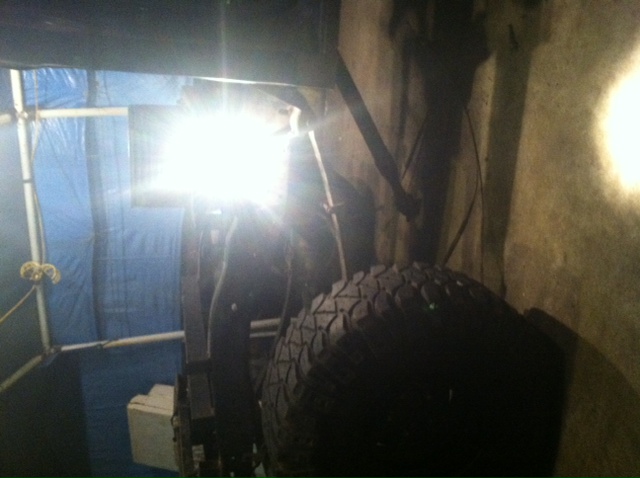

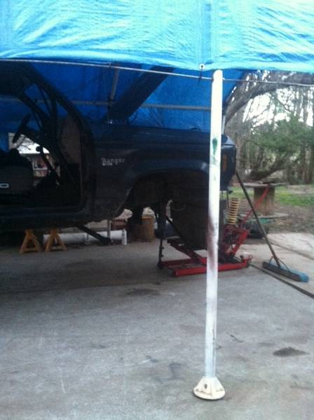

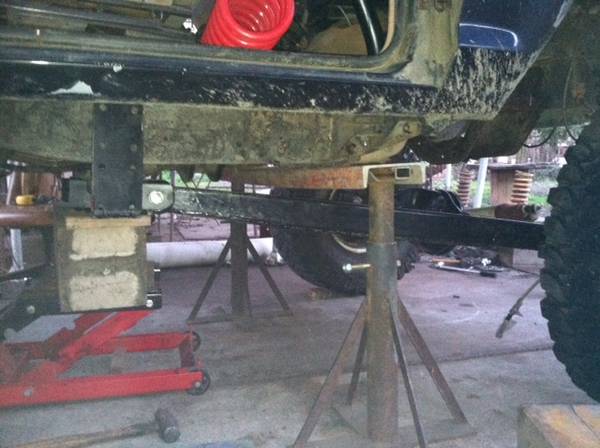

got a little more work done today. Got the axle rolled under. Starting to mock it up.
