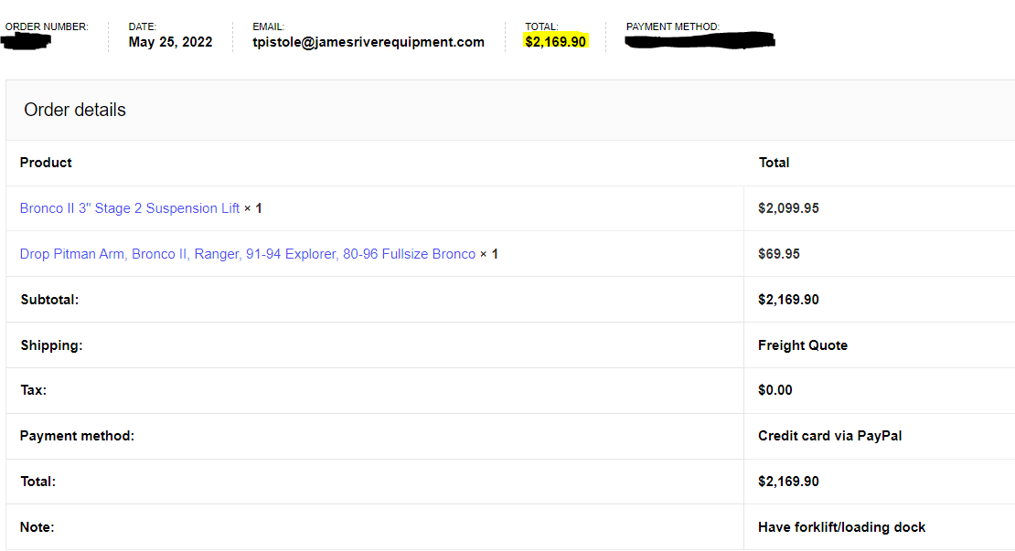

Yep. You know you spend money thinking your doing the right thing and it stabs you in the back as soon as you do it. Honestly thinking there is only 1 bad one, just so happened to be the ONE I left in. Probably swapped locations.. oil is diluted pretty good, gonna change that and put the intake and hood on then hopefully be able to street this thing a little... We shall see. The tractor retracted some of my funds but hoping to order the Duff 3" kit in the next few weeks!

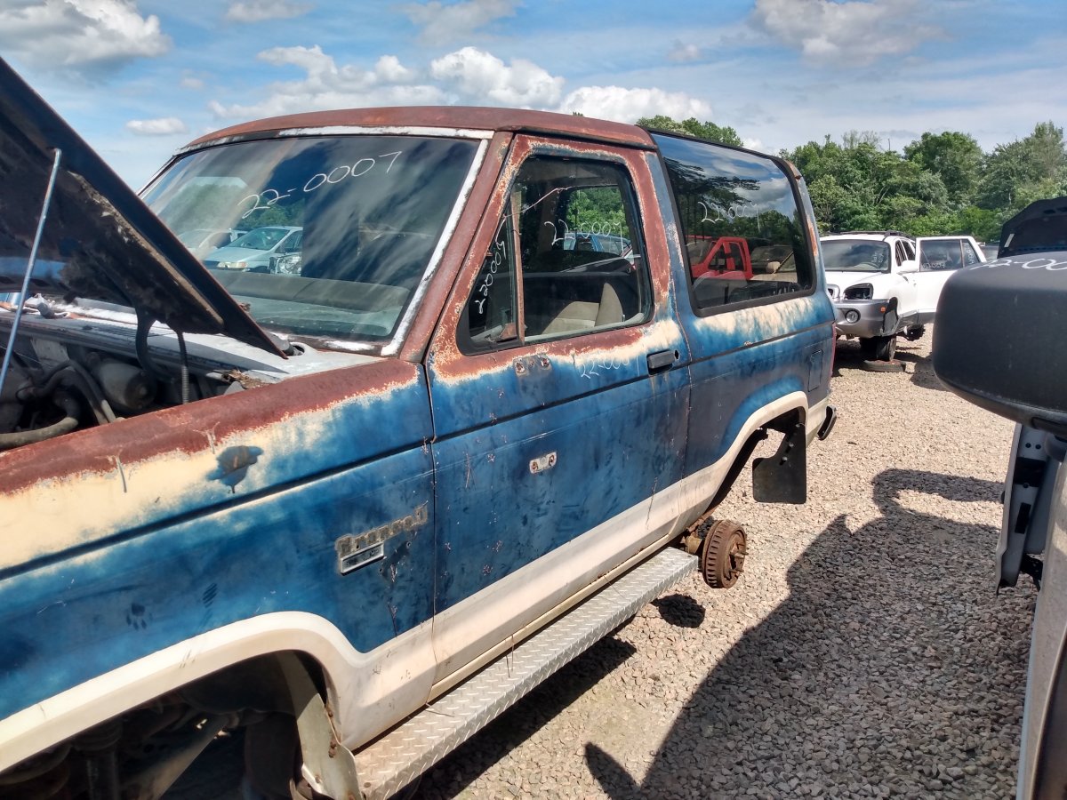

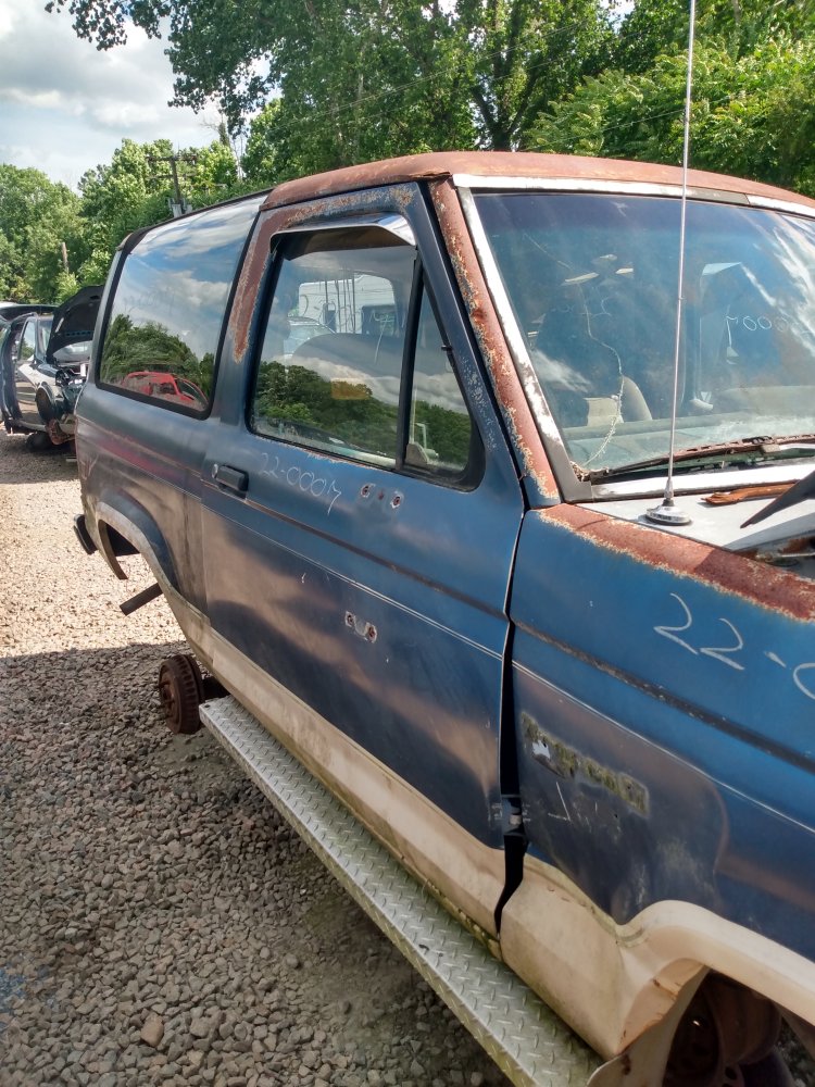

Well the weekend allowed a little time to work on this. Pulled injectors resealed, cleaned, still having issues. Gave up on that for the day in the hopes of getting my power windows working since the dash/engine harness swap. Came to the conclusion that is one of the more dumb wiring designs I have ever come across. So in typical f*@& it fashion decide I'm just going to get 2 manual window doors as I prefer manual windows anyway and my doors have a decent but of rust at the bottom. Stopped by the local pick a part and came across these, Eddie Bauer doors intact minimal to no rust and manual windows? Really surprised to see manual ones in a EB..? They said $100 each so contemplating that this coming weekend as well as the T-case linkage I am in need of hopefully. Thoughts?

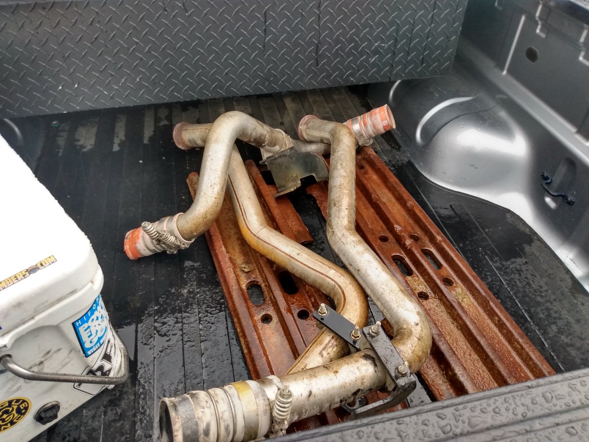

Well this project continues to out whit me. Still have a stutter mainly at low load/rpm idle is smooth. Don’t know what else to replace. Everything is new; sensors, ignition components, ECU, you name it. Looking towards fuel system replacement (lines mainly) as it has a new tank, pump, sending unit already. Vacuum lines are new clamps installed etc. Lift kit is weeks out no clue on time line. Got a few parts today from CSX power unit engine cores to make an intake. Guess that’s almost exciting…
