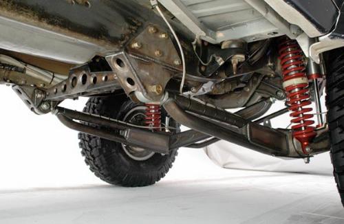

i have a system now, i can acutally get them out pretty quick.  grind a cross through the rivets, then hit them will this chisel punch that i have so they're flush with frame, then knock them through the hole with a punch.  it's still a PITA though
