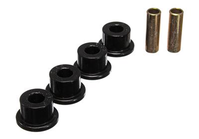

For your control arms axle end use these.
http://www.summitracing.com/parts/ENS-9-9489G/
If you want I can throw a scrap piece of 2" DOM .250 wall in with your other parts. Just need about 4" of it to make the ends.
i looked into doing that, but DOM is hard to find around here and fawking out the ass expensive when you do find it. sending you a PM in just a sec.
bushings are on the way from summit. i need to use them more often. it was only $5 for "delivery/handling fees" and free shipping. $21.xx shipped to my door. not bad
