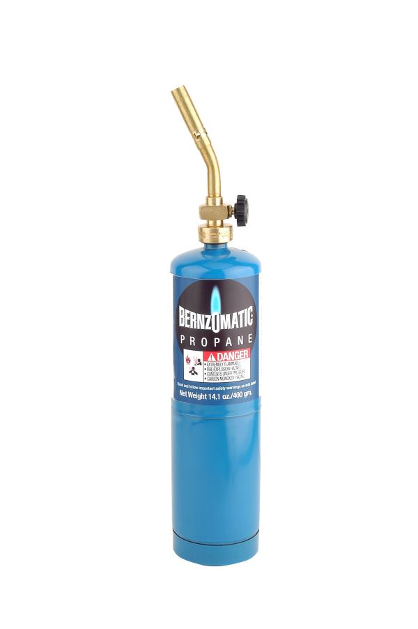

like this? it's all i have besides the oven

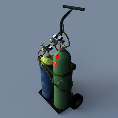

well, that's a little slower than something like this

but i guess it'd work. lol
the pic wont show up for me here at work, stupid website blocker.....i assume it's an acetylene torch? i need to get one of those, it's on the list, i just always end up buying a gun or something to go on a gun. i could use charcoal probably
you don't have an oxy ace torch? really?
nope, my grandpa does, but he's an hour and a half away. never really had the need for one.
