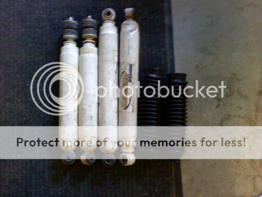

dont need too much more before i have everything for the lift. i also bought some used rancho shocks for another TRSer as well, they shipped out today.

shocks came in from another TRSer, legoms, they're rancho rs5000's
