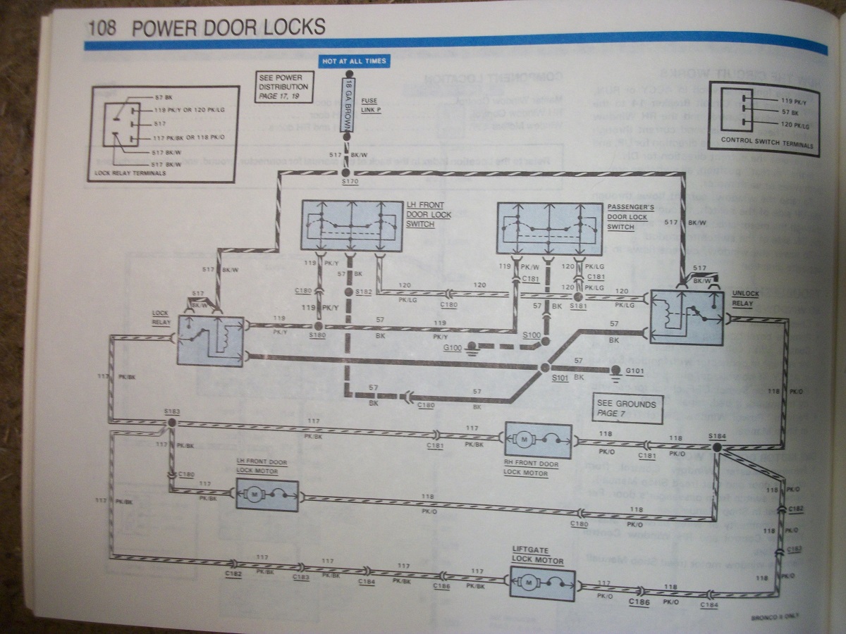

I'm sorry; we got crossed up working on two systems at the same time. Power windows- no relays. Doorlocks on an '88- does have relays. Gimme a minute and I'll post the EVTM pages you need to figure it out.

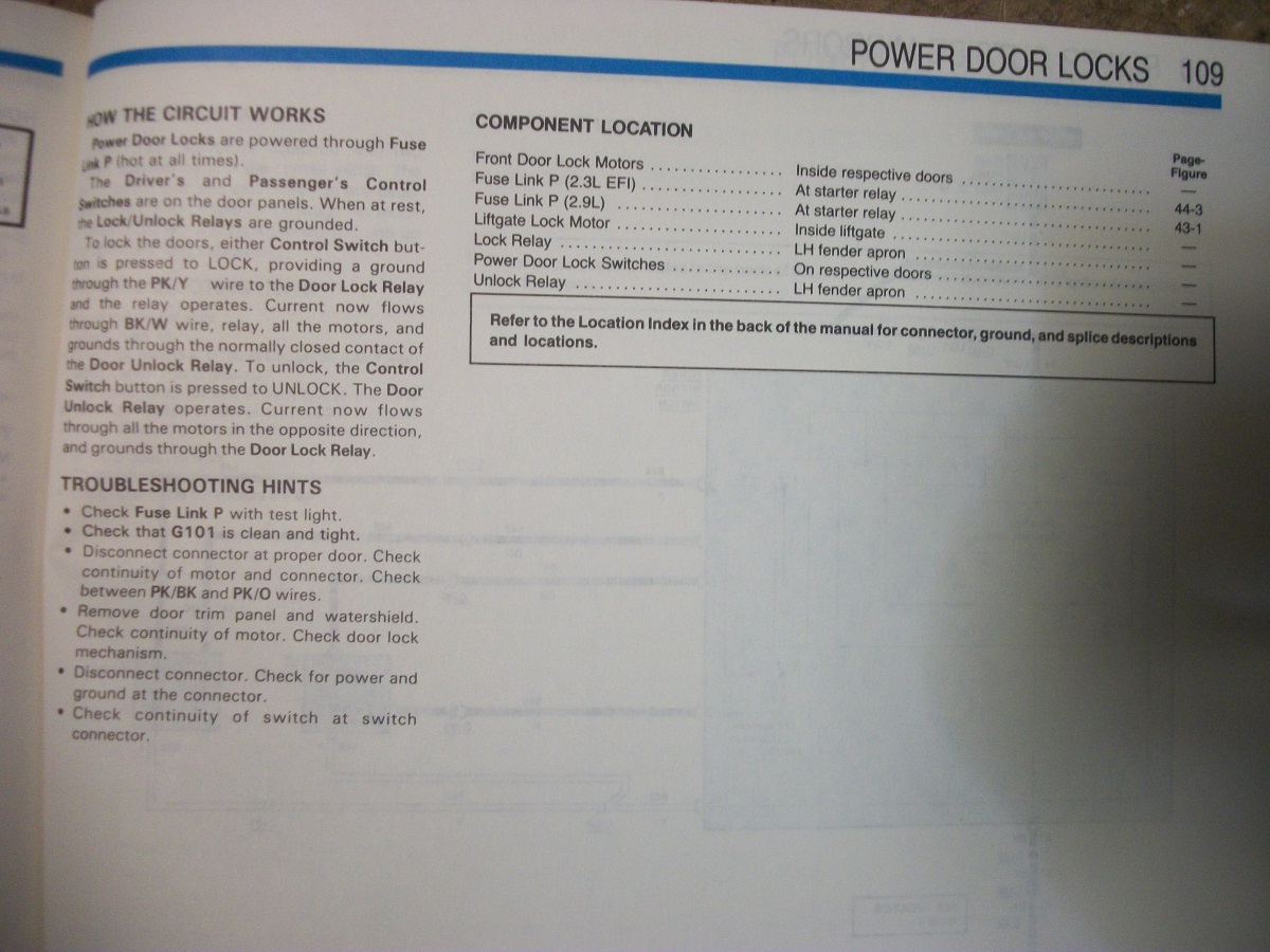

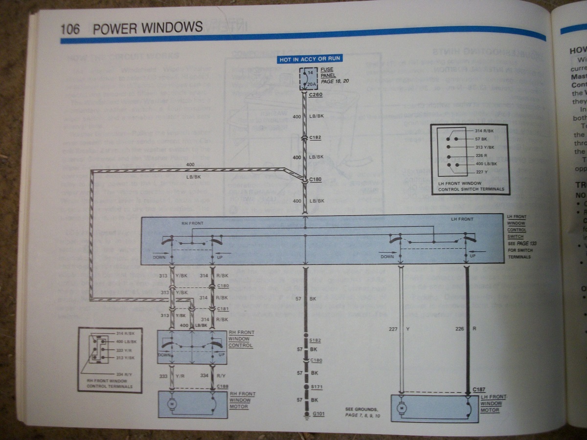

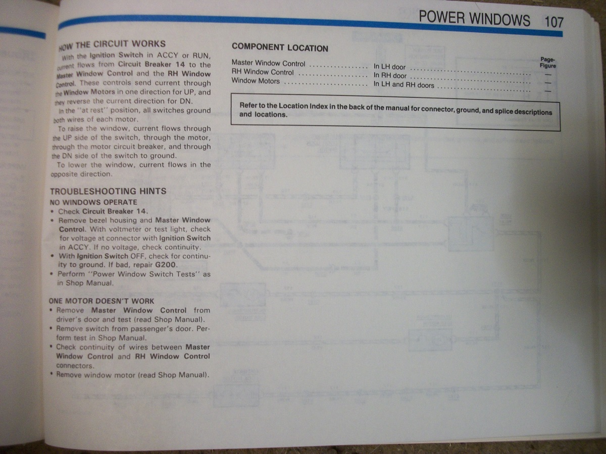

Schematics attached; look 'em over, and read the "how the circuit works"; it will help with your troubleshooting the systems. Then use the "troubleshooting tips" for your testing.

Ron, coincientally i was JUST looking through my ford shop manuals and i just found this same manual! I didnt even realize i had it. Thanks again for all of your help. I HATE electrical bc i dont understand it
Very cool! If you have the EVTM manual, you've got the keys to the kingdom in your hands. Trust in The Force, Luke- use the manual, and you'll be able to understand things, and get it resolved. If you get stuck, holler. Good luck!
Ron, how exactly do i check for continuity to ground? My meter only has ohms...i know it should read 0, but what wires am i checking? Specifically, "With ignition switch OFF, check for continuity to ground. If bad, repair G200"....?
In that case, you're testing that the ground wire terminal at the component in question has a 0 or very low number on the meter ohm scale, to the battery negative post (battery ground cable connected). In other words, you're testing that ground wire at say, a doorlock switch, has no or very little resistance in its path back to the battery negative post.
