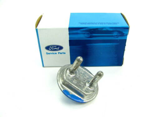

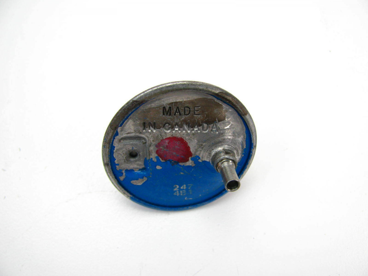

Hi, I am looking for a new air temp sensor (the one located on the air cleaner, which switch between cool and hot air intakes). I found online several sensors of that type but no one with the same "ID" numbers "123 8B1" or any other information about available aftermarket replacement. Any tip to help me? The sensor is causing a big vacuum leak. I already plug the vacuum tree and remove the hose but will love to replace the part and still with my "strict factory restoration" process...

The part I am looking for is not the IAT. This temp sensor manage vacuum to an actuator which switch between cool and hot air intake to the air cleaner. Here some pictures from Ebay of the same sensors but different codes, which make me think are indicators of open-close temperatures but cannot find the right part ( code 123 8B1 ) or even some info about those temps and codes so I can avoid a possible expensive mistake...

Oh, I have a few used ones of those laying around
The part I am looking for is not the IAT. This temp sensor manage vacuum to an actuator which switch between cool and hot air intake to the air cleaner. Here some pictures from Ebay of the same sensors but different codes, which make me think are indicators of open-close temperatures but cannot find the right part ( code 123 8B1 ) or even some info about those temps and codes so I can avoid a possible expensive mistake...View attachment 42037View attachment 42038
Those are for carbed engines, not fuel injected engines. We assumed you are working on your 1988 in your signature?

Yes my 88 is injection and yes has the temp sensor/actuator on the air cleaner. I am looking online but cannot find which is the part number... lot of Carter and other brands, no trustable information... So far I plug the vacuum tree and will concentrate my efforts in make the engine run smooth...
If in member tonight, I'll pull a part number off one of mine.
