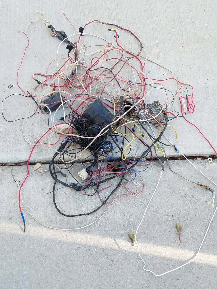

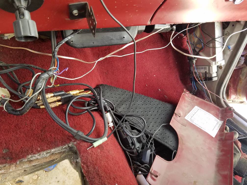

I thought the wiring situation in the engine bay would be an accurate representation of the wiring throughout the truck, and man was I wrong. I spent a good 5 or 6 hours today going through the wiring, mainly under the dash. There were remnants of an old security system, cb radio, poor stereo installation, and the auxiliary light situation was scary. But I got it all sorted out and decluttered! Tomorrow I'll go in and wire things up a bit nicer.
Sent from my SM-G935T using Tapatalk
Aint wiring fun?!!
It’ll be nice having all that wiring cleaned up in the future.

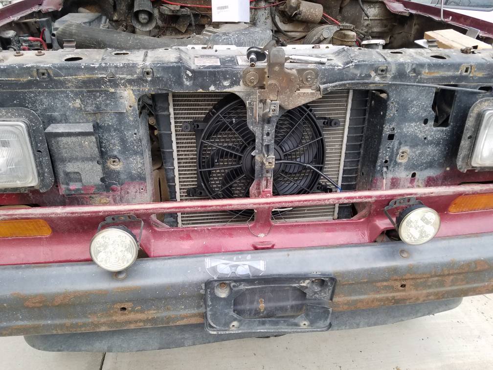

The wiring was kind of a pain. I turned on a podcast, grabbed a drink and dove in! It's definitely a good feeling having it all sorted out! We had a nice snowstorm in northern Utah this weekend, so I didn't get to wire up the fan or auxiliary lights yesterday, but it'll get done this week!

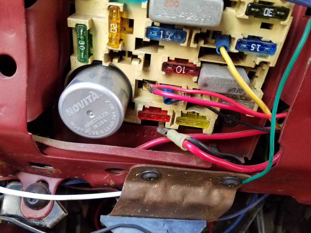

Here are some pictures of how everything turned out! Definitely not perfect, but much safer and much more organized than it was before! Let me know if the link doesn't work!
Good work on the wiring. One of my '88s has shit shoved into the fuse panel like that. Drives me nuts.
