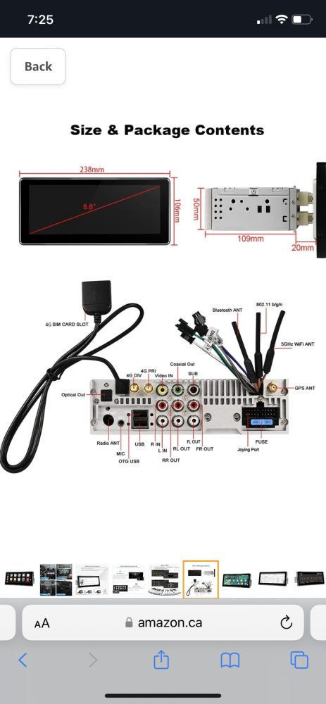

Also ordered a single din 10”
screen stereo. It’s huge and will take some serious getting used to, or may just
mount it on the hood and pretend that I'm at the drive-in.
Just kidding; the "big 10 inch" does look wild against a first gen dash.
Nice old sled, too.
@Awesom-O let us know how you like the radio. Thinking of putting something similar in my 91, curious to know how it works out, or if it's just too big/in the way
will do. I’ll probably go ahead and mount it for now. Can swap it out easy enough later. There is a smaller one on Amazon right now that I think would look far better from Joying, but man it is twice the price and still not a Pioneer or Alpine.

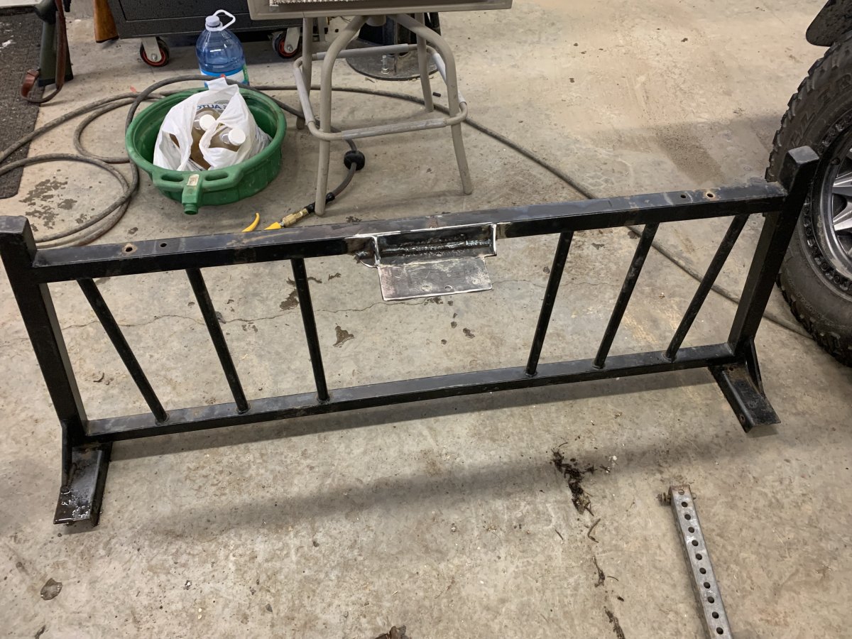

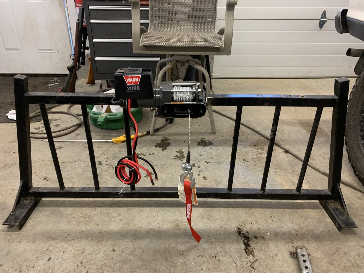

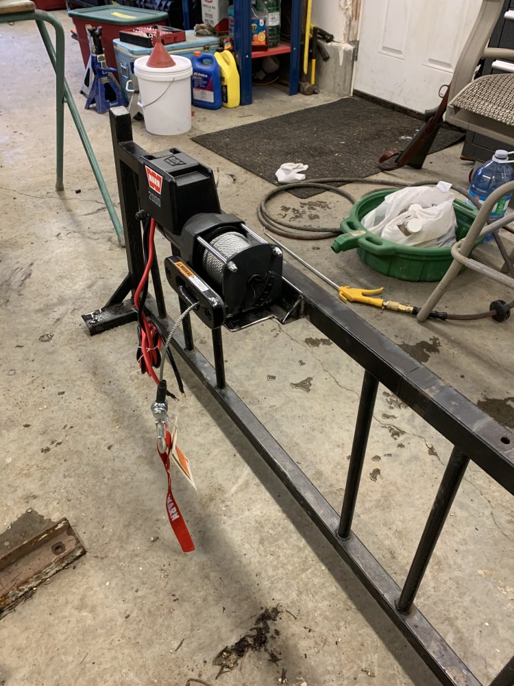

Not much again, but made a winch bracket for my headache rack with scrap steel I had laying around. Should help dragging a deer in the back when solo. Would have loved to have this when I loaded my moose last fall solo whole!
With that design I would expect it to be able to pull maybe 150 pounds before it starts folding back, I would strongly suggest some gussets that go back further, even if they're removeable sticks that go in the rear stake pockets to the top corners
I'm going to lengthen the bottom plate for sure and add a better gusset. But when you see the design of how I winch animals in it really will be adequate. That rack is all steel and will hold just fine like we did with my buddies truck. If I could figure out how to post a video I’d show you it in action.

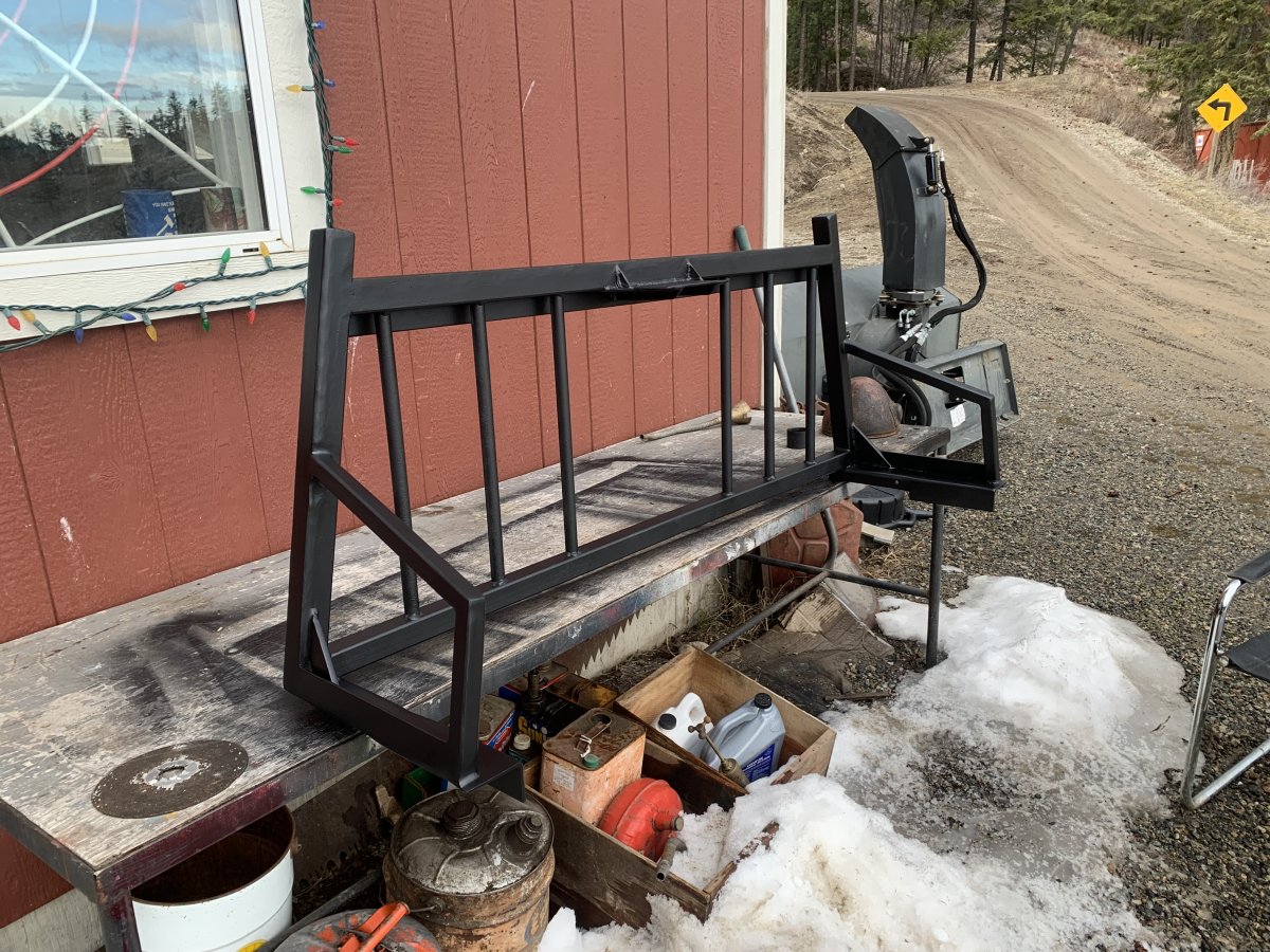

Finished the back rack. I still may add some tie down provisions for straps etc, and my plan is to fill in the side gusset areas with a CNC cut design of some kind to liven it up a bit. This thing is solid as I added some flat bar to the sides, back and some angle steel to the top bar. Lots of welding and grinding but this thing will aid in pulling a moose in now and not just a deer. I plan on welding square stock to the plates that go into the box stake holes and bolting in from there too. Not sure on the finish yet as it’s just in primer to keep flash rust off the bare metal. Powder coat or Raptor Liner will be the most likely.
