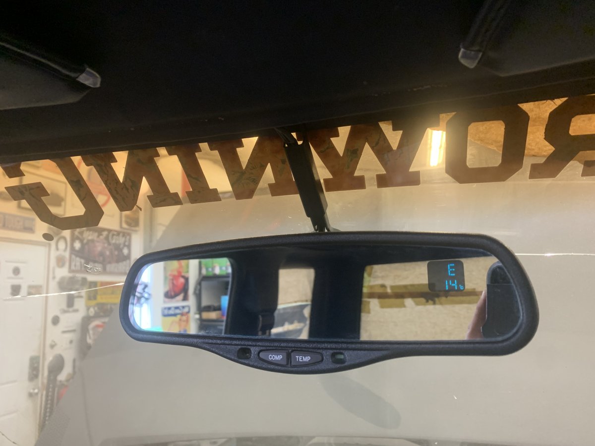

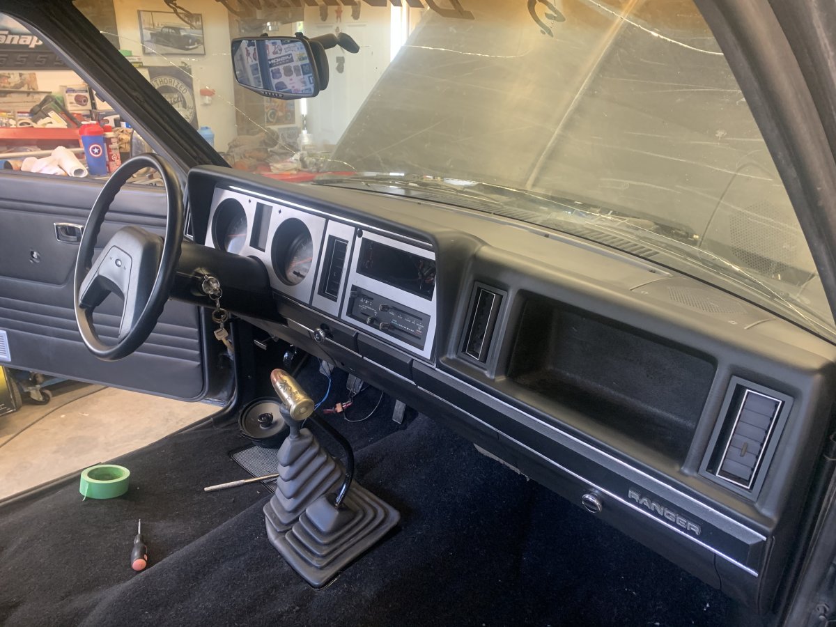

On the progress side of things, this is the first day I’ve had in the shop in weeks and I wired up a compass/temp rear view mirror. It’s a must for me, especially for hunting. Picked up the mirror and sensor at a local junk yard for $10. I’m happy with the upgrade even though it’s a, ahem,.. GM product. 😬

It looks good. Nice install!
That is cool Awesome-O I bought some closeout compass for boats and put one in the clock hole of a 1970 Olds 98 with the rocket 455. I couldn't keep that thing under 70 and it was all 55 speed limits! :D
Is it though? I think most auto manufacturers buy the rear view mirror from a third party. Aside from special inits integrated with onstar type features or the radio, I think most probably com off the same few assembly lines with different labels stamped on them.
Not a bad upgrade, but can't say I've ever found a compass necessary in the vehicle. I was a boy scount and learned to properly navigate by compass. Still rarely found the need to use one in the woods. I remember back in orienteering courses in summer camp or scouting trips I could typically complete the course quicker without a compass than others could with, usually breaking out the compass slowed me down. Ofcourse we don;t have the miles and miles of woodlands that other parts of the world have and being closer to the equator may make the sun a better navigational aid. .
Yeah the wheels are a little busier in real life than what the pics looked like before I ordered, but they still look good.
I don’t need the compass. My internal one has actually never let me down in my 48 years. (Touch wood). 😜.
I do love the temp sensor for hunting though. It was just a twofer. And yeah it’s all third party manufactured. Same tech is in Audi and Subaru apparently.

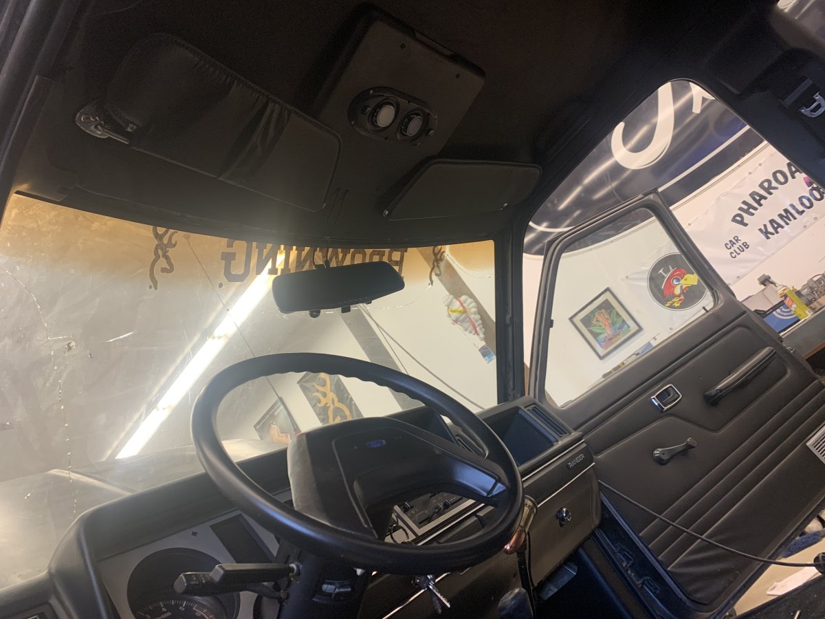

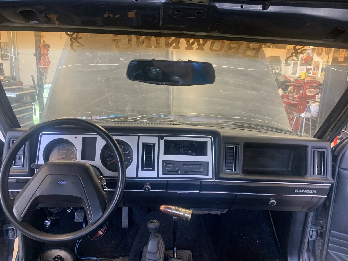

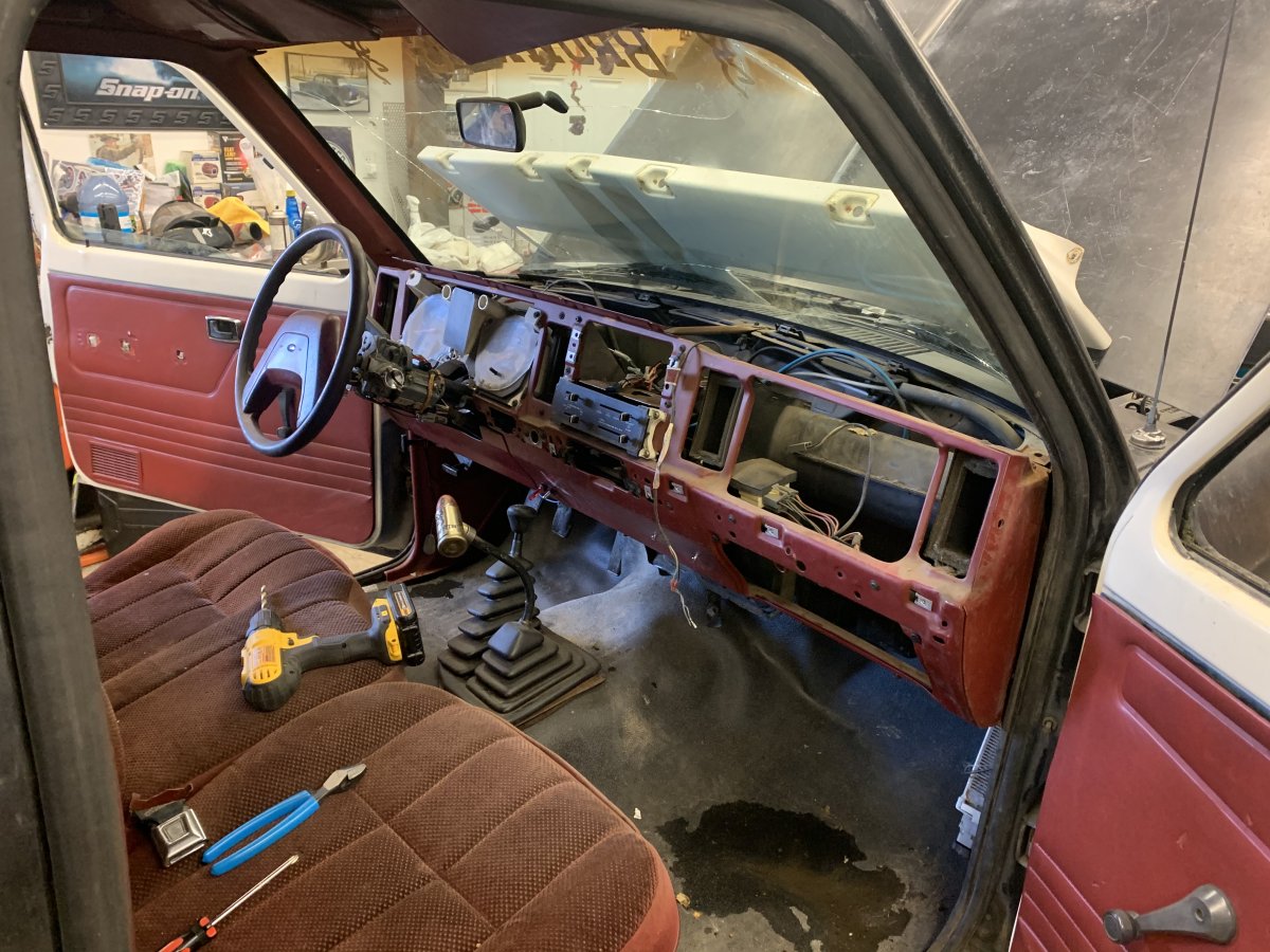

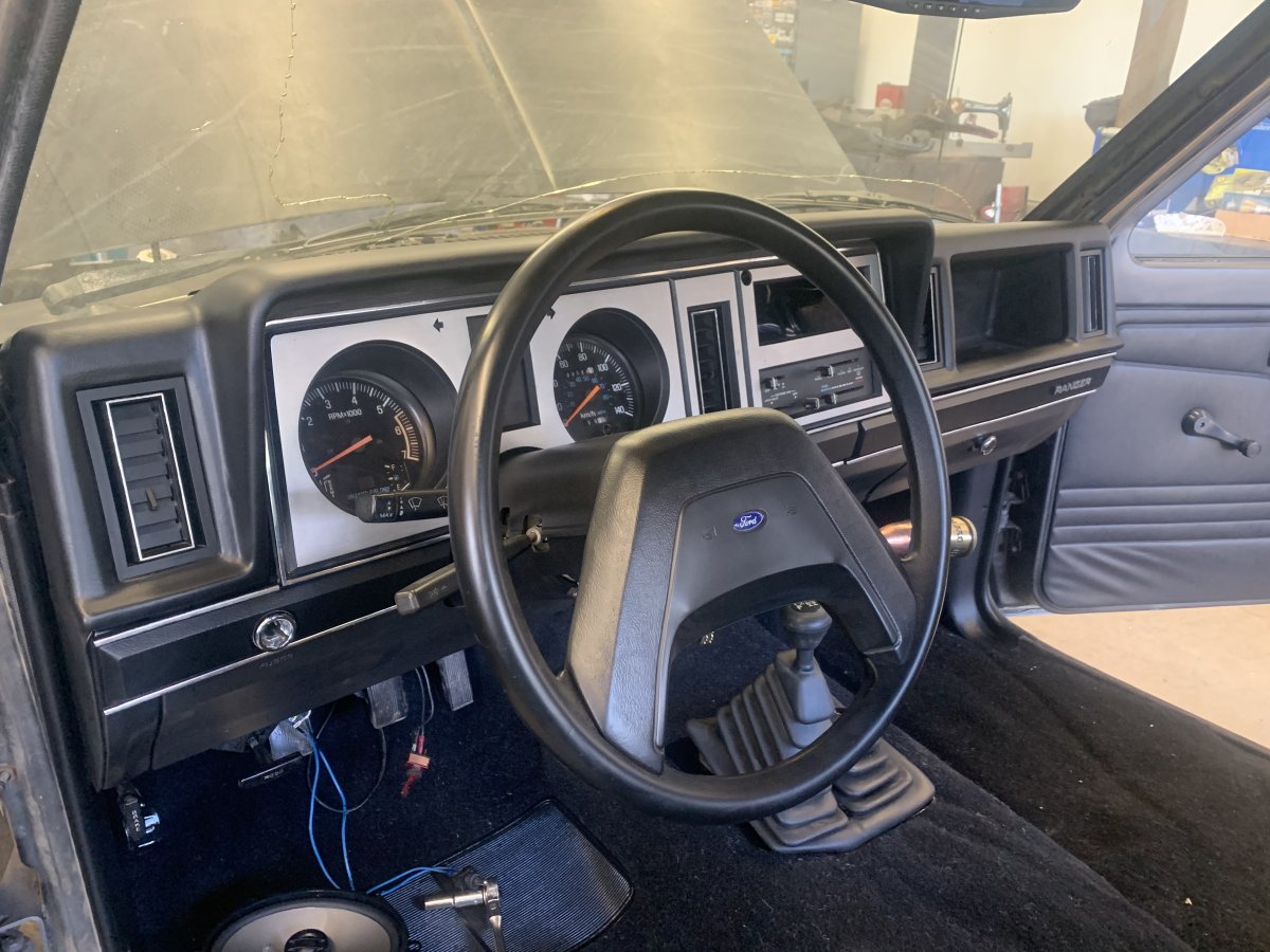

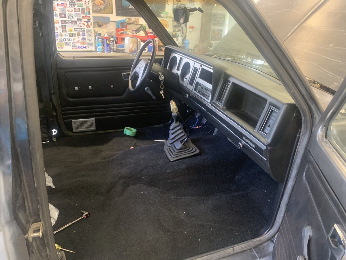

Well, finally got a full day to play in the shop today. Got 90% of the interior re-installed. Love how the black looks over that worn out red. Way prefer the black carpet to my old rubber mat too. Couple before and after pics.

I turned everything black. It was red before. Used SEM interior paint. Masked off all the dash pieces and painted them to keep the chrome. Touched up worn chrome areas. The carpet is new and ordered from LMC.

Headliner and overhead console turned out decent compared to the disintegrating foam that rained on your head. Hopefully get the rest buttoned up tomorrow and get the box off.View attachment 96877View attachment 96878View attachment 96879View attachment 96880View attachment 96881View attachment 96882
coming together nicely
It is forward progress, seems like some steps go quick and then you hit a slow spot. My luck any ways. Great job!!!

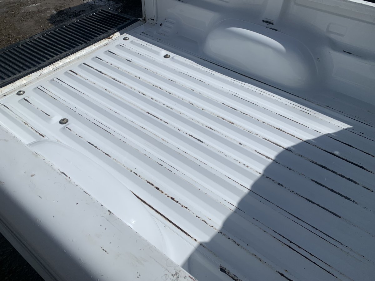

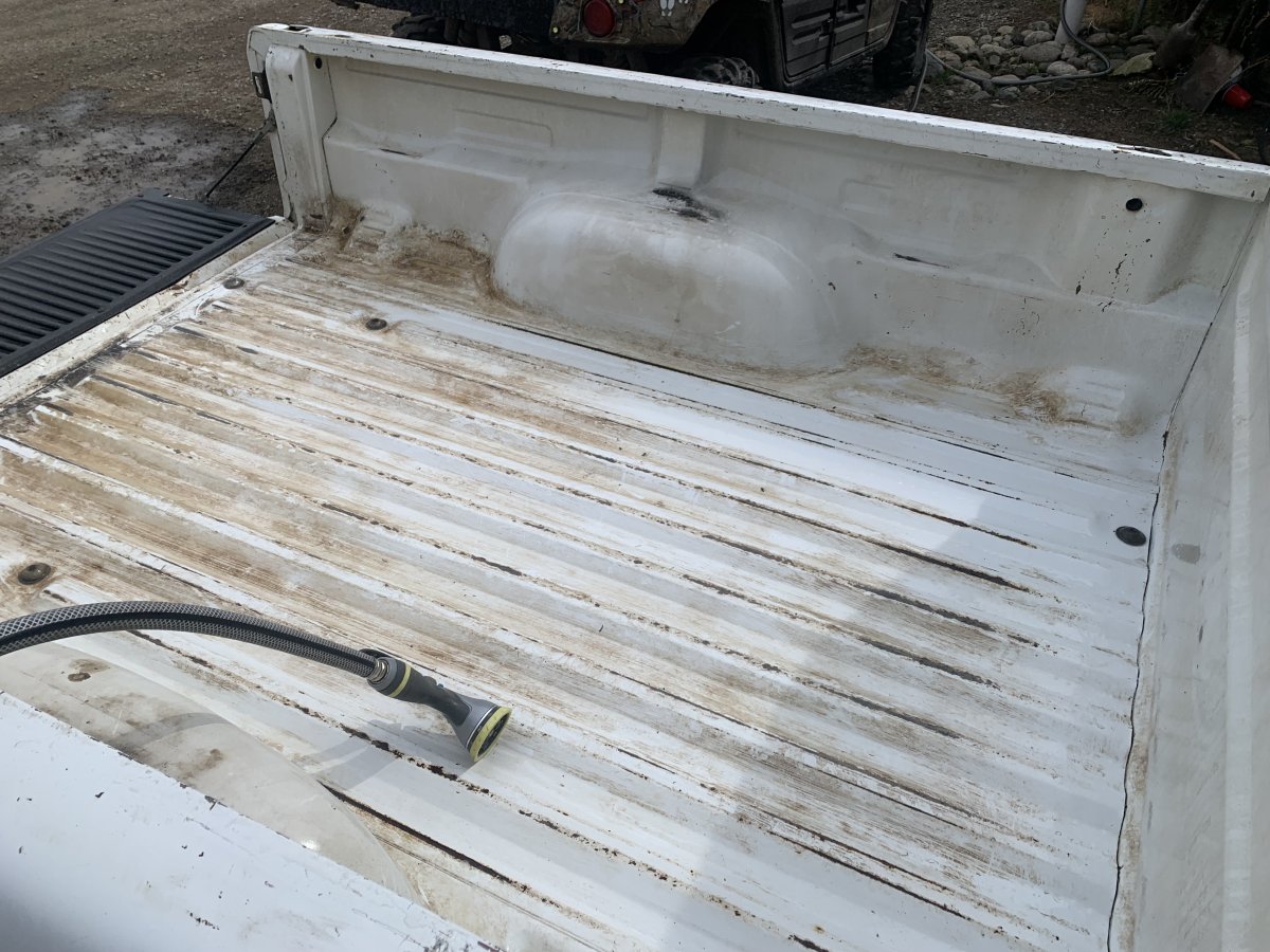

Well, I only got a couple hours to work on the Rangers today as I had to leave and help a friend build some walls. Got the canopy off and the plastic liner out. Then I cleaned the box out and attempted to remove the box bolts. As usual I’m going to have to weld nuts to the torx bolts as they are seized solid. A. Score and after of the grime. Most likely won’t get on this u tip next week as I’ll be on this job site u tip the weekend now.
Grime? What grime? That bed is CLEAN for down here in GA, much less Canada. I guess there's something to be said for having both a plastic liner and a cap.
