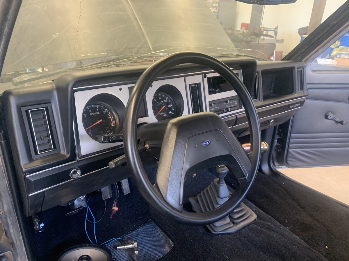

Well, finally got a full day to play in the shop today. Got 90% of the interior re-installed. Love how the black looks over that worn out red. Way prefer the black carpet to my old rubber mat too. Couple before and after pics.
Headliner and overhead console turned out decent compared to the disintegrating foam that rained on your head. Hopefully get the rest buttoned up tomorrow and get the box off.
Is that a chrome/aluminum dash trim? Did you swap out the whole dash?
The dash was originally the wood grain finish. I have an 88 parts truck that had the aluminum look which I prefer. I used a chrome pen to redo all the highlights including the Ranger emblem. The dash I restored using filler to remove the cracks. Then painted. I cleaned up the gauges and added green LEDs for lighting. I just need a headlight switch knob as neither of my trucks had them. I installed 4” JBL C2s in the dash, and 5x7 JBL C2s in the rear. Head unit, amp and sub still to come.

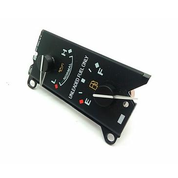

Took advantage of the box being off to diagnose my fuel gauge issue. Thanks to this website I was able to trouble shoot the issue. Ended up being a corroded power wire near the clip. Pulled the wire from the connector, got rid of the corroded section and soldered it back together.
fuel gauge is back in business!

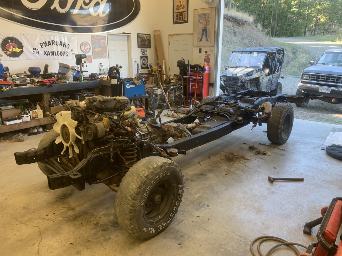

Then went and did something that I figured would save a bunch of time Friday. Took my 91 donor truck that had all the drivetrain mods I wanted (decent running 4.0, Dana 35, M5OD with manual TC, and the 8.8 rear and stripped it down to the frame. Going to do a cab swap instead of all the drivetrain components one by one. Dale and I had this done in a few hours. It’s filthy in this pic but has since been degreased and pressure washed, getting ready for new gaskets, Lift, bushings, and frame coating. I’ll use the article on this awesome website for adapting the original dash to work with the 4.0 harness.

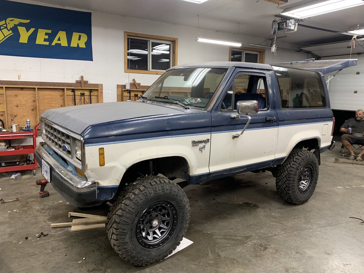

Then added a 4” Skyjacker lift to the Bronco II project. It was an awesome weekend of twisting wrenches with friends.
Damm Dude, that;s lookin great man :)
