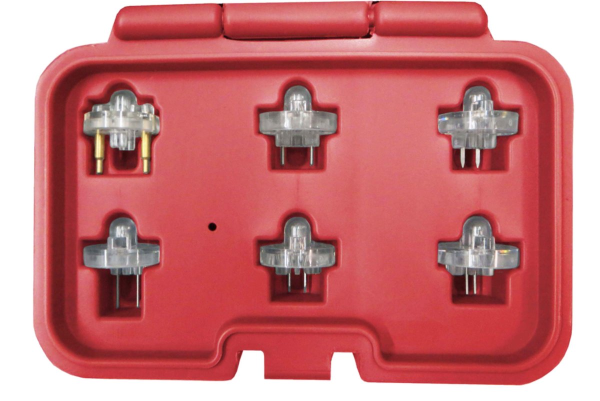

I don't remember there being anything more than just 2 wires to each injector... too lazy to go rip my engine apart for this, so looked at haynes and chilton, chilton shows a good closeup picture of a connector and it is 2 pins (they demonstrate using a 'noid' light to test - definitely 2 pin).... is this a transplanted engine from somewhere?
for that matter, I haven't seen more than 2 wires on any fuel injector.... the noid light test sets all have 2 pins:
1987 Ranger Not Running
(noid light test set for all engines from canadian tire parts store)
