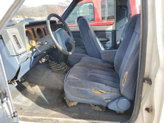

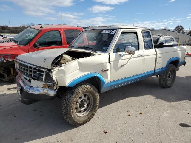

I just Bought a 1987 Ranger 4x4 that need to replace hood, driver fender, front bumper, once I have this Project up and Run I would like to have some Help getting ideas how to make it look better and have better performance on it.
will be my toy. What do you think ??

My '86 came to me with similar damage... I can guarantee you will have frame repairs to make. I would look for a donor truck, in addition to the parts you mentioned, you will more than likely need the entire front clip minus the passenger fender. Maybe a radiator, fan shroud, who knows what else got damaged.
Frame is the hardest part to fix but it's doable. Hood hinges too, once those get twisted like that it's very difficult to get them perfectly straight.
Fortunately in Texas you should have access to some nice clean body panels... keep us posted on your progress!

Shran is correct - you have some frame damage. Look how the driver's side front tire is pushed back. Before you pour money into sheetmetal parts get the structural problems addressed.
