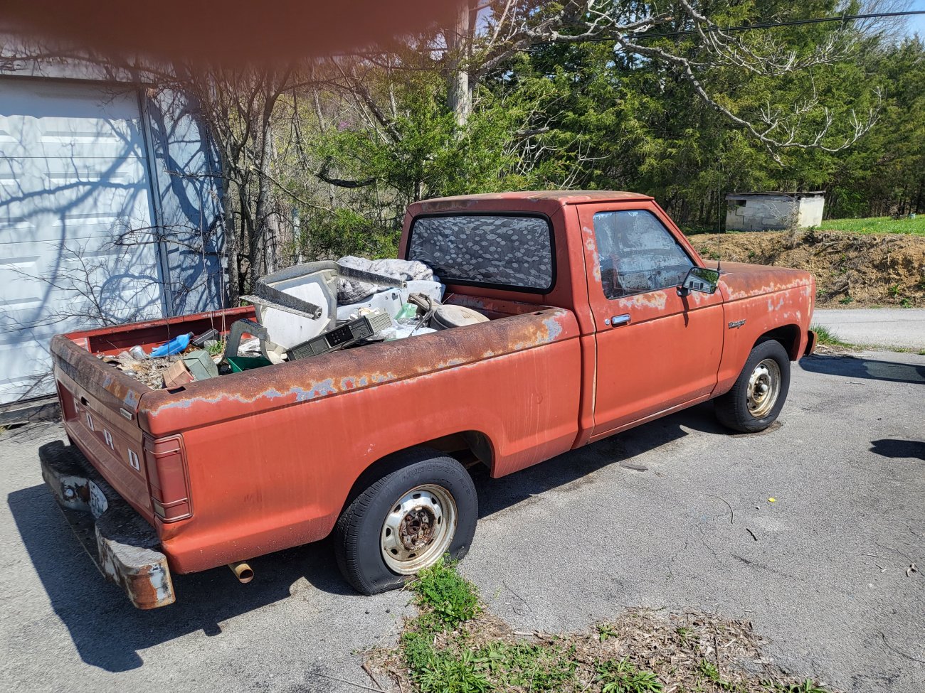

New guy here with a new to me 86 Ford Ranger. I dont know much about them to be honest, but I remember back when this body style was new I had some friends who owned them. I had an 87 S-10 back in those days; lowered with custom paint and aftermarket wheels.... It was at the beginning of the mini-trucking craze. Anyway, its not much but it was free, so no complaints. Heres the story;
My father-in-law owned it way back in the late 90s into early 2000s. Drove it to work foryears. Its just a 5-speed 2.0 short bed, standard cab Ranger. It was last registered in 2006, and sat as a dumpster until I pulled it out. He gave it to me because it was just rotting into the ground. Im just going to use it as a daily. I have too many other projects right now.

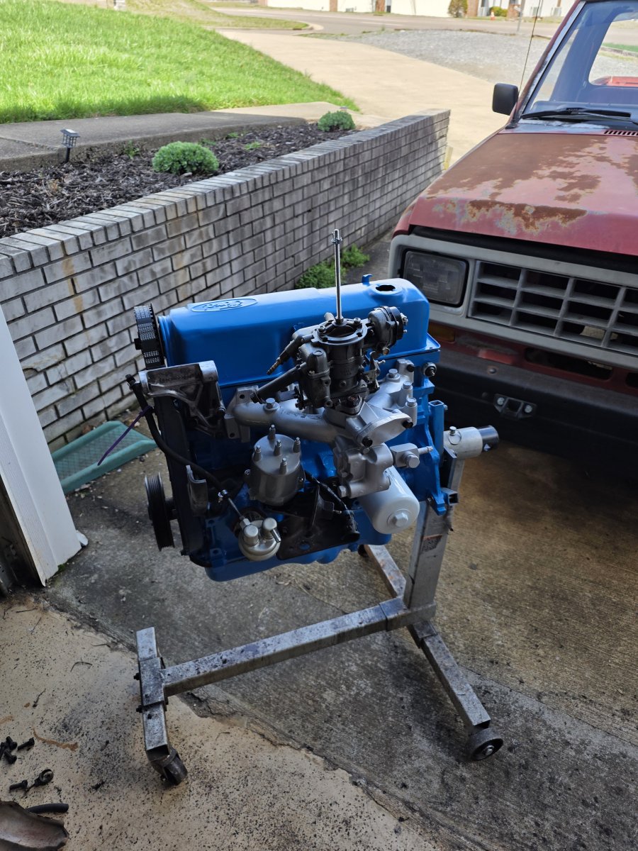

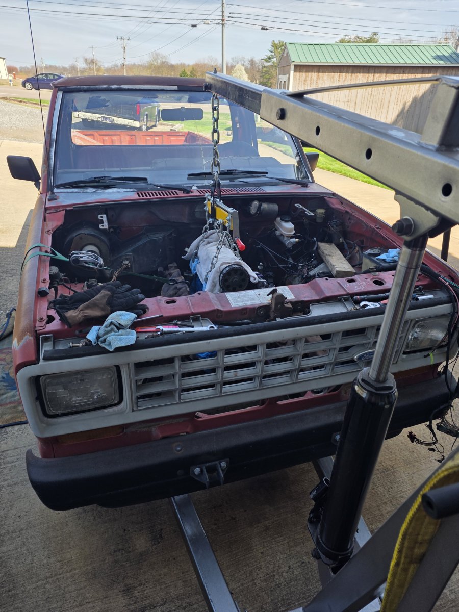

Im about $2500 in, with new tires and brakes and a bunch of other parts. I thought it had a bad head gasket, along with bad front and rear seals. So, I pulled the engine, and resealed it all. The head gasket was good, but the rest of them were not. The clutch throw-out bearing wouldnt return very good either, so that also got replaced.

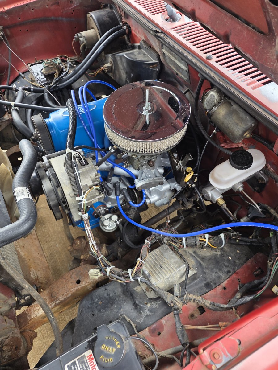

My latest trouble is wiring. Im afraid my father-in-law was wiring it before he parked it. The wiring is a disaster. The truck runs fine now, after all the work, but the wiring is still in question. There seems to be a lot of extra connectors under the hood. Its almost as if this was a fuel injected truck but it was converted to carb. Either way, itll be fine. The future will have me re-wiring the whole truck, I just dont know when. It needs to do DD duty for awhile now, so I can get the other projects on the road.
Sorry the pictures are out of order. Ill get better at posting them. The bottom picture is after I have been messing with the wiring and after I put the engine back in. The alternator wiring had burned up, like literally melted out of the truck. The "GEN" light was on too. I re-wired it like it was, but it melted again. I looked for wiring schematics, but nothing matched the colors in the truck, so I ended up wiring it to match an 86-ish bronco schematic I found online. Those colors matched and it seems to be working for now. Ill have to test it some more tomorrow.

The 2.0L was somewhat of an odd duck as it was originally a feedback carburetor with an O2 sensor, air pump and all sorts of emissions stuff, looks like you have a more simple setup, it would basically have all the wiring for a fuel injected engine as that was the second year fuel injection was offered on the Ranger.

One bit of advice; go on eBay, automotive / literature and look for a "1986 Ranger EVTM" (Electrical and Vacuum Troubleshooting Manual). That is the Ford factory wiring manual for your truck, and it will pay for itself in helping you sort out the truck's wiring. They're usually very reasonable; sometimes you'll need to watch and wait, but they do come up often and vary a lot in asking price.
