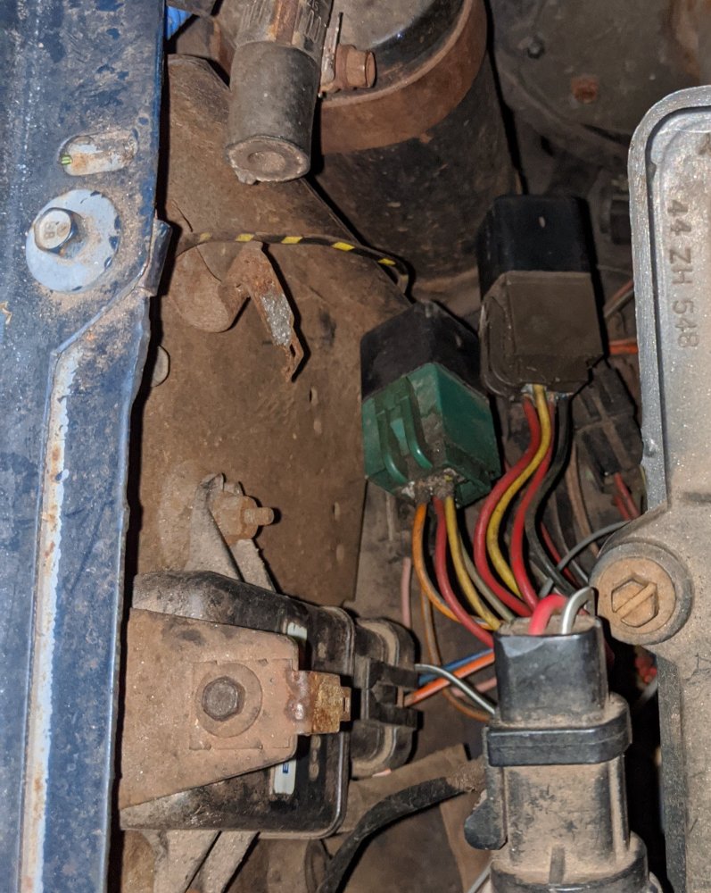

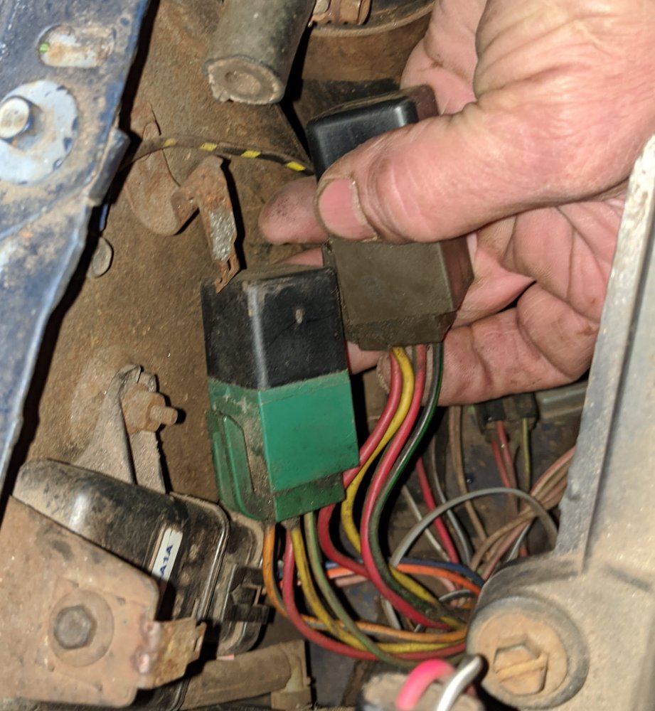

Hey all. First post - glad you-all are here. Attempting to go resulted in no start. I cannot hear the usual whine (from a general behind-and-below location) that happens for about three seconds when I turn the key to the accessory position. When I turn the key all the way to start, the engine just turns over but shows not even a hint of starting. I checked the inertia switch (well, I found it and depressed the white button - no change). My understanding is that the whine is both the lift pump in the fuel tank AND the high pressure pump on the frame rail under the driver,

spinning. The fact that I hear absolutely nothing may point to the relay but, I am wanting a little confirmation I'm on the correct track. Pictured are the relays the inside of the passenger-side front fender. They don't have any markings on them and the grooves that the mounting tangs slipped into have broken off (perhaps part of the problem). Does anyone know if the fuel relay is the green one or the brown one pictured here? Am I deducing correctly? How should I go about testing to see if it's the relay?

Green is go = fuel relay.

Yes, you need to change the base on both relays, green and brown, relays are probably fine, but look at their tabs
Green is fuel pump relay
Brown is EEC relay, it powers EEC/computer and fuel pump relay
Any auto parts store should sell these bases with wires attached so you can cut and splice them in
They are standard 12v automotive relays
Label them for future reference if they don't come in green and brown
It was the green fuel pump relay. Yes, I noted the need to change the bases - pretty bad. We're in for a snow so, job 1 was just to get running. I wrapped a pretty good seal of electrical tape around the ends of the questionable wires going into the base of the relay, exchanged the old relay for the new, held my breath and turned the key to the accessory position. I didn't hear any whine and my heart sank. Well, time to give it a try. In doing so, the truck started! In subsequent turnings of the key to the accessory position, I _did_ hear the whine of the pumps so, perhaps some priming needs to happen to make them more audible. I'm going to change out those bases the next nice day - if the truck persists that long. Thanks guys!

The brown relay controls the green relay.
I'm not an electrician, but I assume that the brown turns on power for the computer, and also controls the fuel pump (green) relay. Perhaps one relay wasn't good enough for the amps running everything.
