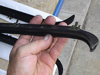

These have held up really well in the 14 years they've been on my truck, and seemed comparable to OEM quality. I did find another pic showing an end and clip closer, in case it helps.

That part number didn't show under RockAuto, but I did a Google search and found it on LMC Truck's website!
(No idea why I couldn't find it searcing their site, but I just ordered the kit since your truck seems to match what I have.)

@RobbieD - You're a life saver!
Yesterday I installed those same windows sweeps and they fit perfectly.
Lesson learned?
The first set I ordered from RockAuto may have fit as well. I assumed the short rise belonged at the front-end of the door. (Having broken out the original, I had nothing to compare with)
Turns out it goes along the back of the door (90 degree angle, not the 45 degree angle) :rolleyes:
Your reference gave me the guidance I needed, and saved me a few dollars as well!
