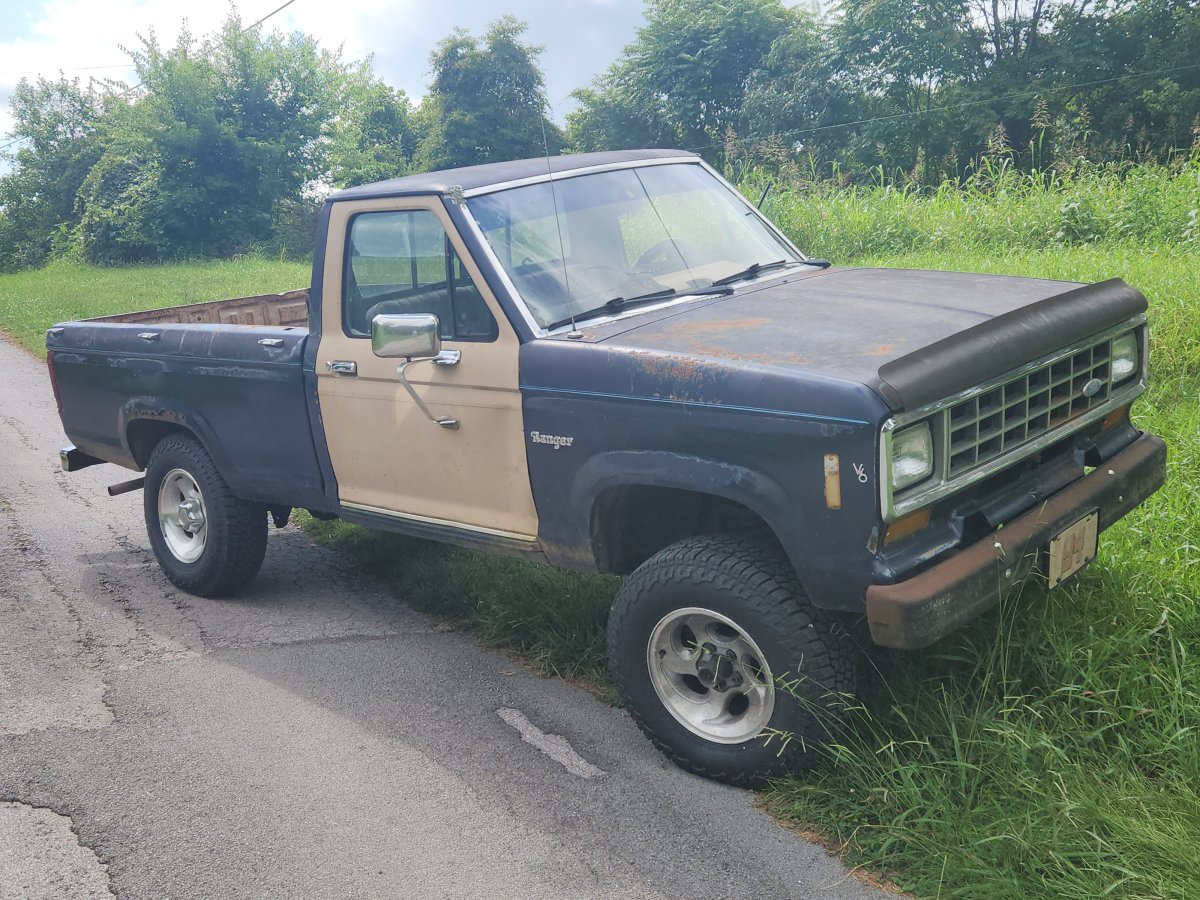

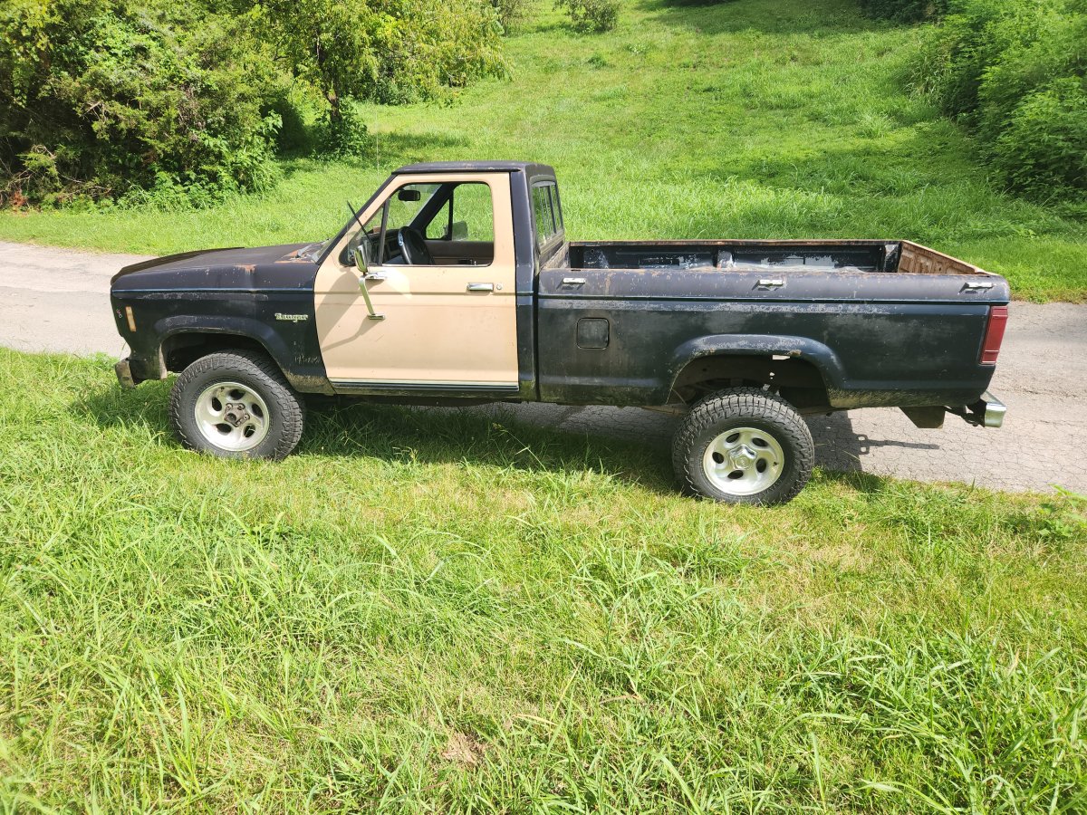

Finally took some pictures. The only thing I have done is put new tires on it. A previous owner swapped out the doors and tailgate from an '84. I just bought it also and will probably switch the doors back. Just need to make a spot to but the '84.
