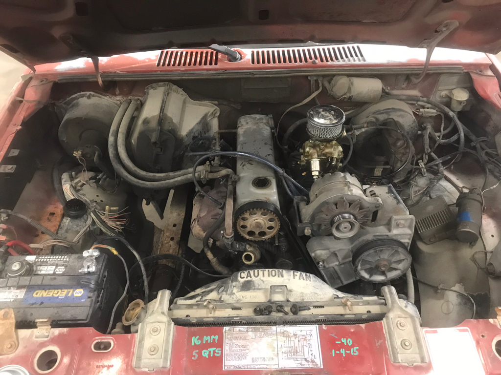

So i just got a bronco 2, somewhere along the line someone swapped in a ranger 2.0 motor in. It ran pretty good for about the first week i had it and then i was beating on it having some fun and it started running terribly. It back fires through the intake. The first thing i suspected was it jumped time. I popped the cover off and sure rnough the belt is worn pretty bad and ancient looking. Im almost positive it jumped time. The problem im having is i cant find where im supposed to line up the pulleys. It is different than my 97 2.3. Ive spent probably about 5 hours googling and searching through forums but i cant seem to find anything on it. Have any of you guys done timing belts on your 2.0s?

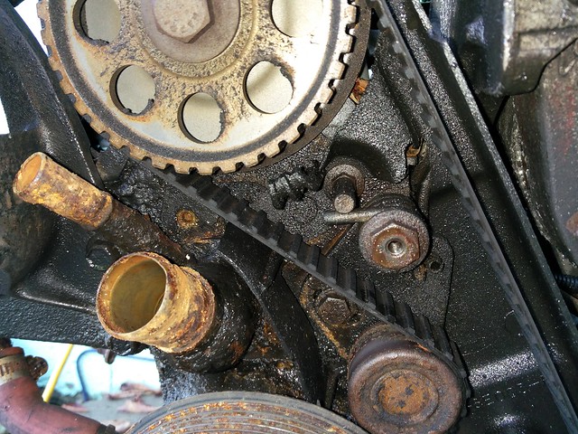

If you cannot fine the pointer for the cam sprocket triangle to match up to, it may be someone has removed it. It should be near the belt cover bolt at about the 4 o'clock position.

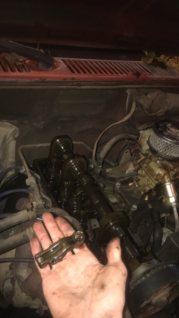

The cam locator is probably around the 4 or 5 oclock area. It is a little plastic 3 prong deal. The crank and the dizzy pulley dont have the locators. I tried doing it manually but ill try it again with some more knowledge ive acquired lol. At this point im a little worried i have a bent valve or something. Ig if i do thatll be a good reason for me to pull the head and shave and do some port work.
Maybe this will help, since I was just looking at my 85 2.0 yesterday. It's more like 5:30 on a clock face.
I had found that from the centerline of the timing mark on the gear, to the metal post that the timing belt tensioner spring pushes on, was just shy of 1.5" when the pointer is aligned correctly. That is a very inexact way of doing it, but it hopefully gives you a reference point where you can be within a tooth or two, and get it running.
Another way to do it is to point the cam timing mark at the centerline of the cam and aux shaft bolt heads (so like...a straight line between them, and point the timing mark at that line). That should get you to the right place.

Just to put it out there, these things are non interference so you can crank to your hearts content with the cam in any orientation spinning or not and it won't make a lick of difference unless it has fancy pistons...
Well this explains why i was still having trouble manually aligning the pulleys lol
Ig its just time to pull the head do some portwork and put it together new again lol.
