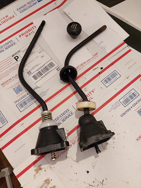

It would be interesting to know what actually broke in the shifter.
To me it looks like the shifter ball (white plastic) split and is no longer a press fit on the knurled part of the shifter... I vaguely remember talk from WAY back in the day that the ball from a Craftsman screwdriver fit the shifter decent on one of the transmissions...

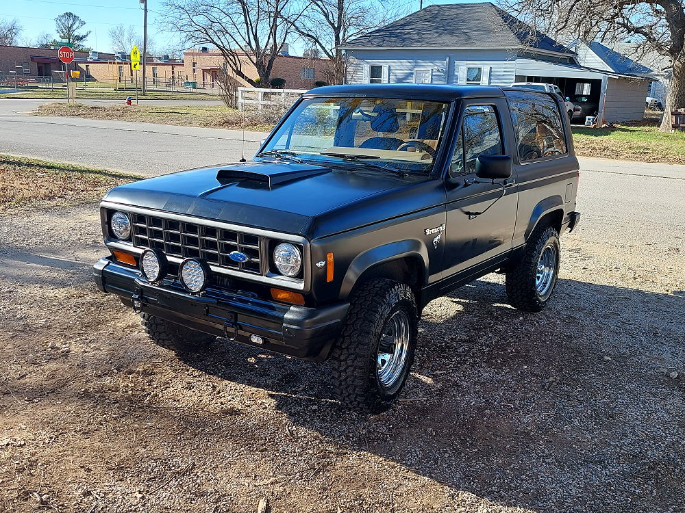

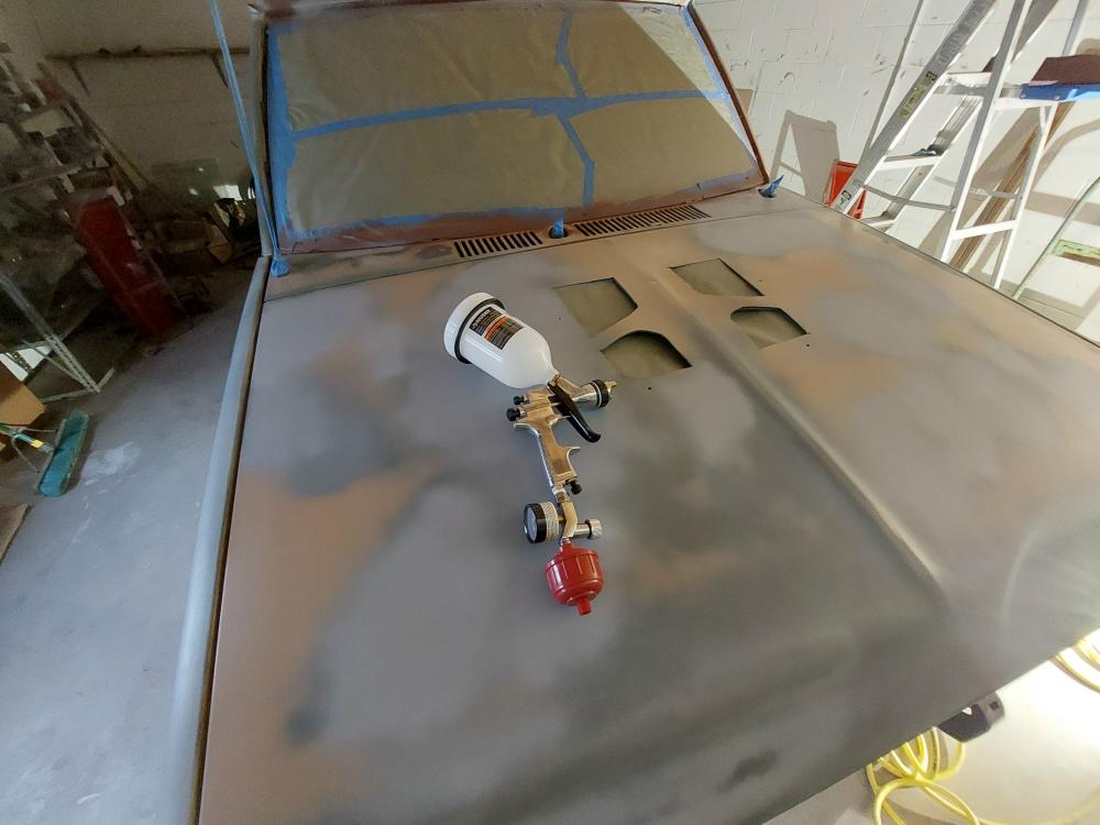

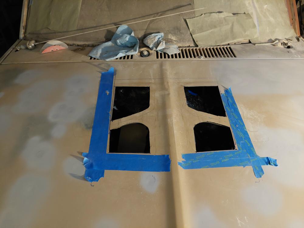

I cut a hole in the hood for the hood scoop but cut around the supporting structure under the hood. It's a 2.8L V6 with an open element filter, not a V8. It's not a horsepower build, but I couldn't see adding the scoop and not making it work.

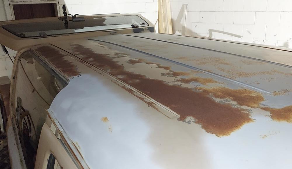

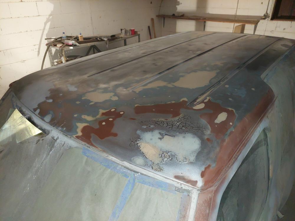

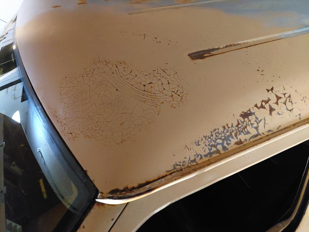

The roof of this thing had quite a bit of surface rust and this round area that has a cracked.
When I sanded down that area where all of the cracks were, there were actually lines left in the metal where the cracks were. I've seen paint crack from having too much filler under it, but I've never seen anything crack like this.
I actually painted this with Rust-Oleum Satin Black oil-based paint. I thinned it with mineral spirits, so it's (4) parts paint and (3) parts mineral spirits, and then sprayed it with a Husky gravity feed paint gun from Home Depot using my Husky air compressor.
I'm actually surprised at how well it turned out. I've always painted vehicles with automotive paint. I've never painted a vehicle with Rust-Oleum before, but I know that people have, and I was doing a low-buck paint job, so I figured I'd give it a try.
If you look closely, you can see that I created new XLS decals and stripes out of gloss black vinyl and put down the sides, there's also (2) gloss black vinyl racing stripes that run up to the hood scoop.

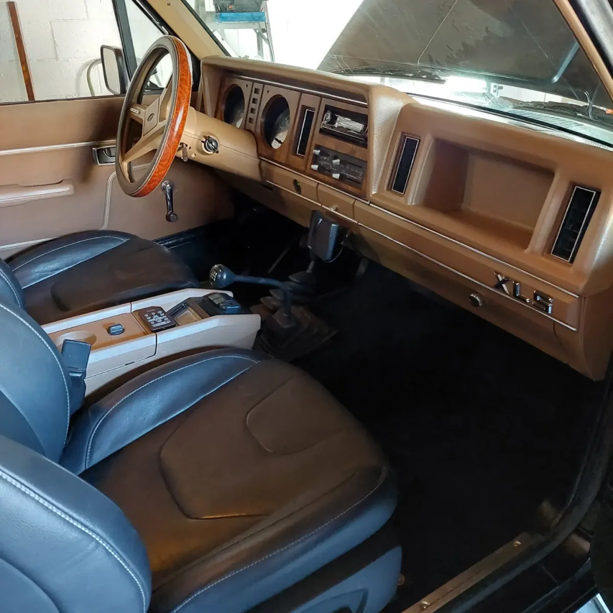

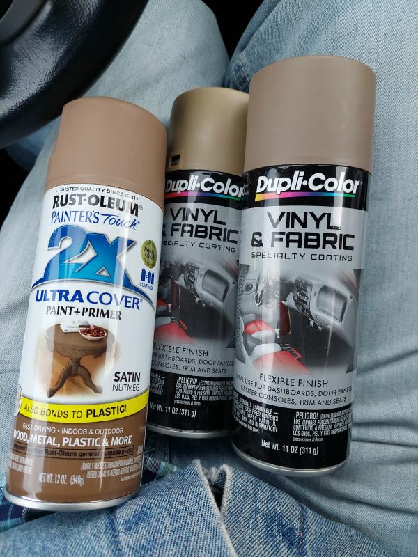

The interior got a Rust-Oleum makeover as well. Funny because I wasn't purposely looking to do an all Rust-Oleum build, but when I was sampling paints that I could use on plastics, I liked the Rust-Oleum 'Nutmeg' the most and it's really close to the same color of the interior.

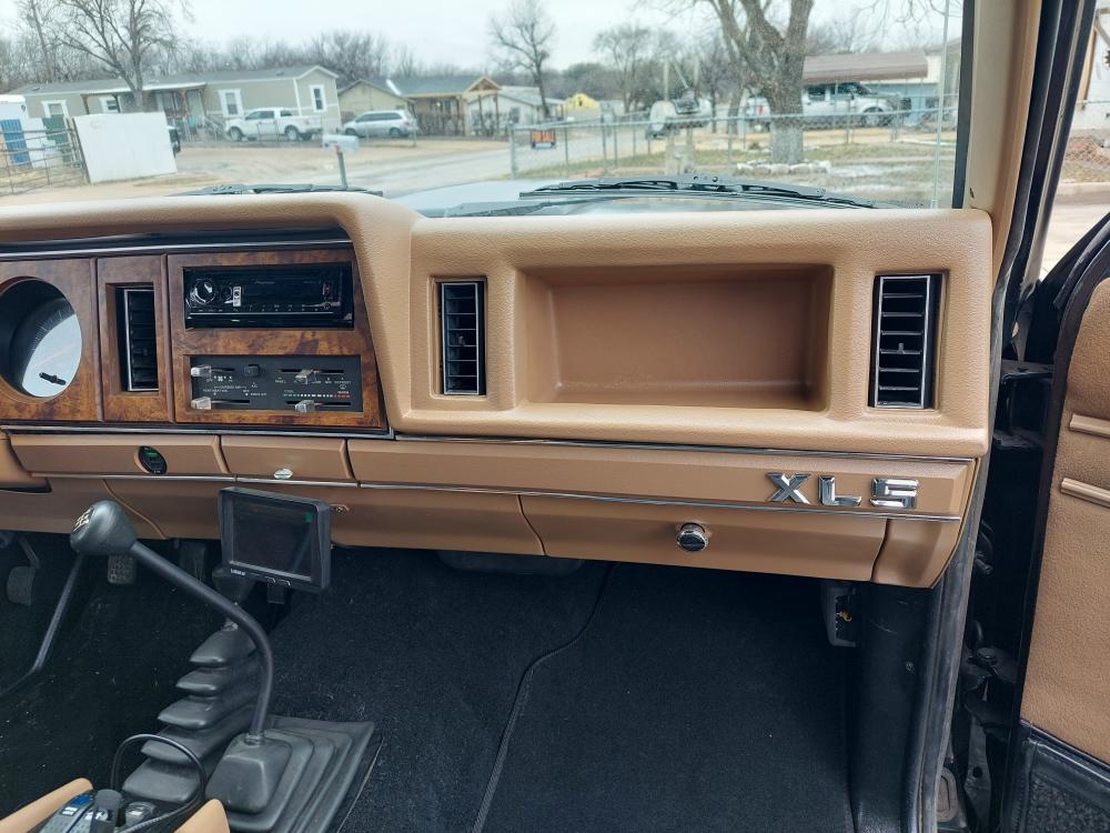

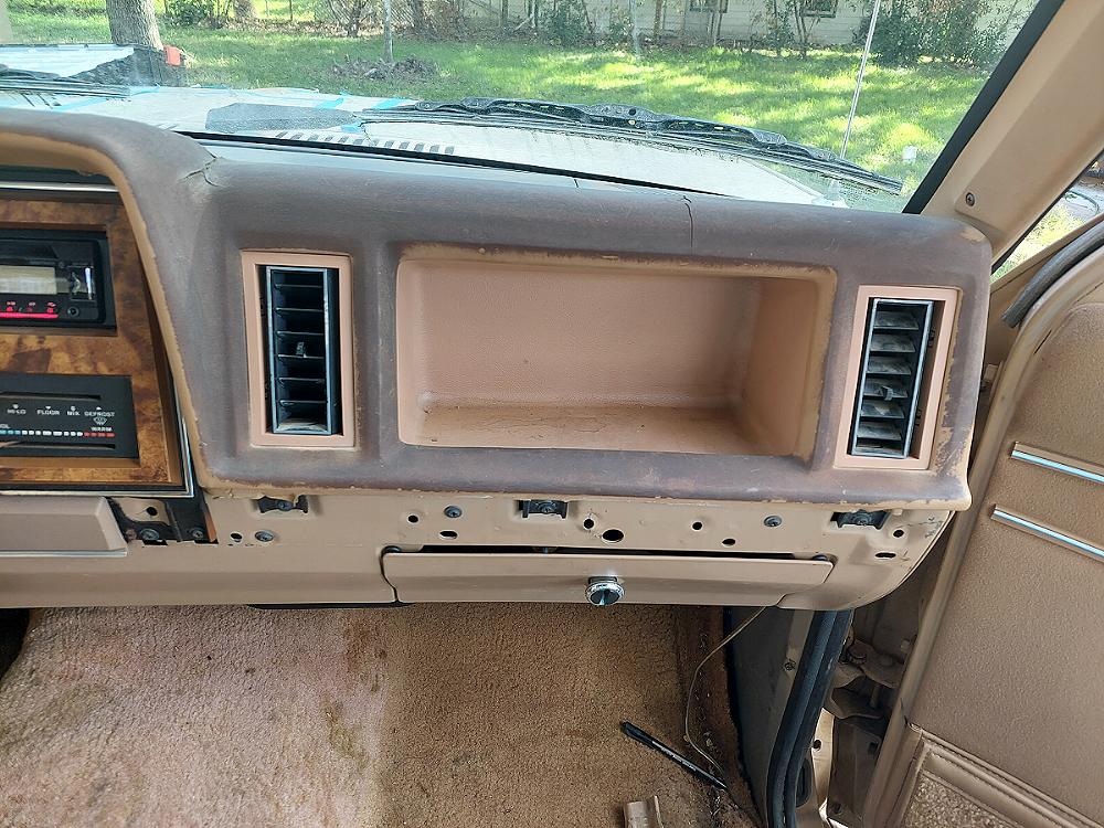

The dash was in bad shape. I added a Coverlay dash cover and then repainted everything. It also got a new Pioneer stereo, dash speakers, and I replaced the cigarette jack with a dual 3.0 USB Charging Port. The monitor is for a backup camera.
1984 Bronco II XLS side project

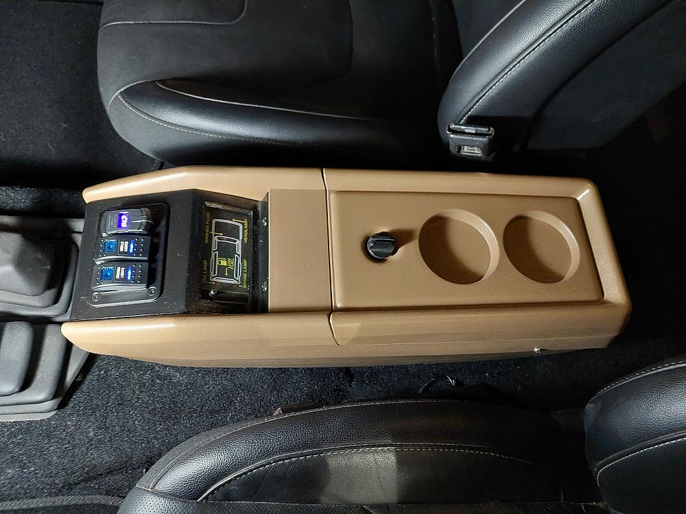

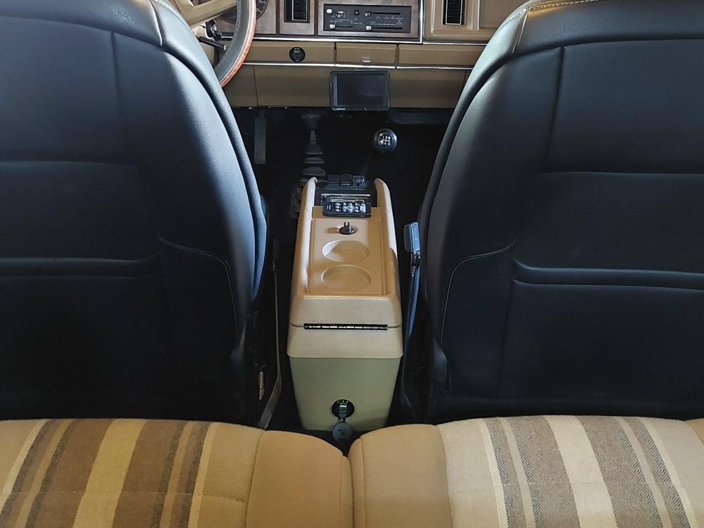

The center console was repainted, and I added switches for the driving lights and off-road lights along with a dual USB charging point that displays the vehicles voltage. The back of the console received a USB charging port for the backseat passengers. I painted this part of the console black so it would all blend together and look intentional.

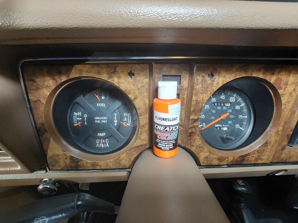

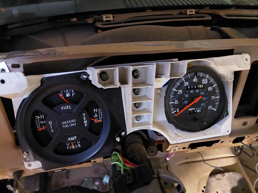

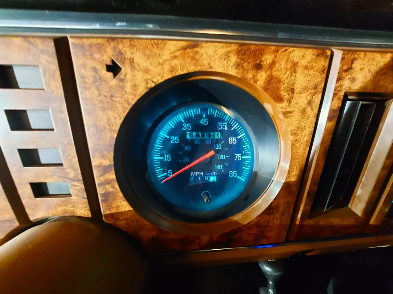

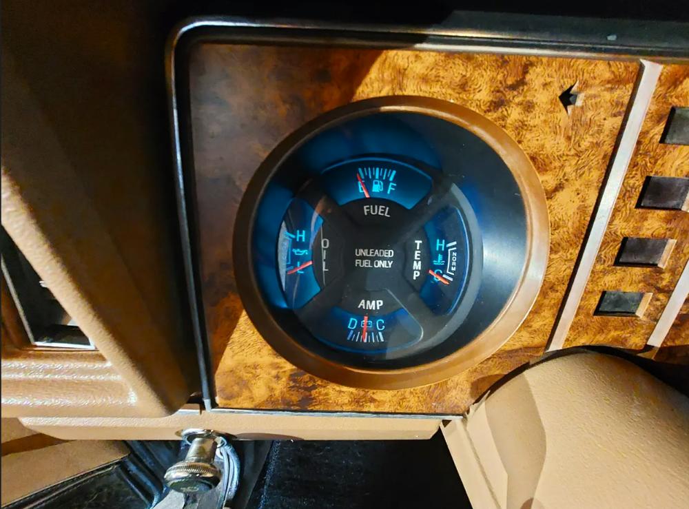

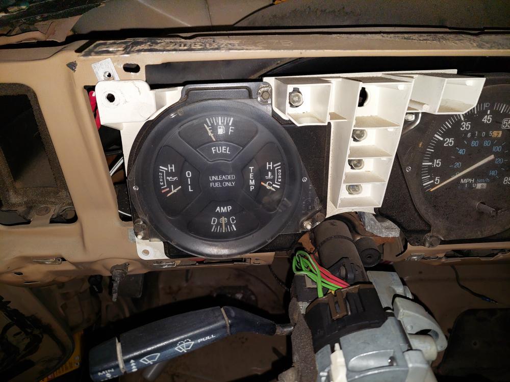

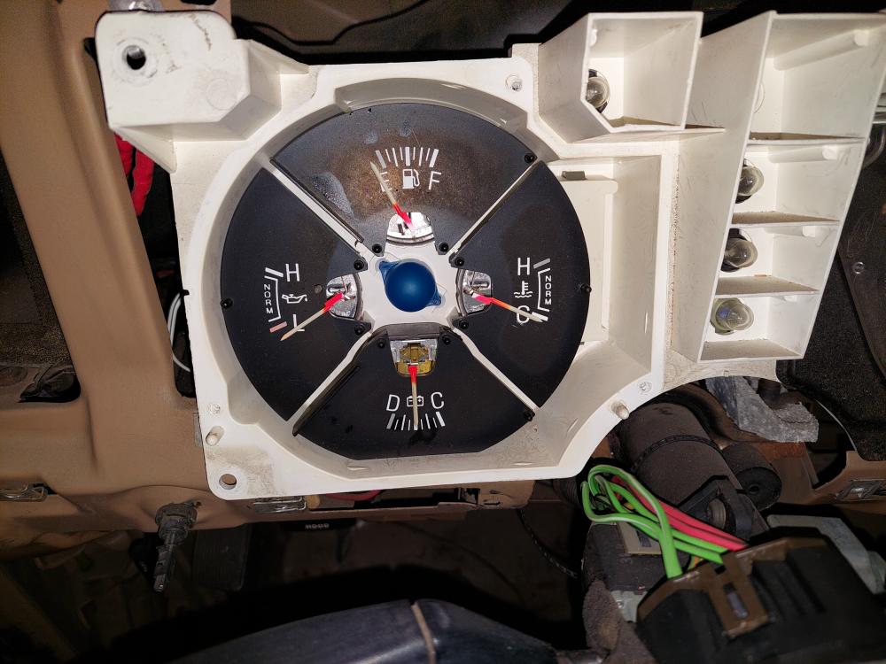

The needles on the gauges were all sun bleached, so I painted those as well. In case you didn't know it, the dash gauges are supposed to light up blue. There's a blue filter over the bulb. The problem is that the old incandescent light bulbs gave off a yellow hue which made the light look green. I replaced the dash bulbs with clear (white) LED bulbs, so now the gauge lights up blue the way it was intended.

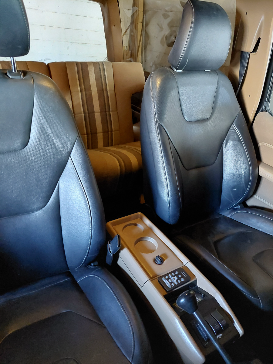

The leather power bucket seats came from a Ford Fusion, and I actually found these on Facebook Marketplace for $60!! No, they're not a bolt in swap. The rear of the seat bracket bolts into new holes in the floor, but the floor drops mown in the front, so I used 1.5" square tubing under the front mounting holes and then bolted them through new holes with a large washer on the bottom (under the Bronco II) to spread the force through the floor. I added a small fuse block to the vehicle to power the additional lights I added and for these seats.

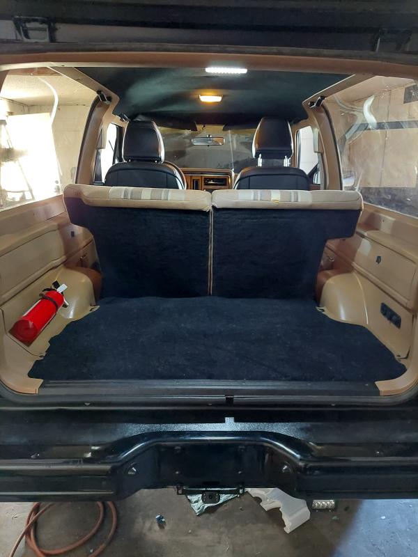

I added a black carpet kit which I think helps make the bucket seats blend in and then used black fabric paint on the back of the rear seats to match. There's also a fire extinguisher in the back, a tow strap and shackle in the storage compartment, and I added a 12V & USB charging station.

I did replace the shifter with the one I linked to earlier.

This thing also got a pair of Rough Country 1.5" lift coils, rear add-a-leafs, new shocks, Mile Marker manual locking hubs, Crager Nomad II chrome wheels, and 235/75/15 (28.9″ x 9.3″ x 15″) Americus Rugged M/T tires. I didn't want to lift it since it wasn't mine, and I didn't want to remove or damage the XLS trim around the fenders, so I added the 1.5" lift to give it a little better stance and stuck to the 235's.

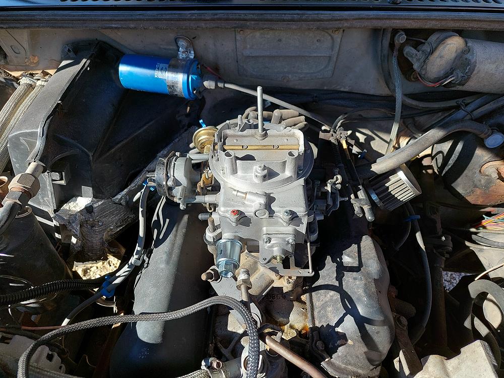

When I bought this, someone had already converted it to a Duraspark.

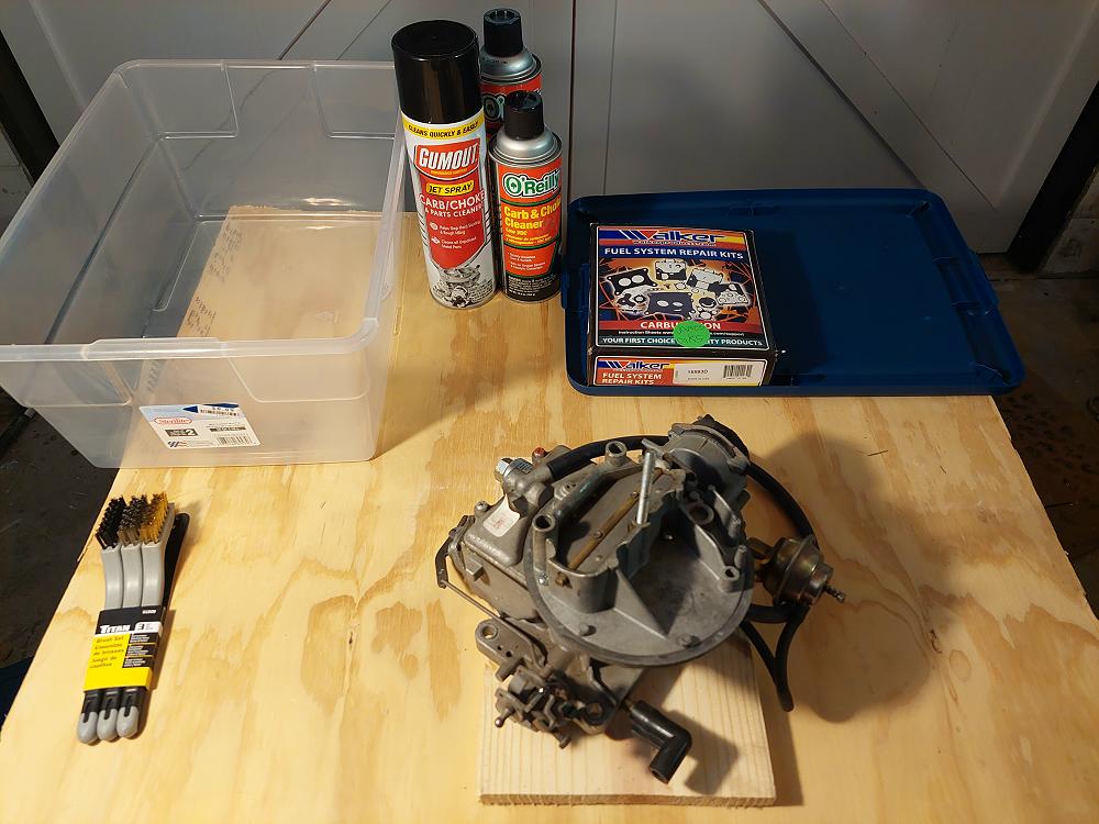

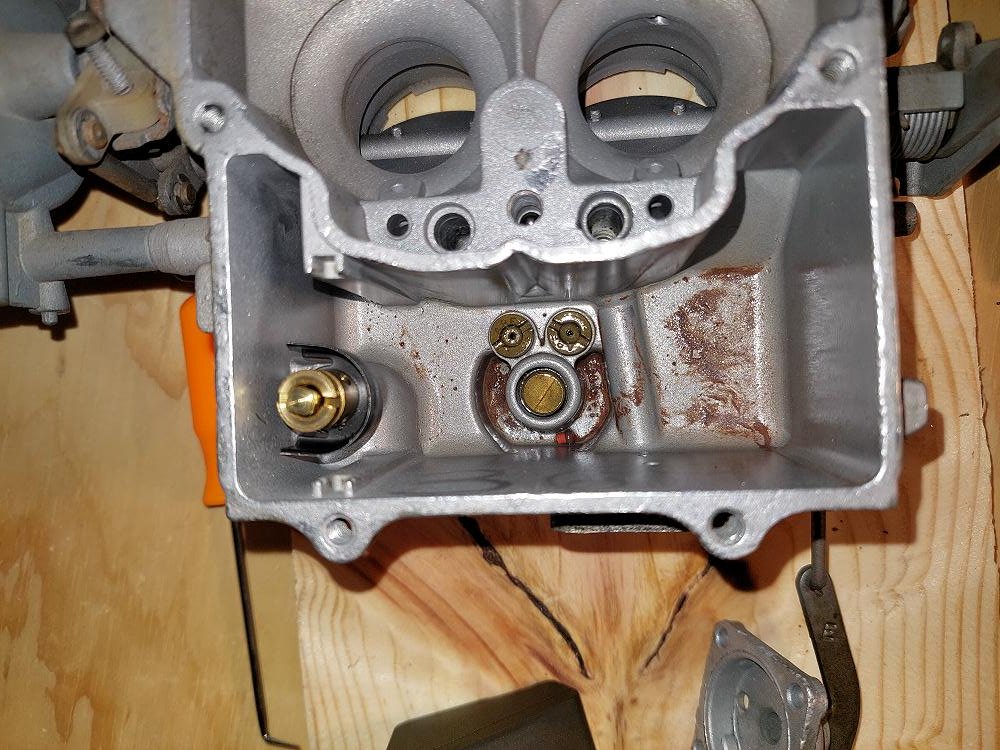

The carb was leaking from the accelerator pump, so I bought a rebuild kit, rebuilt the carb. and reinstalled it.
This is what I found inside...
