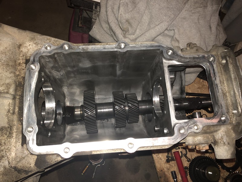

Mine was $150, if you like to tinker they are a fun trans to take apart.
Pack a lunch because they are a PITA to pull, at least the 4wd variant is because there is suspension stuff behind the t-case you have to remove. Also grabbing the separator plate from a SBF truck with the M5OD is advised (by me)
