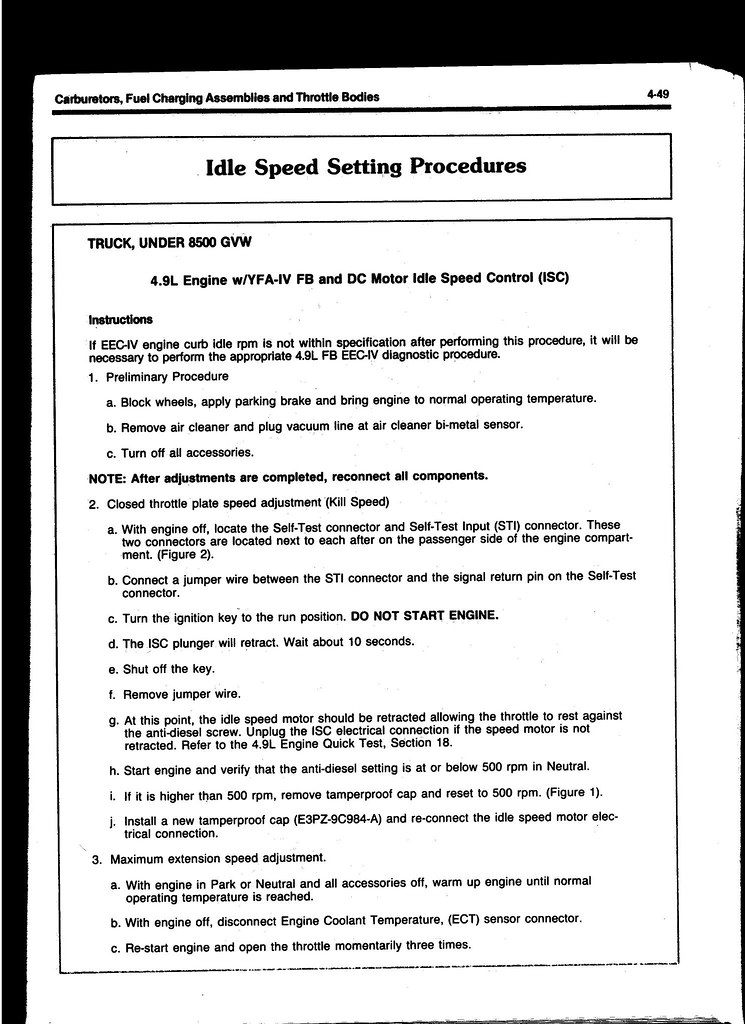

Here is the procedure for adjusting the 300 six carb which has the same computer controlled setup and is very similar to your controls on the 2.8. Most people get tired of messing with this computer stuff and swap the distributor and the carb out to get rid of the computer system on the 2.8.
1984 2.8 v6 won’t idle
1984 2.8 v6 won’t idle300 six carb adjust 1 by D Franklin, on Flickr
