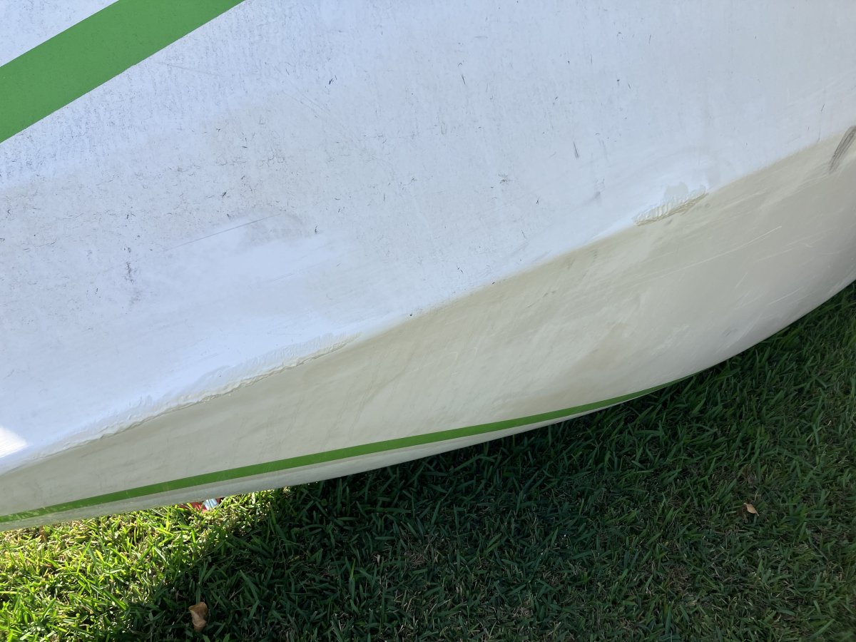

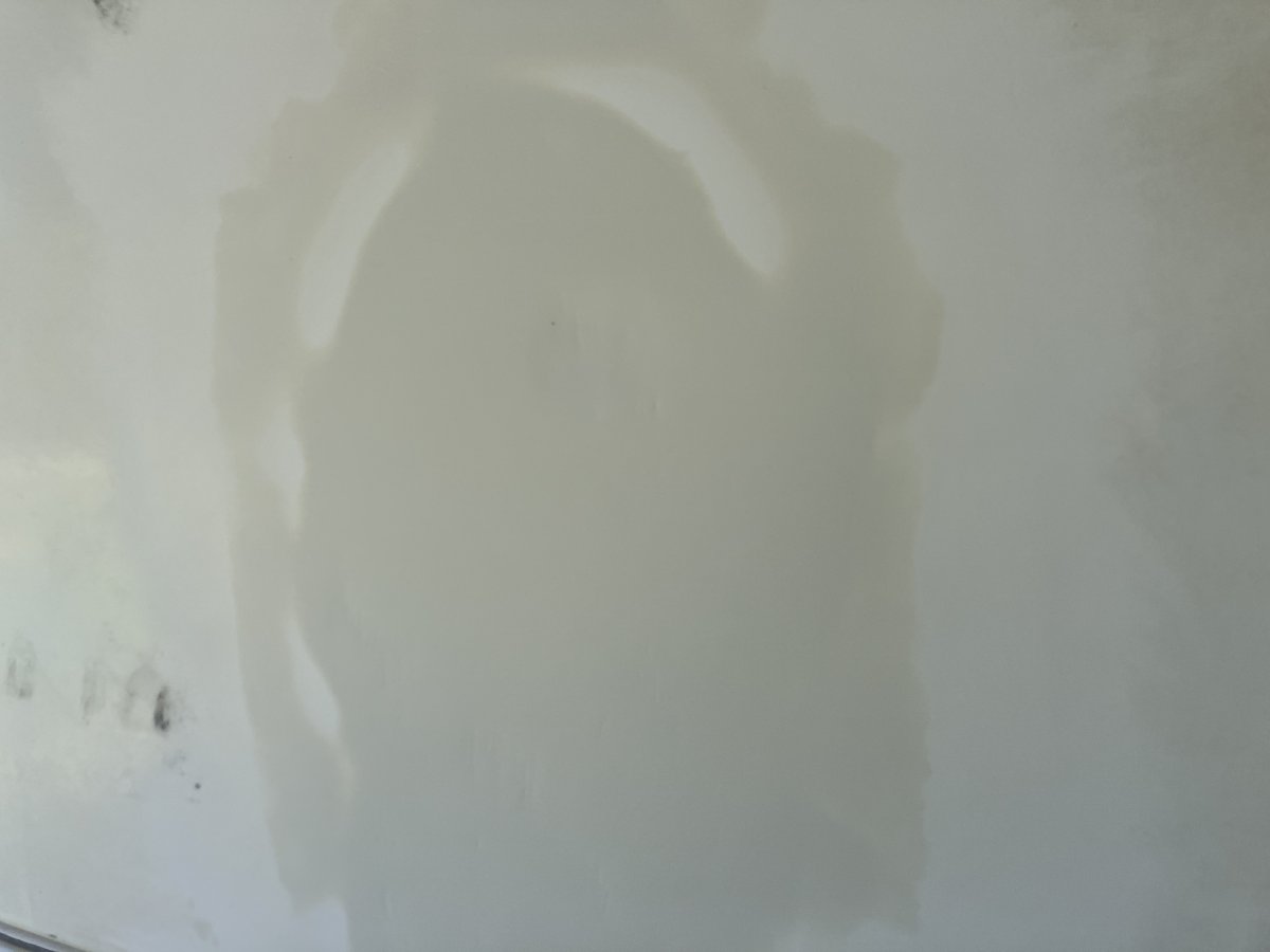

I put on the gelcoat this morning. I mixed a few test batches before I felt I got the color right. Now that it's on the boat in a larger area I think it's too dark. Oh well. Maybe it's the lighting and/or it will lighten up as it cures. I think I had the right mixture as it worked in the cup very nice. I used 1.75% MEKP and it was between 72-75 degrees while I was working. I had about 5 minutes before it started to kick and turn a little pudding-like, and another 5-8 minutes of working life after that. I also found some areas on the keel that were weak and a few other chips, so I decided to sand those out and repair them with gelcoat too. Originally I was going to use epoxy for that since it's tougher and the keel sees a lot of abuse, but since I was gelcoating anyway I figured it was worth a shot.

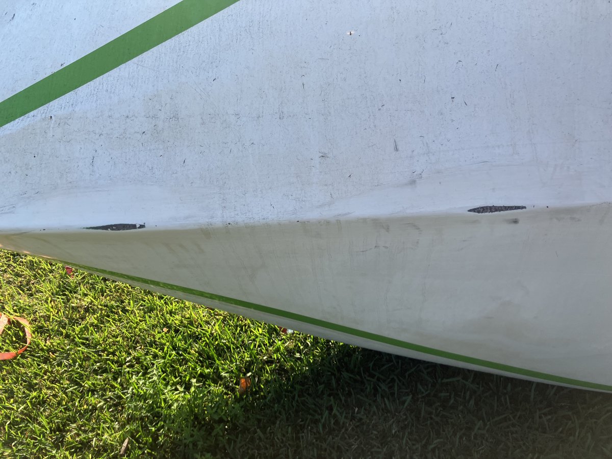

I was going to skip these and use epoxy on the keel since it's a lot more durable, but figured I'd give gelcoat a go while I'm doing it. I ended up doing 9 coats in three separate batches. There's a guy named Andy Miller that has tons of youtube videos of various boat repair and reconditioning processes. His videos have been extremely helpful for tips and techniques. In his video on gelcoat repair he recommends brushing each coat on perpendicular to the last after allowing the solvent to flash off. This worked really well and it was easy to build thickness. I'm hoping I've got enough product on, but if not I can sand and apply more layers.
The skinny spots on the keel were hard to build up without running. After the first coat I just didn't bother with those areas until the gelcoat started to kick in the cup and get thicker. Then I could glob it on and it stayed put. The first two batches were plain gelcoat and I mixed wax in with the third batch to keep air off the surface and allow it to cure out completely. Unfortunately brushing it means there is a lot more sanding in my future, but I don't have any of the equipment needed to spray the gelcoat. I saw some videos where people were modifying cheap harbor freight guns and using those, but with brushing there is very little cleanup and if it kicks early in the cup you're only out a 99 cent chip brush that was disposable anyway. There's also no overspray to worry about.
Now I wait, and hope and pray I did it all right and the gelcoat bonds and cures out.
Yep the color is boned. Pretty disappointed, but oh well the fish will have to look at an ugly boat bottom. I’ve been sanding all morning and it’s finally getting there. I bought an air sander to use because I got sick of hand sanding after 10 seconds. I started with 220 to cut down the peaks of the brush marks and will work my way up to 1200. I just finished the 220 work.
The surface is far from perfect. It probably could have used one or two more coats, but it’s good enough. It’s only real purpose is to keep UV off the epoxy.

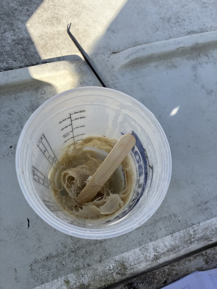

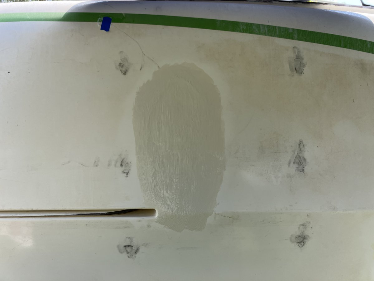

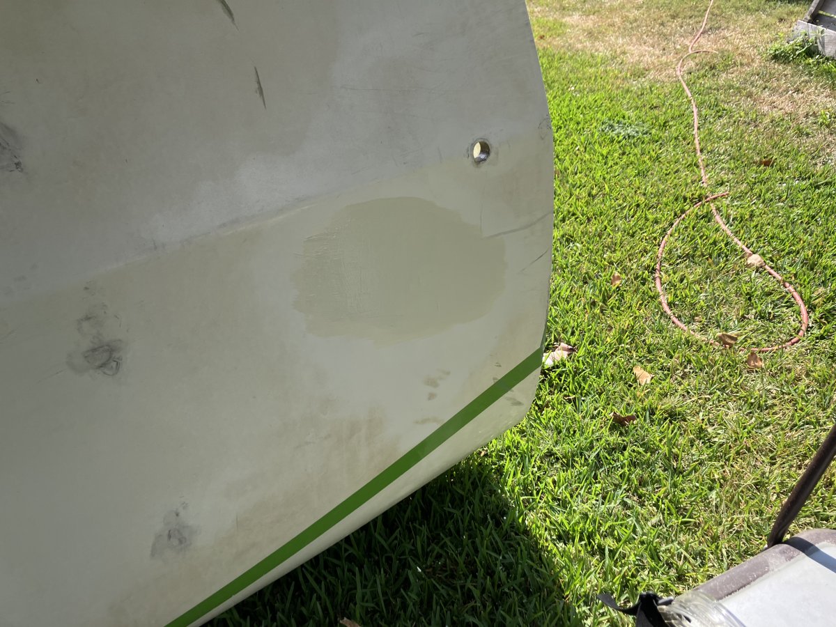

Over the week I was able to pick at things a bit more, and worked on fixing the rudder mounting. To fix it, you have to remove the rotted wood and replace it with structural filler, inject it with thinned penetrating epoxy, or a combination of both. The epoxy seals the rotted wood and turns it into a composite. To get the real bad wood out I took an allen wrench and chucked it in my drill. Then put it in the hole and hit go. The wrench turns around and loosens up the worst of the rotten wood near the holes so epoxy can be injected. On the inside I noticed the wrench turned very easily, too easily like there was nothing there. I figured the wood was completely gone, but then found the wood near the outside was solid. I thought it was weird that it would be more rotten on the inside than the outside so I opened up the inside holes so I could see what's going on.

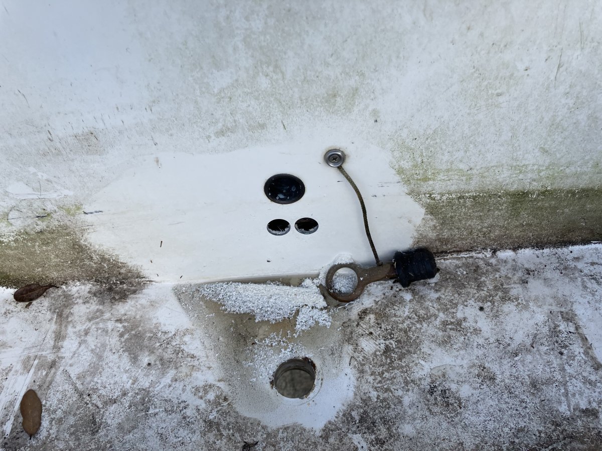

These two holes are for #10 machine screws that go through the transom to hold gudgeon. After opening them up I could see there was no plywood behind those holes. On most boats I've seen the transom has a solid core with laminate on either side. However this boat appears to have plywood bonded to only the outside laminate. The inside slopes back slightly so there's nothing behind it on that side, especially near the bottom. That kind of explains why the bolts looked like they were going to pull through. The hollow space behind this leads directly down to the bilge where the drain is, so unless the boat was upside down penetrating epoxy wasn't going to work. Thickened epoxy it is then! There are products ready made for this purpose, but I couldn't find them locally. I wanted to get this done before the weekend as it is forecast to rain and I didn't want all the wood getting soaked as it would take forever to dry, so I made my own filler using the dust captured by my RO sander when working on the hull and some glass fiber I chopped up. It wasn't super fun to work with but it got the job done.
I removed the bilge plug drain a few weeks ago as it needed to be resealed anyway. I found a piece of 3/4" copper pipe fit perfectly there and prevents any stray filler from dropping down and plugging the drain path for bilge water.
I mixed up some epoxy and added my filler material, then set about shoving it in. Prior to this, I used some plumbing repair putty (also epoxy) to build a little "shelf" that would prevent my filler from sagging and/or running down. I really did not want to mess up bilge drainage as it would be a nightmare to access and fix any of that. The filler ended up working quite well, it didn't sag at all and the shelf probably wasn't even needed. The only trouble was it was hard to tool it and smooth it out due to the relatively long fibers. Commercial milled glass filler strands are very short but my homemade ones were all over the place. Not a huge deal as it can be sanded later.
Some cure time and a little sanding and this should be good to go.

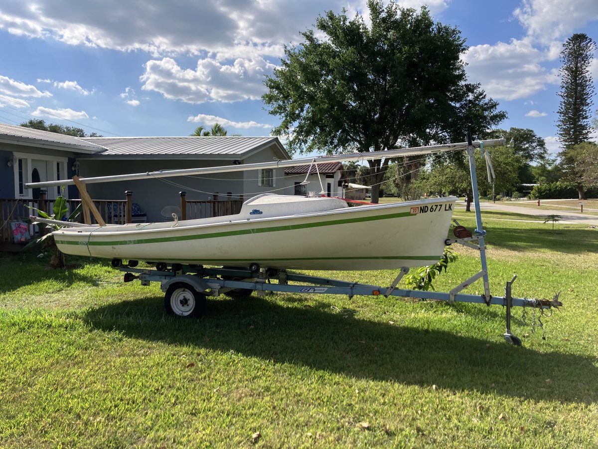

My Son and I washed the boat up and went for a sail on Lake Okeechobee yesterday evening. Everything worked well. No leaks, at least no worse than before. DS IIs have a common problem with leaks through the centerboard trunk into the bilge and I think that's what is happening with mine. It ends up being about a cup every couple of hours so nothing big. We bought a small outboard for it a couple of years ago but I've never used it until now. It's not really needed for sailing the lakes up North, but there's a long channel to access the open part of the Lake O as most of it is more like a swamp in my area and the motor proved its worth.

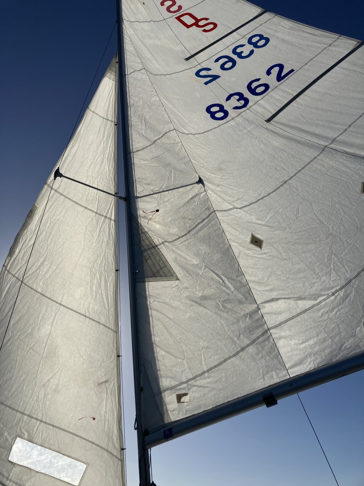

It felt good to have it back on the water. I also got to try out a bunch of the new rigging I did a couple winters ago, and also found that I've lost most of my routine. I kept noticing things as we went, like not tying and pulling down the boom. You can see the line dangling down in the photo. I also used the wrong sheet for the jib at first and felt pretty dumb. Still, not too bad for a first go. It was our first time on that part of the lake and we saw all sorts of birds, some were having good luck fishing!
