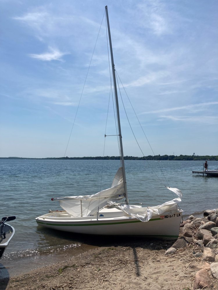

A boat counts as "other vehicles" right? A few years ago we bought an O'Day Daysailer II sailboat. It's ~17ft. long and uses a sloop rig, so one mainsail and one jib. The hull was originally designed by an Englishman in the 50's and has a small cuddy cabin that apparently can be slept in. The designers must have been a good bit shorter than me and enjoy donating blood to mosquitoes more than I do. Mine is the 2nd iteration (hence the "II") and thus has an FRP floor and seating, and a different cuddy than the original. These boats have a bit of a cult following and many race them. I knew none of that when I bought it, just wanted something to goof around in with my kids. There is also a DSIII but apparently it's not legal for racing. Here's our DSII, the Dingy Dinghy:

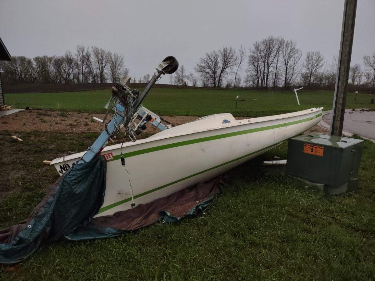

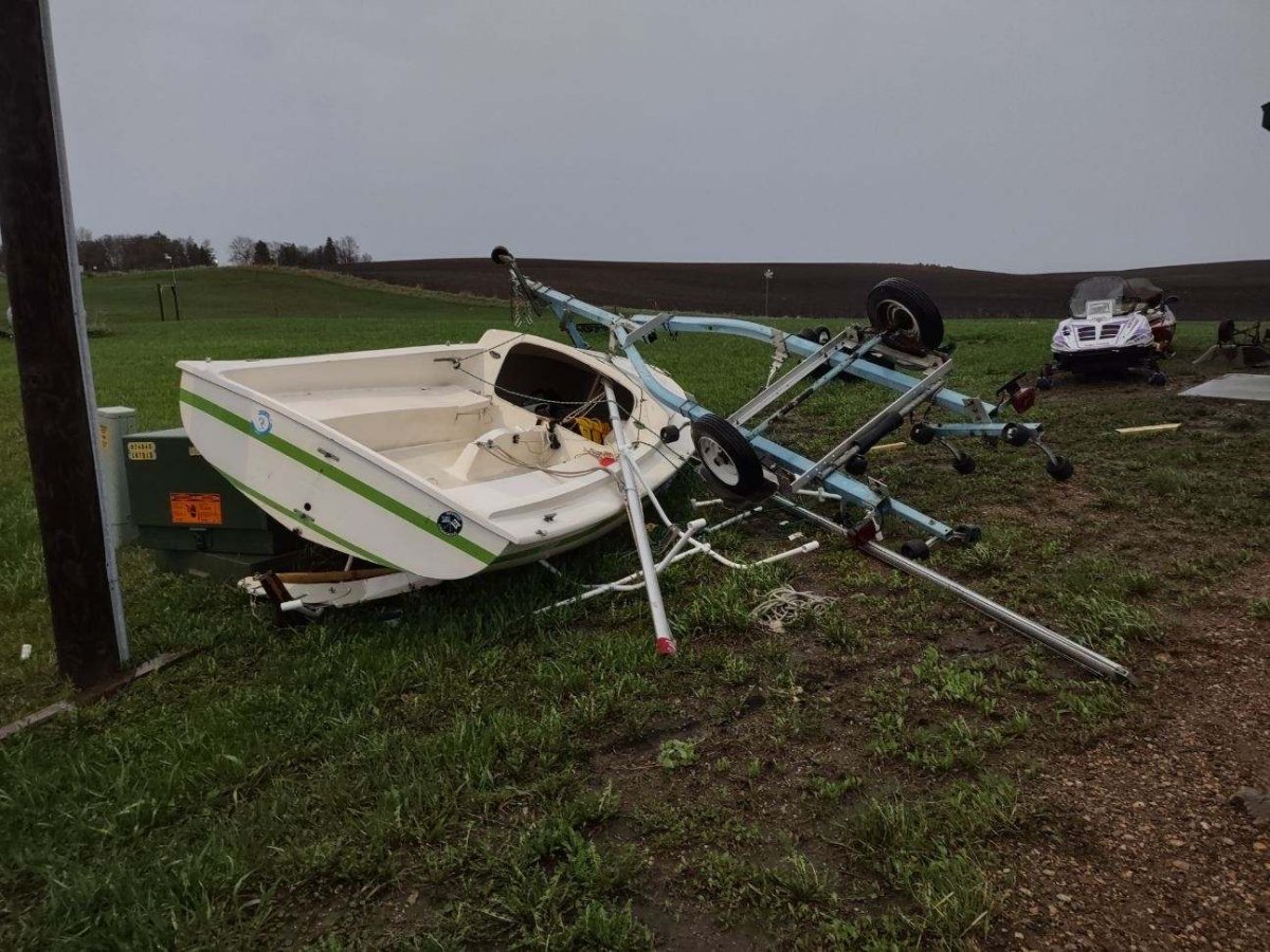

We usually kept the boat at my Dad's house in MN lakes country. There are far more sailing opportunities there than Eastern ND lol. Early May 2022 a nasty storm went through my Dad's place and either a very small tornado or microburst happened. The house and shop had minor damage like missing shingles and messed up soffit vents but otherwise OK. The boat/trailer was picked up by the wind and barrel rolled, separating during the brief flight, and landing about 20ft. off the driveway it was parked in on top of an electrical box. It hit hard enough to push the box off its base a little bit.
1976 O'Day Daysailer II Sailboat
Dad waited for the electric company to come out to help move the boat. We weren't sure whether anything was torn loose inside the pull box, and didn't want anyone getting zapped. The box was fine and they were able to move the boat and get it realigned, then I was able to start looking the boat over. Daysailers are known to be overbuilt, but I was surprised how little damage it had sustained. All I could see was the bow eye was ripped off (it was about gone and due for replacement before this happened), some gelcoat dings from the trailer, and some gouged up gelcoat on the bottom from the pull box. The tall post on the trailer that holds the mast while traveling was bent, but easily straightened. We were able to load the boat on the trailer, and then it sat most of the summer while we figured out our move to FL.

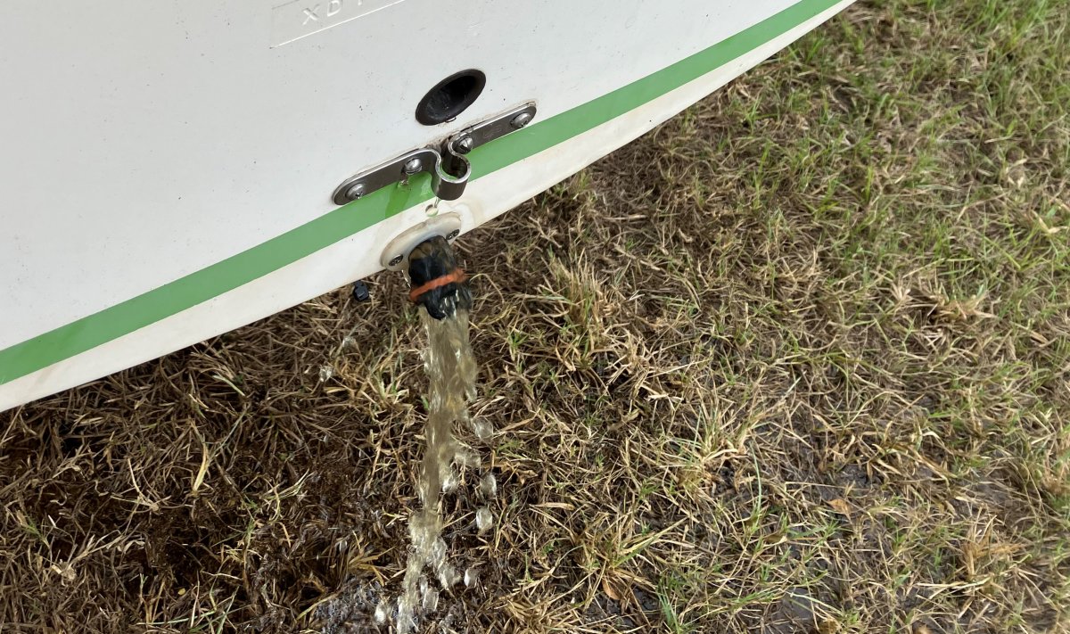

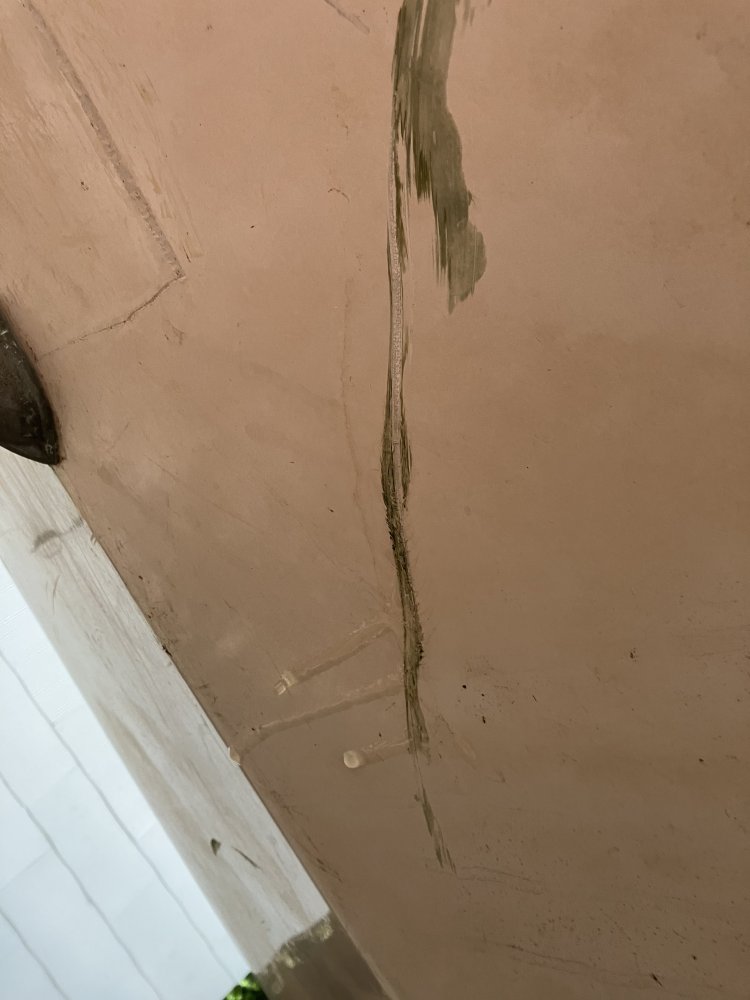

There were two especially nasty gouges on the bottom of the hull that were leaking, as well as the lower gudgeon for the rudder. While on the trailer, a mast crutch goes in the gudgeons to hold up the mast while trailering. The other end of the mast sits on a tall post at the front of the trailer. The mast crutch was broken in two, so I'm guessing that's when the gudgeon was damaged too. Shortly after this, we had to move into the new house we bought and the boat again sat for a while during our move-in, the holidays, people getting sick with Covid, and visiting family until I've finally been able to address the damage now. Aside from being perpetually itchy, the glass work is kind of fun. I'll update shortly with some more progress.
I needed to get to the bottom of the hull, so I rigged and launched the boat in my yard. Then I used the lines attached to the mast (halyard) to careen the boat over on its side. With this little boat it's very easy to do, and a stake with some line keeps the mast on the ground and the boat on its side. Careening is how they used to do maintenance and repairs under the waterline on large ships. They would sail it in on high tide and anchor, and when the tide went out they would careen it over. I imagine it's much more difficult on a larger boat with ballast.

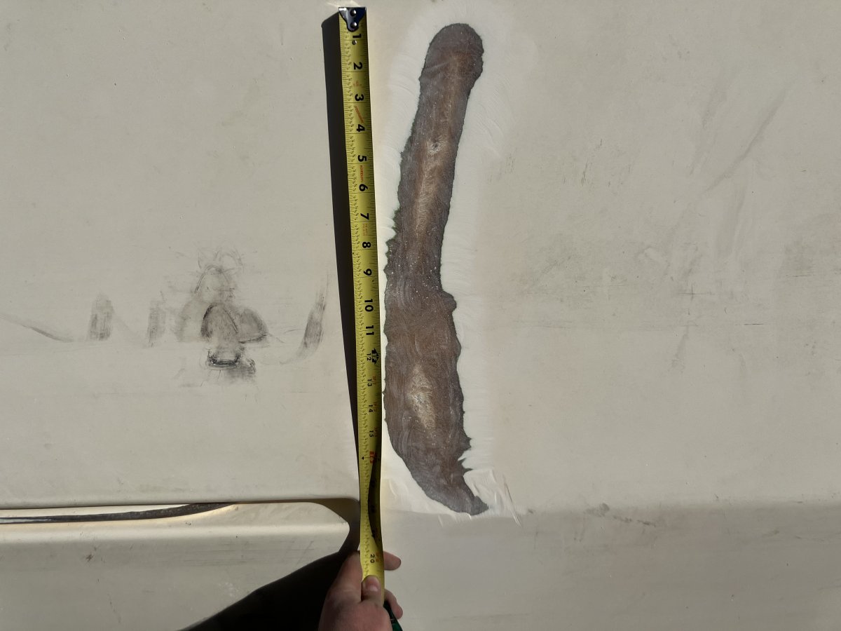

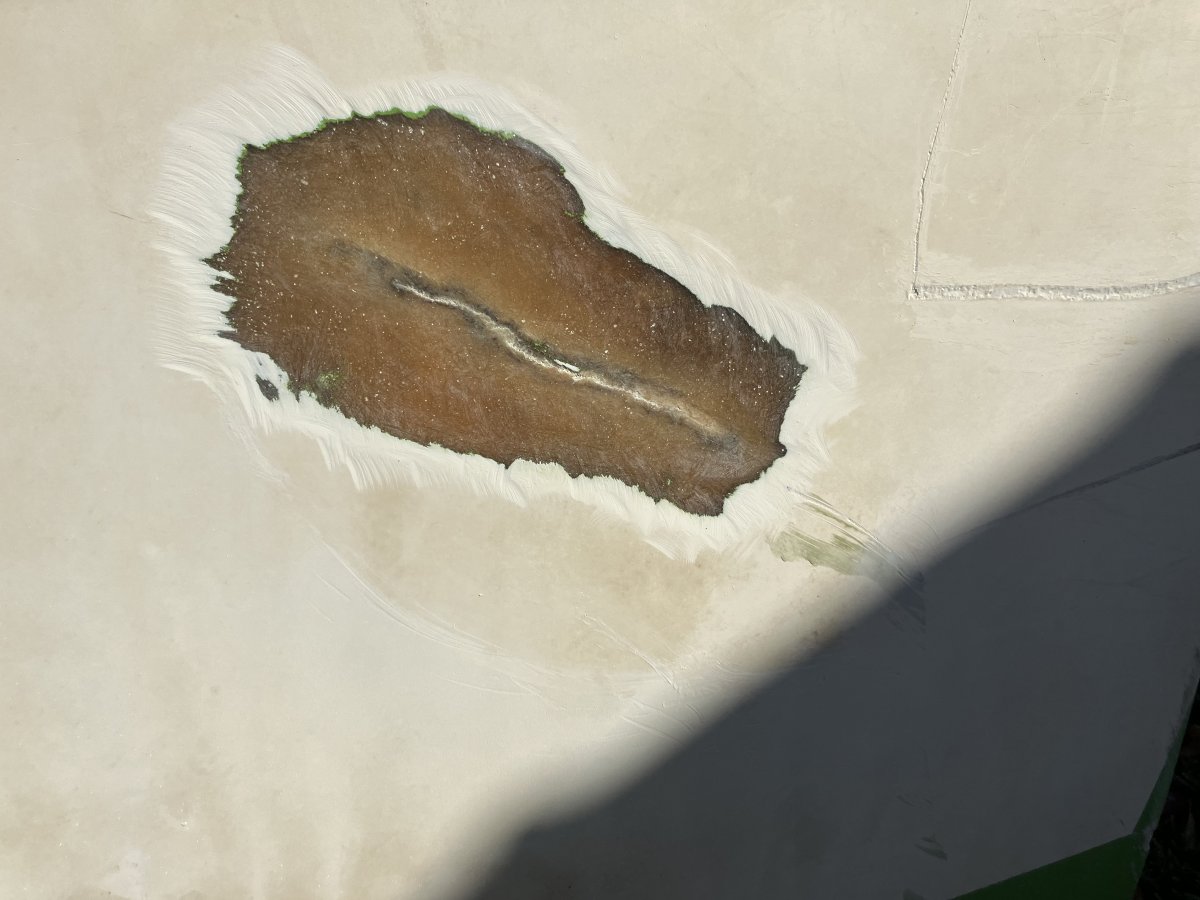

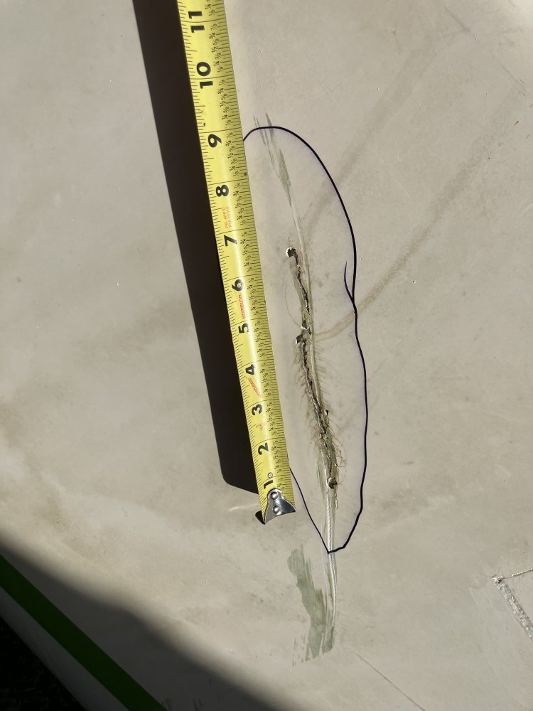

I don't have a great picture of the entire thing, but here's the smaller of the cracks before grinding:
The process is basically remove material until you reach good laminate and repair. Good laminate is dark colored. Damaged laminate is whitish and opaque. These areas need to be completely removed. I ended up finding two main areas of damaged glass.

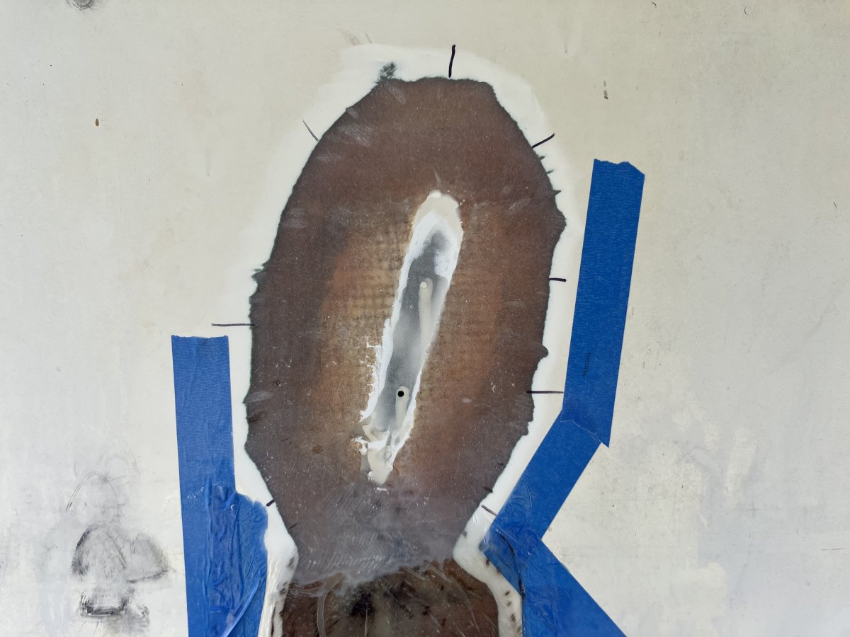

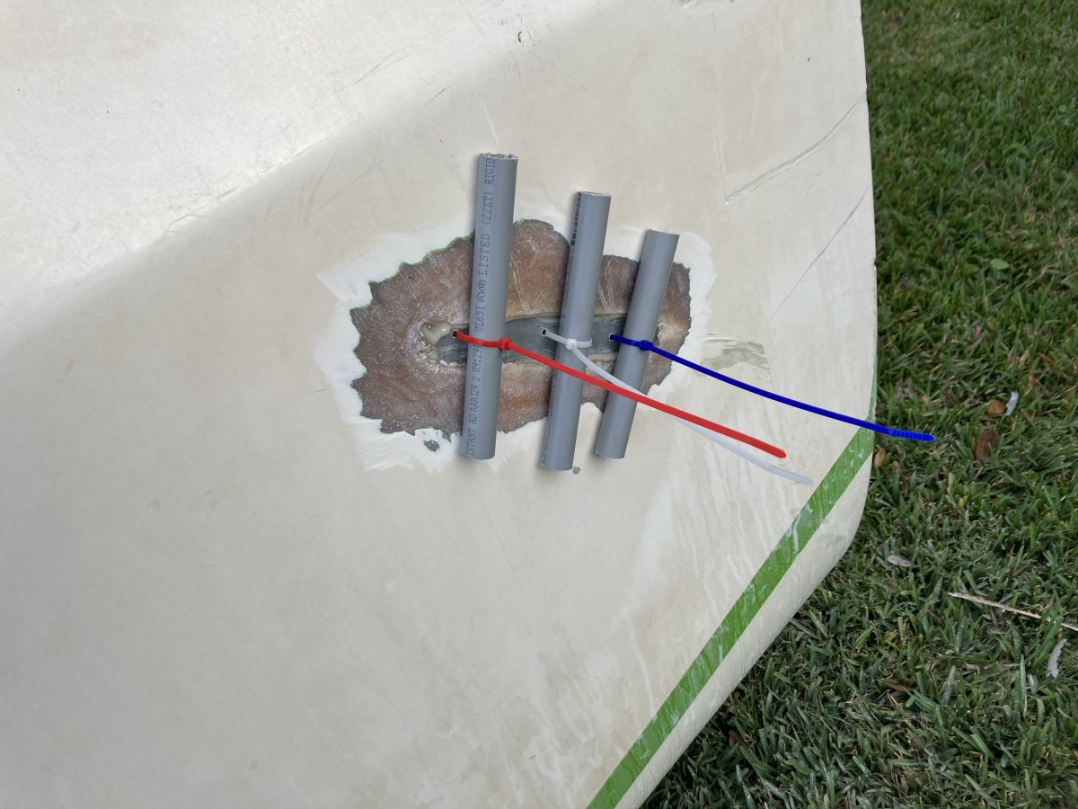

The basic process for the patch is to bevel back the area around the damage and lay in cloth to build it back to the proper thickness. The bevel needs to be a minimum of 12:1 to the thickness of the layup. More doesn't hurt. So for a 0.25" thick layup you need to grind back 3" out on all sides of the damage. I used an angle grinder with a 36grit flap disc for the bulk grinding. I found that to be super effective for removing the laminate and getting the bulk of the bevel done. The slots are just big enough for me to get my fingers and some sandpaper inside the hull to rough it up. Once that was done I fished my backing plates in and "glued" them in place with thickened epoxy. I had laid these up earlier and experimented with different numbers of layers of FG cloth to get them as stiff as possible while still allowing them to conform to the hull shape somewhat. It ended up being unintentionally patriotic:
The zip ties did a decent job getting the plate up against the hull, but there were some areas that didn't pull all the way in. Mostly on the ends. Once the epoxy cured, I made some more thickened epoxy to "fair" out those areas. Ideally, you want an even, shallow concave shape to the repair area. Otherwise, the cloth can bunch and/or air can be trapped easier in the layup. Both are bad. Unfortunately I didn't get any pictures of just that process, but you can see it in the photo below. The white and tan colored areas are the thickened epoxy. I don't know if this is absolutely necessary, maybe it is even detrimental, but it made sense to me so I just went with it. Plus I was kind of bored at the time and needed something to do while waiting for my FG cloth to arrive for the main repairs.

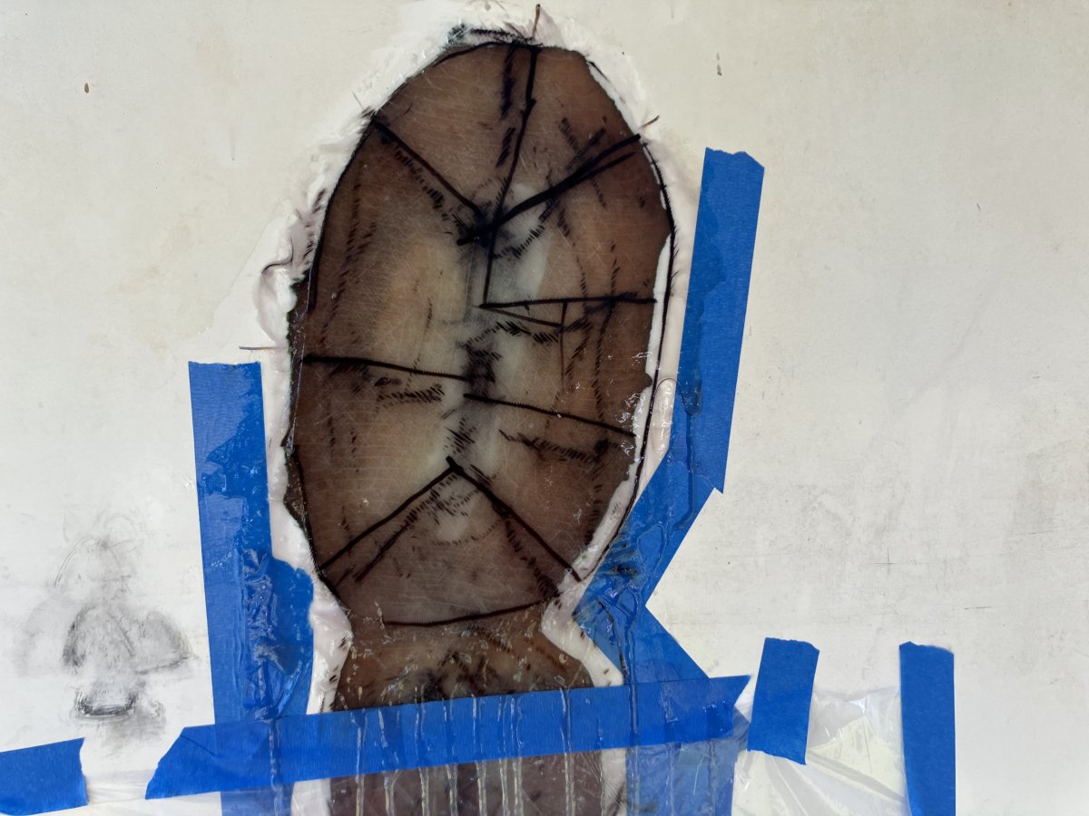

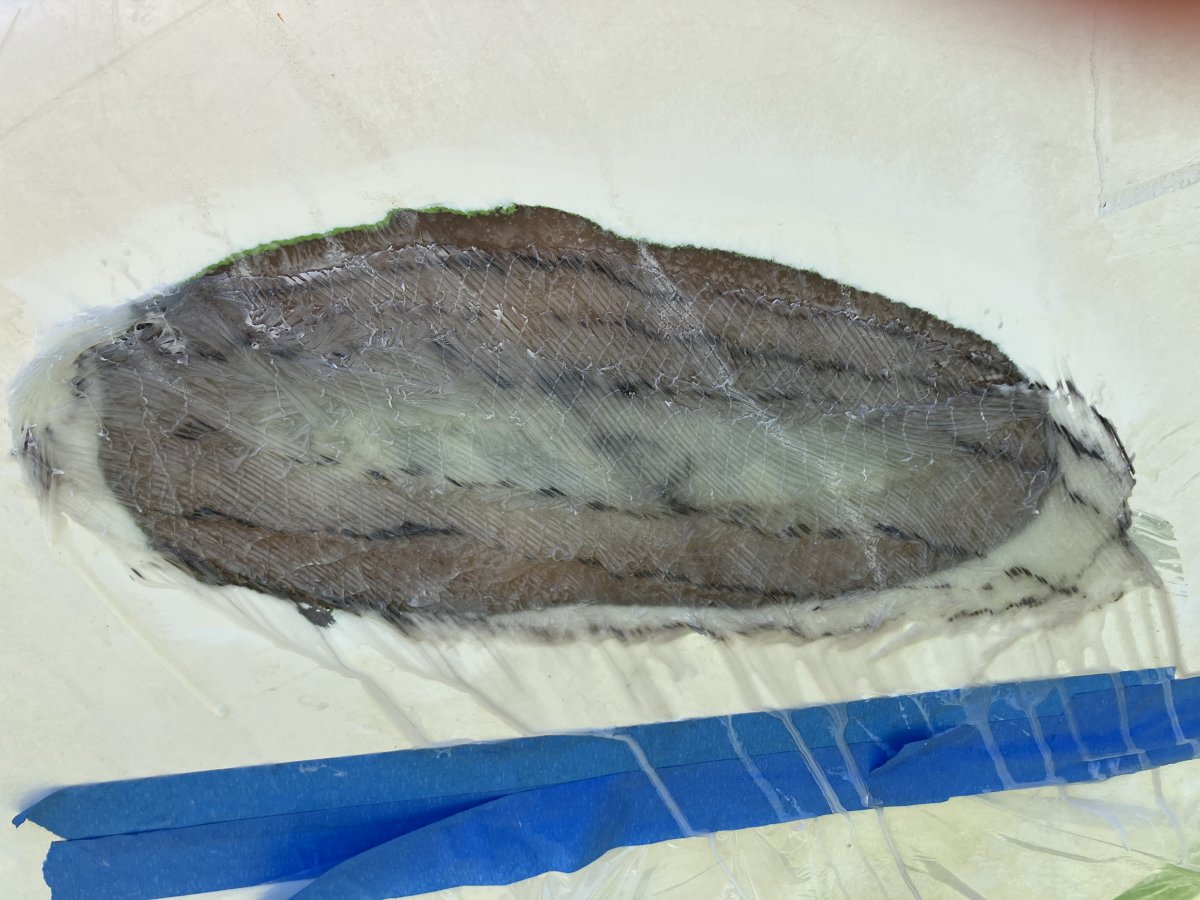

To make the patch blend with the beveled edges, you cut multiple layers of FG cloth to build thickness starting with one the size of the entire bare layup area and cutting each successive one smaller than the last. There are two schools of thought on how these should be laid up. Some believe the largest piece goes first and others believe the smallest goes first. On this boat it's probably not that important, but I chose largest first due to that being recommended by resin manufacturers. I chose to start with the patch by the stern, the thinnest area.
The number of layers needed is based on the thickness off the cloth or mat used. I used 17oz. biaxial glass, meaning two layers of straight fibers at +/- 45 degrees. Each layer of plain 17oz. is approximately 0.030 thick, so to make 1/8" I needed 5 layers with an expected finished thickness of 0.15. The excess ends up being sanded/ground off.
Now it's time to choose resin. Although the boat is made from polyester, I decided to use epoxy because it's straightforward to mix and use and has excellent mechanical bonding capability. The mechanical bond is important especially since these repairs are below the water line on a fully cured surface. Polyester doesn't offer the strong mechanical bond and is more finicky about mixing. It uses a catalyst (Methyl Ethyl Ketone Peroxide) that kick-starts the crosslinking process that turns it into a solid. Too much catalyst and you will harden too quickly or start a fire in your mixing cup. Too little and it will not cure out. Epoxy works differently, with the hardener being a component in the cross-linked polymer chains. The problem with epoxy isn't UV stable so it must be coated with something and it's not officially compatible with gelcoat, which is polyester-based. Anecdotally it appears gelcoat can bond to epoxy that has been mixed, cured, and prepared correctly, so that's what I intend to do.
Back when I was in school I got to mess with composites a bit, so I'm somewhat familiar with the process. However, that was in a lab with ideal conditions and we had infusion systems, etc. This was completely different and I ended up kind of learning as I went. It was a humbling experience. Working on an uneven, vertical, odd-shaped surface in the elements is 100x more difficult and I immediately had issues. First, I wetted out each layer of glass on the bench and "stuck" them to the hull one after the other. The resin and patches started to slide downward and moving them back up was like pushing a rope. Second, with the top patch being long and skinny the biax wanted to disintegrate while I was trying to roll air bubbles out. Third, the hull was warm from the sun, which accelerated the epoxy cure and it became impossible to move the patch around. It ended up looking like dog sh!t.

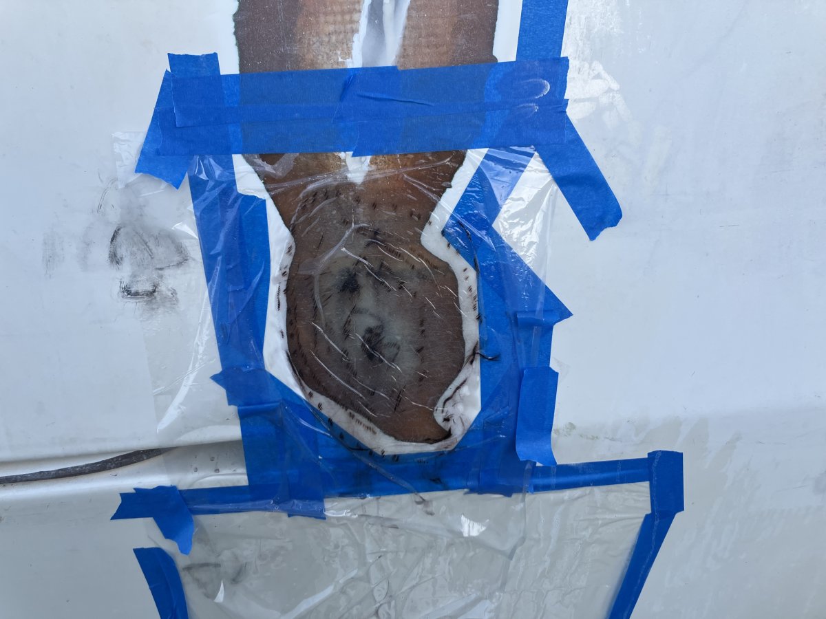

To add to the issues, I got ahead of myself and started the layup before I'd fully prepped the area. I had to put tape and plastic on quickly and did the best I could, but there were now epoxy runs all over the hull that needed to be removed later. The dew that collected on the boat overnight also blushed the epoxy. I talked to TotalBoat (resin mfg.) and they said as long as it hardened the repair would be fine, and thankfully it did harden. Also the top of the repair is a little resin starved. I considered grinding this out and redoing it but decided to let it ride as most of the patch is in position and wetted, and it was thicker than needed initially. Since I was working alone and had epoxy everywhere I didn't get any photos during the layup process unfortunately.
I made some changes for the second repair. First, I made sure I had everything taped off before starting the layup. I also laid up all the layers of the patch on the bench and transferred it to the hull as one piece, and added a layer of thin straight weave glass over the top of the whole patch. This added very little thickness, but held everything together during positioning and rolling out the air bubbles. 100x easier this way. I also put some plastic film over the area before it cured so it would keep the humid air and condensation away from the resin. This repair looked a lot better. It's about perfect on top but pretty resin-rich at the bottom though. I'm not sure how much control I have over that though.
I laid the third repair up on a Saturday, so I was able to do it early enough I knew it would be fully cured before any danger of humidity and dew. This time I added some lines on each layer to help keep the layers of the patch aligned during layup, and tried to roll excess resin down to end up with a more even laminate. I went a little too far and the top got very slightly resin starved, but since this will be sanded off I wasn't worried.
At this point, there are no longer any unintended holes in the bottom of the boat. Next step: Sand, sand, grind, and more sanding!
