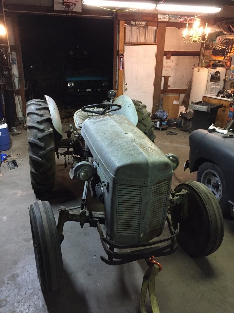

This was my great grandfathers TO20. Not the same as an 8N, but close. Works good as an overgrown lawn mower, driveway grader, and for moving heavy-ish stuff with the boom pole. Also lots of fun for general backroads prowling.

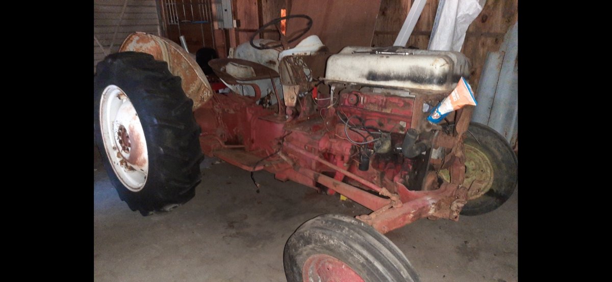

Here she is in all her glory... it dont look like much but everything works. It has new radiator, water pump, hoses etc in the process of getting put on. Has a "master" carb rebuild kit but he said I'm on my own doing that. Has a new battery and the starter was just refurbished. And it has a new umm I guess you call it a radius arm that he's putting on. He said it will be 100% back together and fully operational by the end of the week minus the one tire being flat but it will aparently hold air for a couple days.
Get a front clip for it and hit it with a coat of paint youll have a nice lil tractor that will pry outlive all of us
Oh and aparently it has no brakes but I simply dont see that as an issue on a tractor that will probably never go over 4mph.

Looks good. Sounds like $1000 to me.
typically the brake problems on those older fords are from leaking axle seals, soaking the brake pads. on a 8N the drum just slides off like most vehicles. on the 9N/2N the whole hub & shaft comes out, and its a much larger heavier hub. That 8N I have a picture of Id like to get going one day. Hopefully the back tires on that arent using cacl for weight, it was very common to fill the back tires with a calcium choride mixture, you got a good amount of weight per tire and it wouldn’t freeze but its very corrosive and if you had a leak it would quickly rust rims
