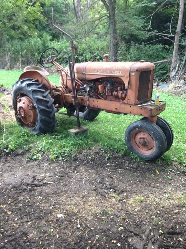

I have a WD-45, needs some kinda major work (final drive seal, clutch and shift tower rebuilt) but the problem is I am always using the darn thing and its problems so far are pretty easy to live with. Just keep an eye on the final drive when I plow (it is down in the furrow so it leaks then, take it easy when shifting, be absolutely positive the shifter is dead straight up and down going into third so you don't lock it into first and third at the same time)
I had a "come and get it or I am going to junk it" offer on a '50 WD. Engine is turns all the way over, one tire on each end holds air, fairly straight tin, has a Char-Lynn torque generator on the steering but no pump or brackets. Both rear tires have awesome tread with no real checkering, the one has cracks from sitting flat for years, I hope to save it. Its rim is shot from having fluid in it (for weight) which is why it went down but I have another rim. Both fronts are same as shot. Oil is high but clean... been sitting for 30 years so hopefully it is condensation. It is supposed to have a WD-45 crankshaft (1/2" more stroke) and overbore pistons (1/8" over with a "Power-Crater" design) Trans shifts beautiful. Needs rewired but it is simple, only three wires go to the engine. It already has a 12v Motorola alternator on it. My biggest concerns are the painted over oil filter (when was the last time it was changed before it was parked?) and something is stuck in or on the hydraulic pump, the lever doesn't want to move. I figure if nothing else this thing has several not cheap parts for my two other A-C's... but it was also a member of my great grandfather's fleet a long with my WD-45.
As I started on it to get it ready to get home so I can really get moving on it. It had a bad list to starboard and was down by the stern:

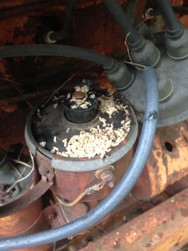

Need to work some bugs out of the ignition (just blew them out, nothing was below the dust cap, set of points, maybe a cap and rotor and it should be good to go):

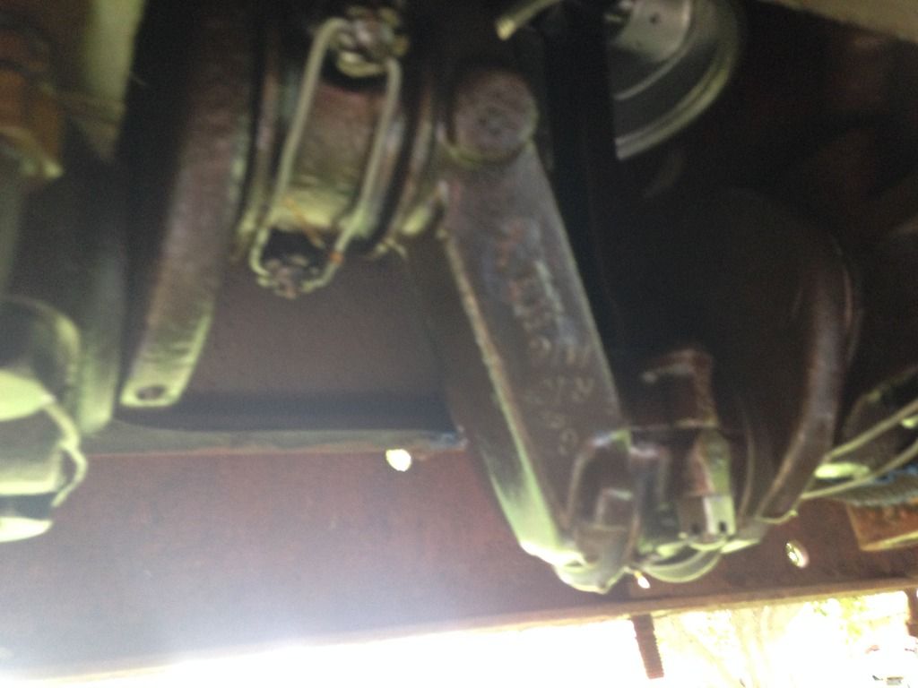

Char-Lynn PS torque generator. Will probably pull it off and keep for parts for the '45.
1950 A-C WD Resurection

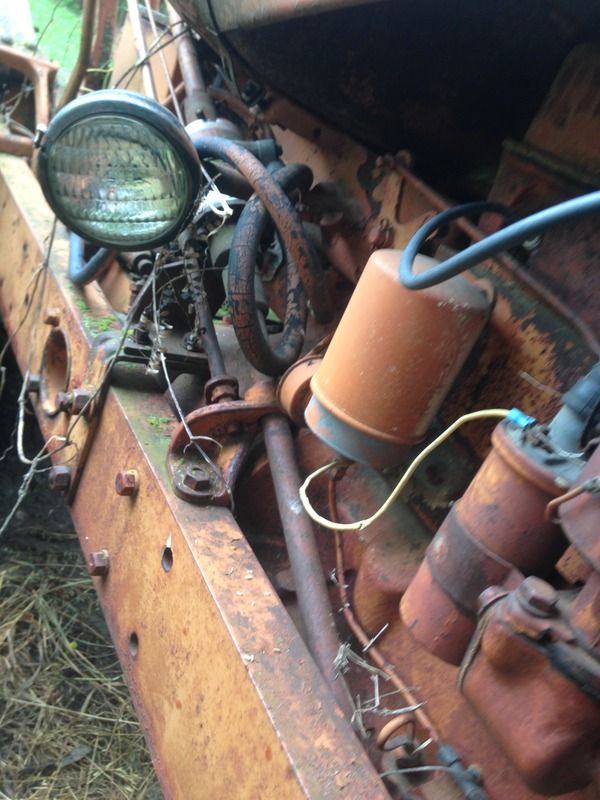

I see no signs of it every having a PS pump or reservoir which makes question how good the steering unit is considering the hoses are not capped.

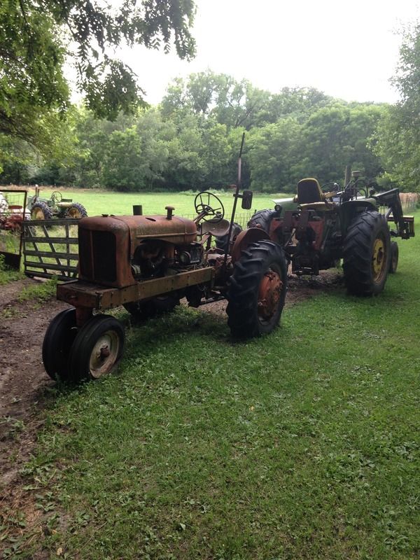

Got another front tire on it that holds air. I blew one out of my '45 a few years ago and borrowed this one off of it to finish the season.
I pulled it ahead and tried to jack up the rear, it didn't work from here as I was jacking up the whole side of the tractor. Ended up going off the hitch. The wheels are set clear in so I can't jack on the axle like I have with my '45.
I accumulated a set of tires/wheels off an old combine in my tractor pulling days, will work fine for this until I decide if it is worth putting a tube and a tire (maybe) on. It makes it look like a tractor rather than an abandoned hulk. Kinda shocked how decent the paint looks, after 15 years in that spot sitting in a pile of dead weeds with lichen growing on the out side away from the fence it looks a lot better moved out.

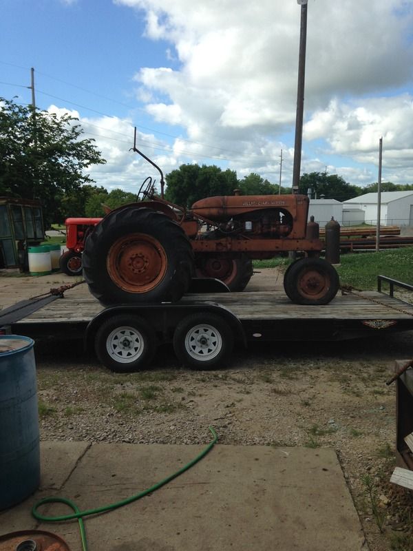

I need to measure it and see if it will still go on a trailer if I go ahead and put the other rear tire on so it actually sits level.
The carb is off and apart, both the throttle and choke shafts were stuck but they have since been freed up. Hopefully a tune up, a battery (robbed from another tractor) oil change and a small fuel tank will get it running so I will know what I have. Then flush the tank, swap the steering shaft, rewire, tires and add a snap coupler hitch and it should be able to intererchange with the '45 in the field. It is going to be sweet to have one I can leave a drawbar and 3 point hitch on (for the hoist and snow blade) and one set up with Snap-Coupler (plow, disk, rotary hoe, cultivator, subsoiler) so I don't have to keep switching one back and forth.
Went and measured it Saturday, it was sitting at 76.5" wide, no way it would go between 79" trailer fenders with the other combine tire on it. So while it was cool I ran up town and got a set of plugs and oil filter for it.

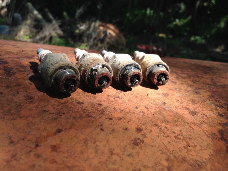

Plugs and filter are changed:
Plugs are a little crusty from sitting, look ok otherwise though:

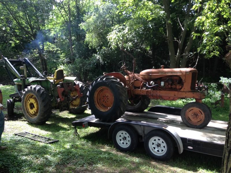

Getting ready to push it on with dad's 4020:
Pausing mid push to remove the ramps so we can get it farther up the trailer:
Bathtime!
And finally home:

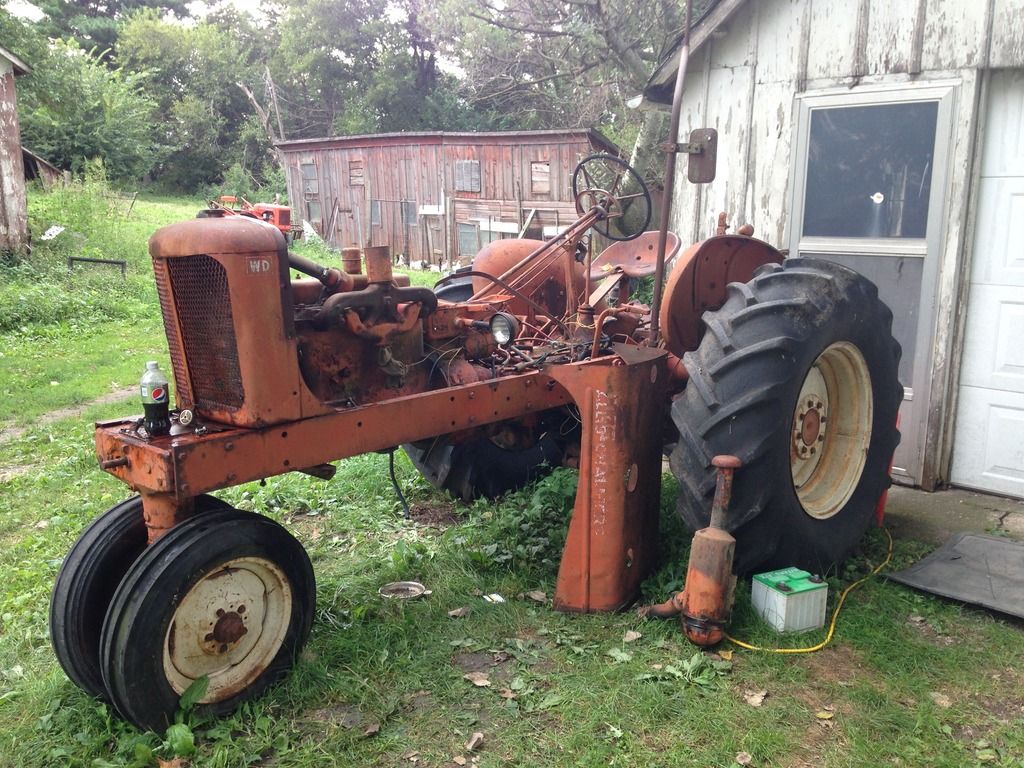

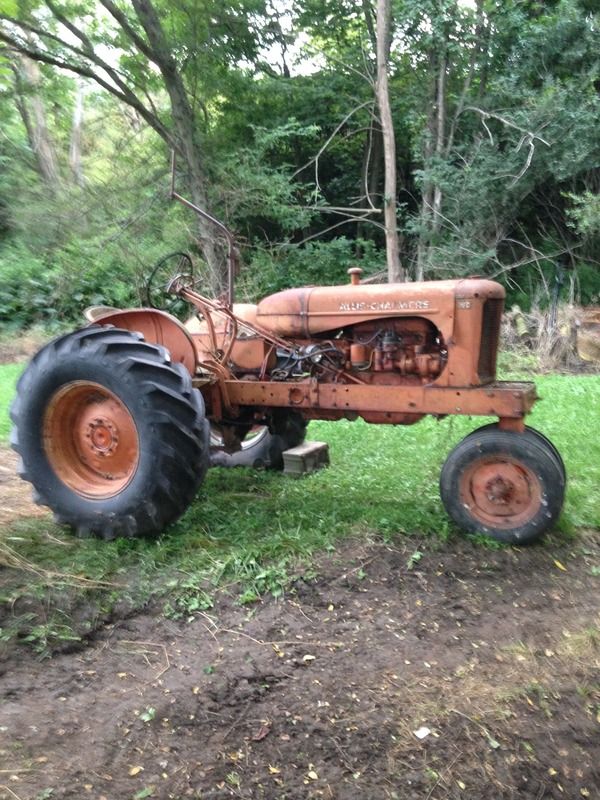

I got the second combine tire on last night so it looks a lot better. It is semi-comical that both the wheels on the right are orange (rear is rusty) and and both wheels on right are white (was a IH combine and front must be a later replacement)
Dad's WD is still at my place from filling in drowned corn with his little homemade 3 point planter, since it so rare for the three of them to be in one place anymore I thought it was a good chance for a family picture. These three WD's comprise my great-grandfather's fleet in its prime. My great uncle bought a WC which impressed his dad enough to sway him from JD and he bought the WD-45 new. Then he picked up the WD's used sometime after. The C I got in 7th grade from one of my parent's neighbors and hauled home in three pickup loads to put back together.
Left to right is: 1953 WD-45 (mine), 1950 WD (mine), 1950 WD (dad's (30k newer than mine)), and 1947 C (mine)

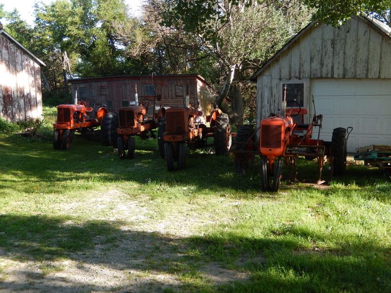

We just drug home a 1941 C not long ago, its our first non WC based Allis. Original plan was to flop the carrier in the rear end to run backwards and attach a forklift mast to it, but....its in too good of shape. Now we are thinking of just restoring it back to original. It came home in boxes.lol Previous owner dismantled it and sandblasted almost everything, but never finished.
Ill see if I can dig up pictures of some of ours. All are on the road to restoration, but none have seen paint yet. My 45 and two of Dad's WDs are ready for paint though.

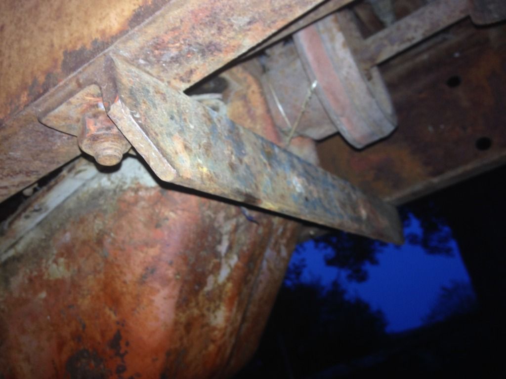

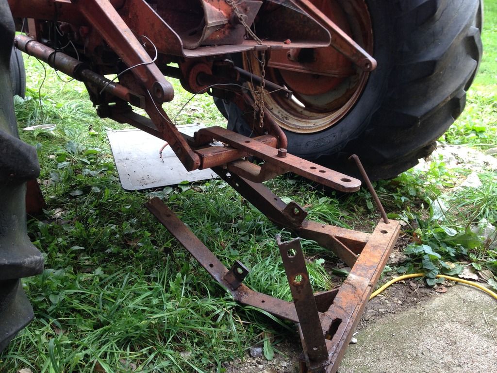

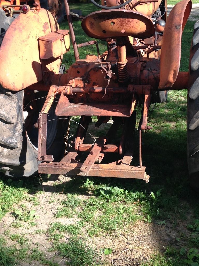

Been attacking the WD in my free time. Latched onto it with the B and got it moved out of the road.
Couldn't wait to get this morphadite sickle mower bracket ripped off.
Done!
I need to get pins to hook the cylinders back up to the rockshaft. I see no reason why this bracket utilized the limp lift arms. Granted the cylinders have to deadhead before the valve will switch to use the outlet (I suppose the sickle mower had a cylinder on it) and leaving the cylinders on the arm would have splattered the bracket. And you can see I have a snap coupler bell on the platform, I have the original welded claws from my WD-45 (dad upgraded it to D-17 ones) so I just need the lever to make that work.

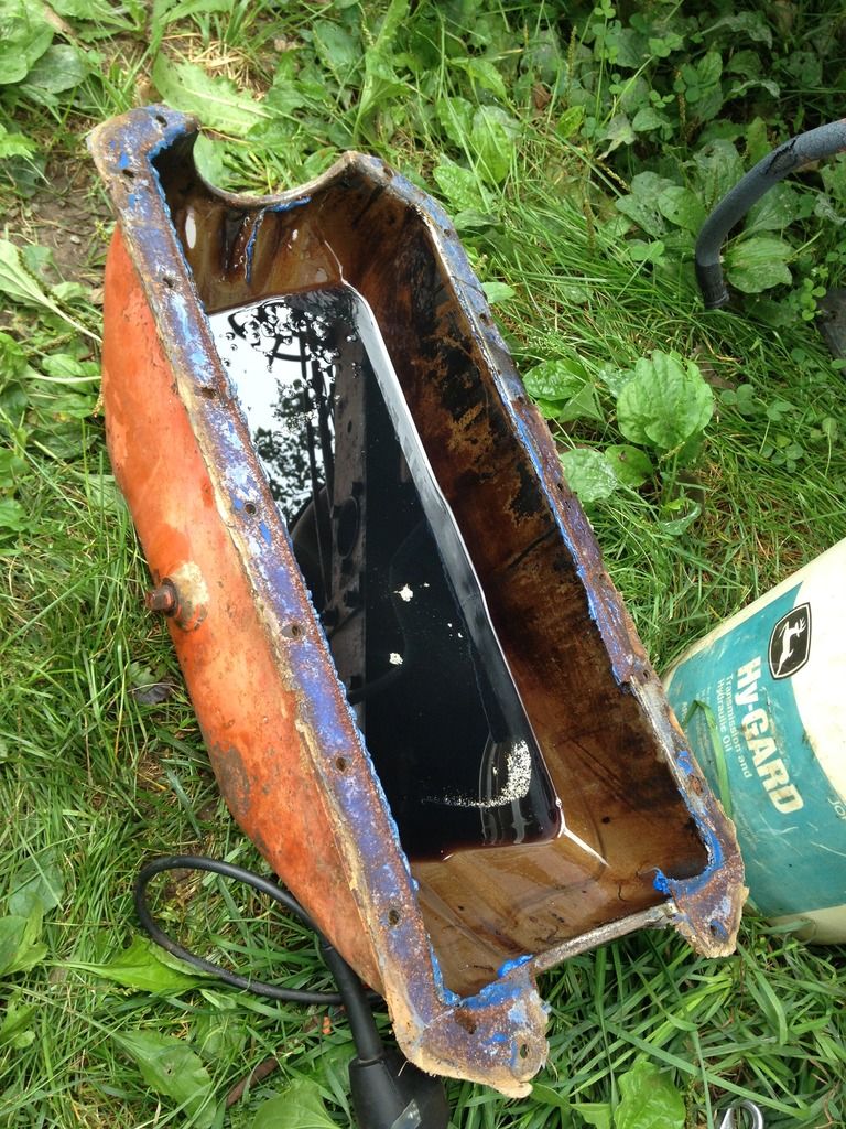

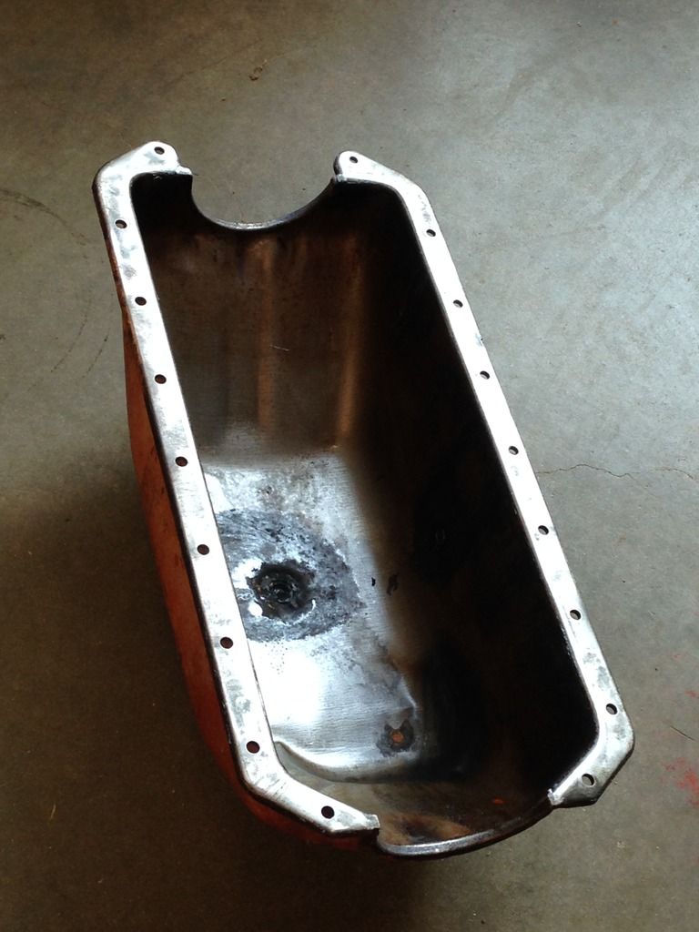

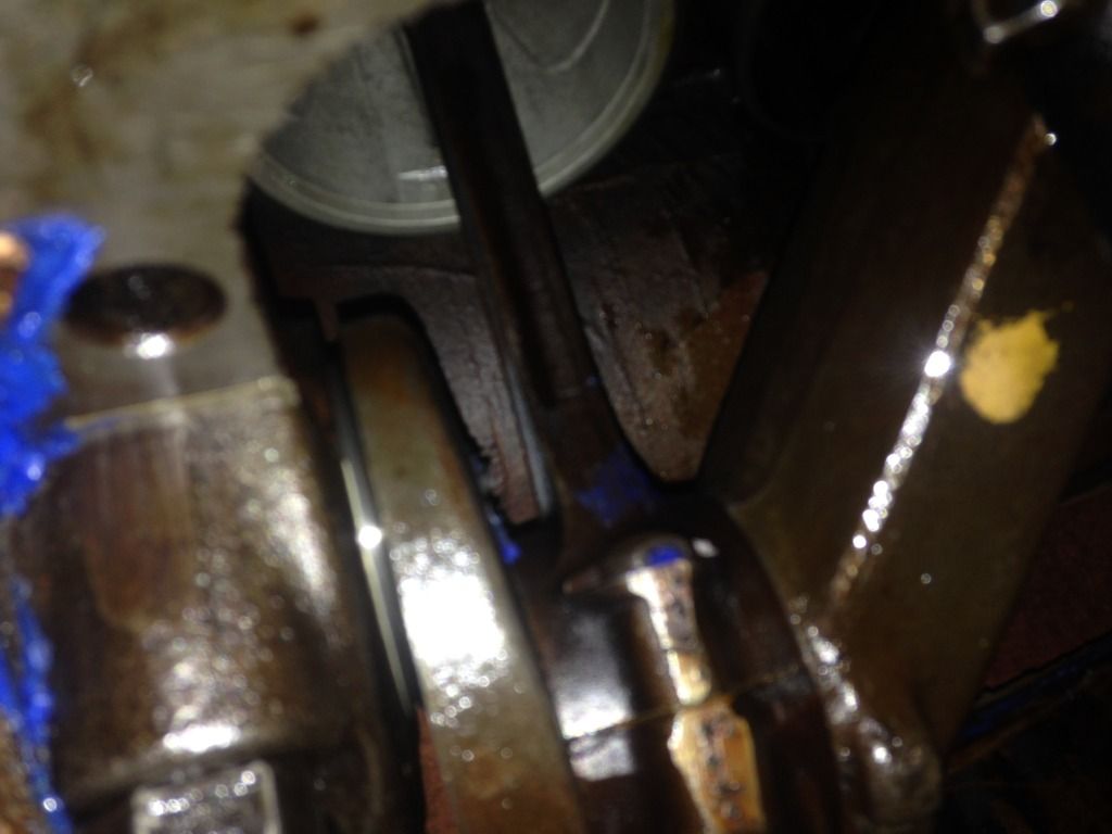

The oil pan drain plug was stuck, and some ninny used blue silicone on both sides of the pan gasket so it was halfway pushed out. Removed the front engine support and dropped the pan. Breaking the silicone to get the pan off was a pretty good fight. Nice and clean inside though, not much "gunky buildup" anywhere.

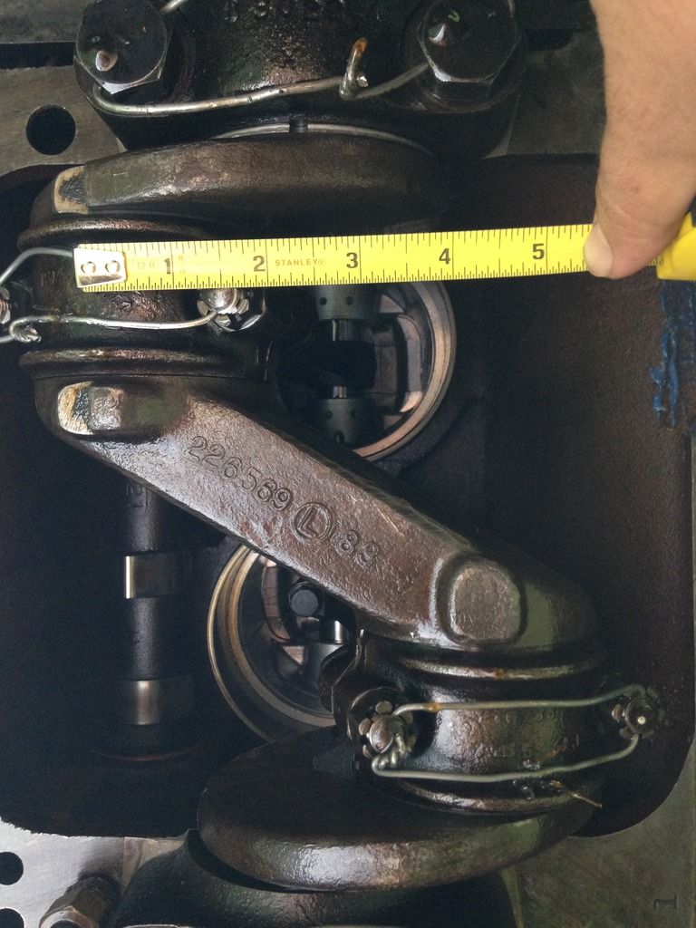

I need to get a tape and measure the crank to see exactly what I have for stroke. It has aluminum pistons but going by the ruler on my leatherman is tough to get 4.5". Crank is full of numbers, I need better pics and to research it.

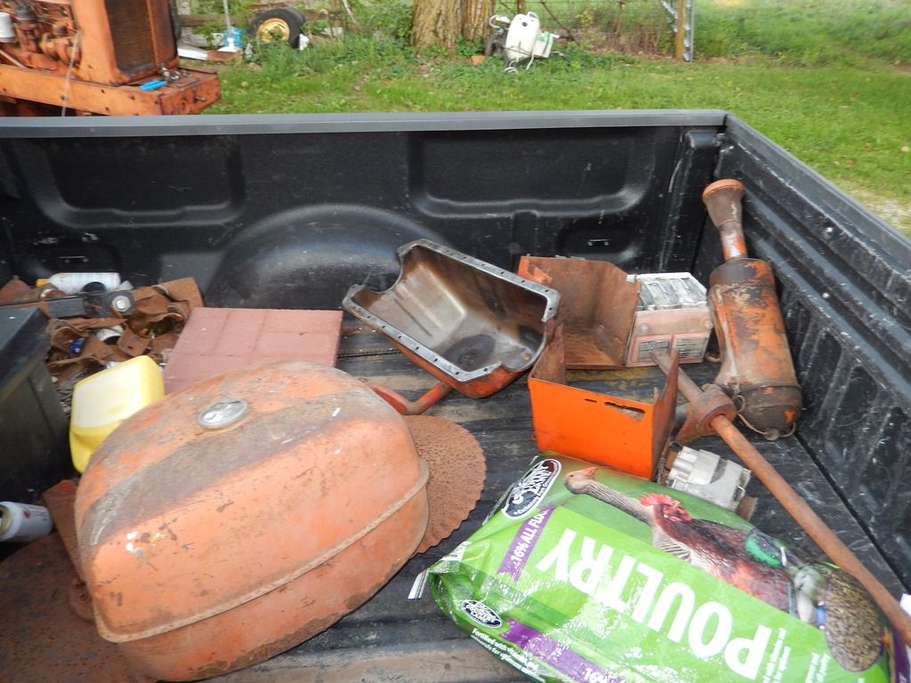

Next I pulled the hood and fuel tank off. Ripped the sediment bowl housing off the tank and started flushing it with water since it was full of dirt. I set it on the dog tie out so the ground wouldn't plug the hole... and the tie out punched through the tank. There are at least three pinholes elsewhere... so I need a tank. I think dad has one but I need to see if it is much better. We have a small nurse tank to test run it so no big deal.
Fuel tank support was full of dirt and walnuts so I pulled it off and washed it out while I was there.

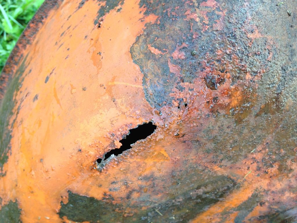

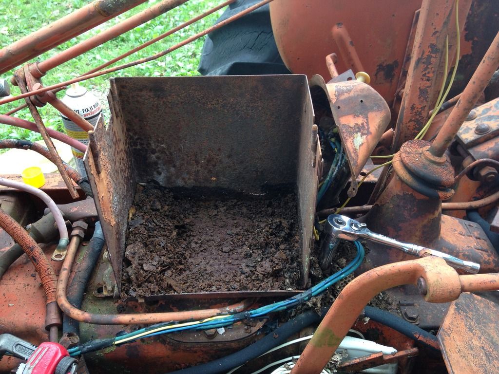

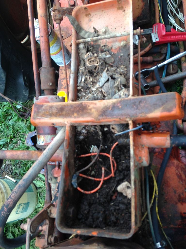

And then the battery box... the battery that was in it fell apart and took its toll. I got a new one for my WD-45 a few years ago and hung on the old one just in case. It just has a hole in the side, this one one whole end is loose and it has a hole so I ripped it off. Will also make rewiring easier to have wide open access to the backside of the dash with no battery box in the way.

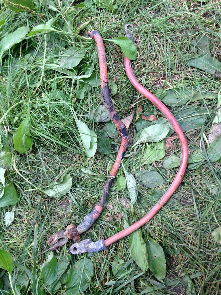

The cable that went to the starter was shot, bare wire and the end was so rotten the bolt ripped out the ends when I loosened it to get the battery out. I was rooting around my garage trying to find something else and stumbled apoun a cable the same length. Needs a new bolt but it will work for awhile. Sometimes it is nice buying acreages with sheds fully stocked with sketchy used parts. :yahoo:

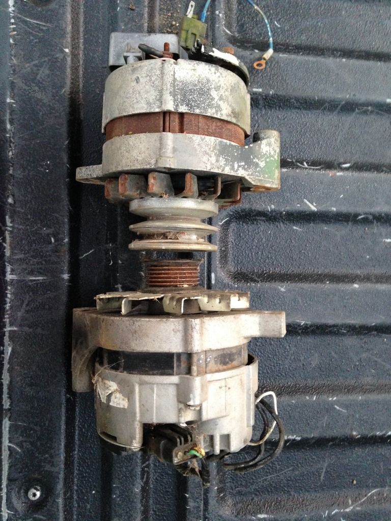

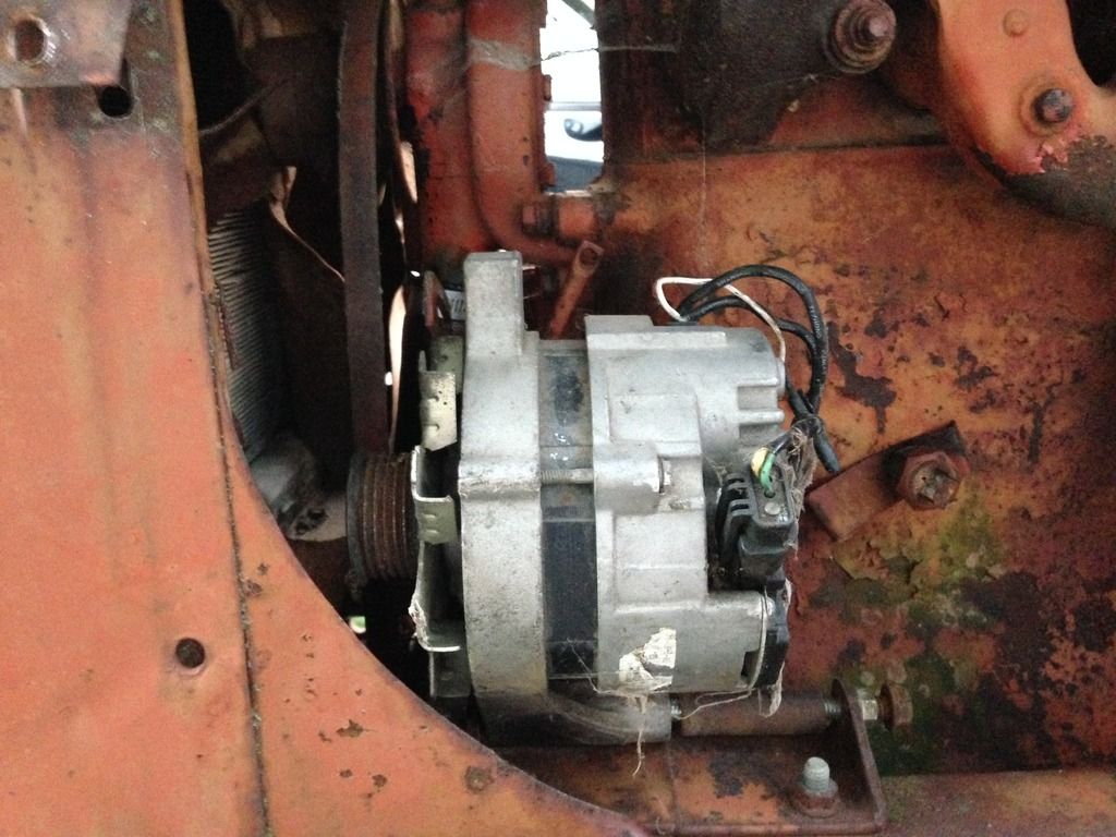

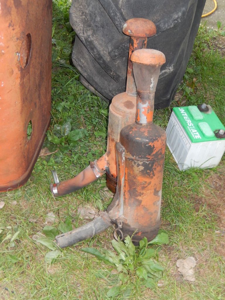

Motorola alternator was stuck, I pulled it off. Just because I have it and I know it is fairly new I am going to try to put the alternator on off of my 2.8 (internally regulated like the Motorola)
Roughly as it sits now, you can see it had a WD-45 air filter. I found a WD one in my parts stash so I don't have to have one hose crammed into another hose to fit the WD carb.

Did some digging in my parts stash:
Difference in air filters:

Oil pan is clean and ready for install. A little heat and the plug came around.

Alternator is going to take a little finesse.
Bigger than the Motorola

Hard to be real scientific with a tape measure but they are bigger than 4"... so it is overbore. :yahoo:
4.5" crankshaft too, we have a punched out 226 here. :icon_hornsup:

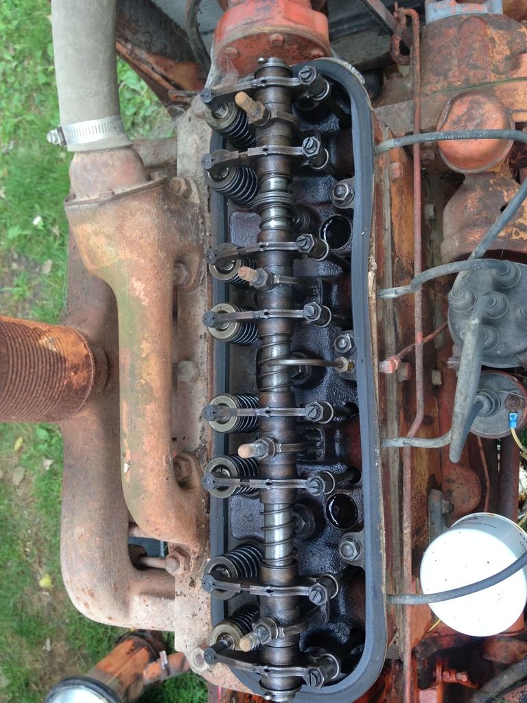

The head is off the WD, I have pics but not on my PC. Valve seats were full of trash, intake guides didn't look so hot. Valves cleaned up nicely. Need to get the head cleaned so I can get the guides put in. 4.125" bores have very little wear.

Three intake guides were cracked, all four and been knurled which dad isn't a fan of, so we put in new intake guides. Exhaust looked fine.
So I got to learn how to run dad's valve grinder. He had a slow Saturday and touched up the seats and adjusted them so the valves contacted them correctly when I wasn't there.
