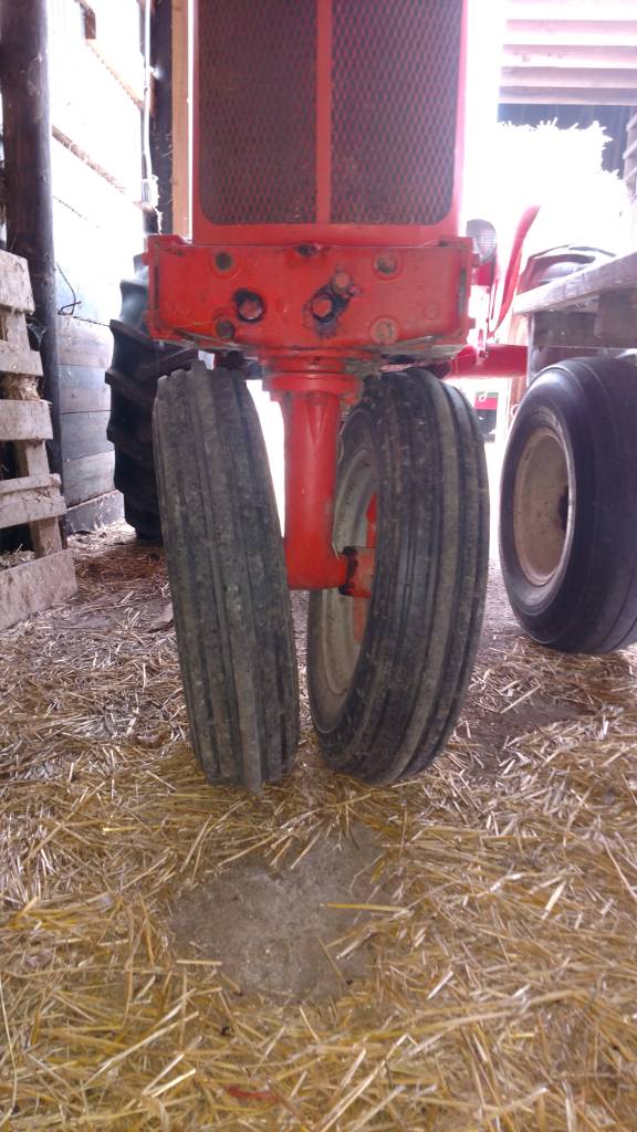

Outta get a single front wheel for it. :icon_thumby:
The tires you have are interesting though.
I think I have another one like it on some parts tractor too

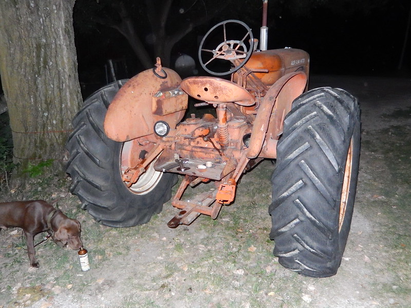

1950 A-C WD Resurection
Cleaned up the lift rams with emery cloth, hit them with penetrating oil, turned the rams back and forth with a wrench, one at a time hooked them up the rockshaft and pushed down, pulled the rockshaft up, reoiled, repeated a few times for each cylinder. Hydraulic lift works great.
Attacked the hydraulic outlet coupler, got the stupid bracket I keep getting caught on ripped off and finally got the outlet broke loose from the hold valve.
Also got the metal gear shift knob insert off, cleaned the threads on the shifter and replaced the shift knob, much nicer. Need to do the same for the PTO but I think that one is going to be a bugger.
I did notice the link going to the snap-coupler to the hydraulic pump is broken and most of it is missing... thinking we may have one on a parts tractor. Calling off the search for a headlight band as of today too, went ahead and ordered a new one so i can get lights working on the thing. We may have snow to push this year and it would be great to use the one with halogen sealed beams.
