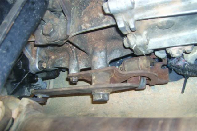

Here are some pics of what I am talking about. It all bolted up fine and nothing is bent or anything like that. I pulled the transfer case and shifter out of a Explorer with a auto trans myself this past weekend.
Here is the shifter from underneath.

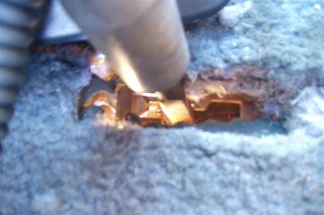

Here is the position of the shifter with the case in 2wd. It is in the position of 4h on the gate. (you can see the spave in front of the shifter where its supposed to be in 2wd)
Here it is with the case in 4 high and it is in the neutral position on the gate.

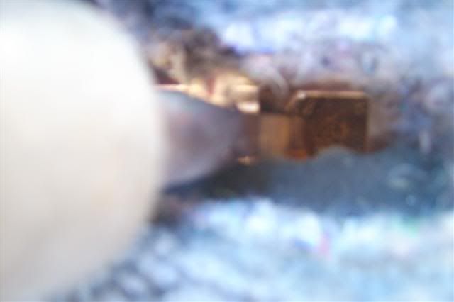

Here it is with the case in neutral and the shifter is in the 4l position on the gate.
It will not go into 4 low because the shifter is already against the gate in neutral.
There has to be 2 different shifters for the 1354 or the shifter is totally wrong somehow.
There is NO, let me repeat NO second shifter for a manual BW1354.
If you got the transfer case from an Explorer, then as long as it was the stock transfer case it is a BW1354 and the shifter is the same for a manual transmission as well.
If the transfer case has a fixed yoke on the front output, then it is a BW1354.
This is a BW1354:
I know what a 1354 is and it IS a 1354 and it is the shifter the was on it. I pulled it all out of a Explorer.
If there is only one shifter and it works on both manual and auto then why am I having the problem?
I just figured it out. I remembered the back hole where the shifter bolts to the trans was slotted and I forgot all about it. Loosened it and you can move the shifter gate into the right spot and it will go into all gears and everything fine now. Thanks for all the help guys.
I was just about to ask if you ADJUSTED it correctly...
Because the gate IS adjustable.
