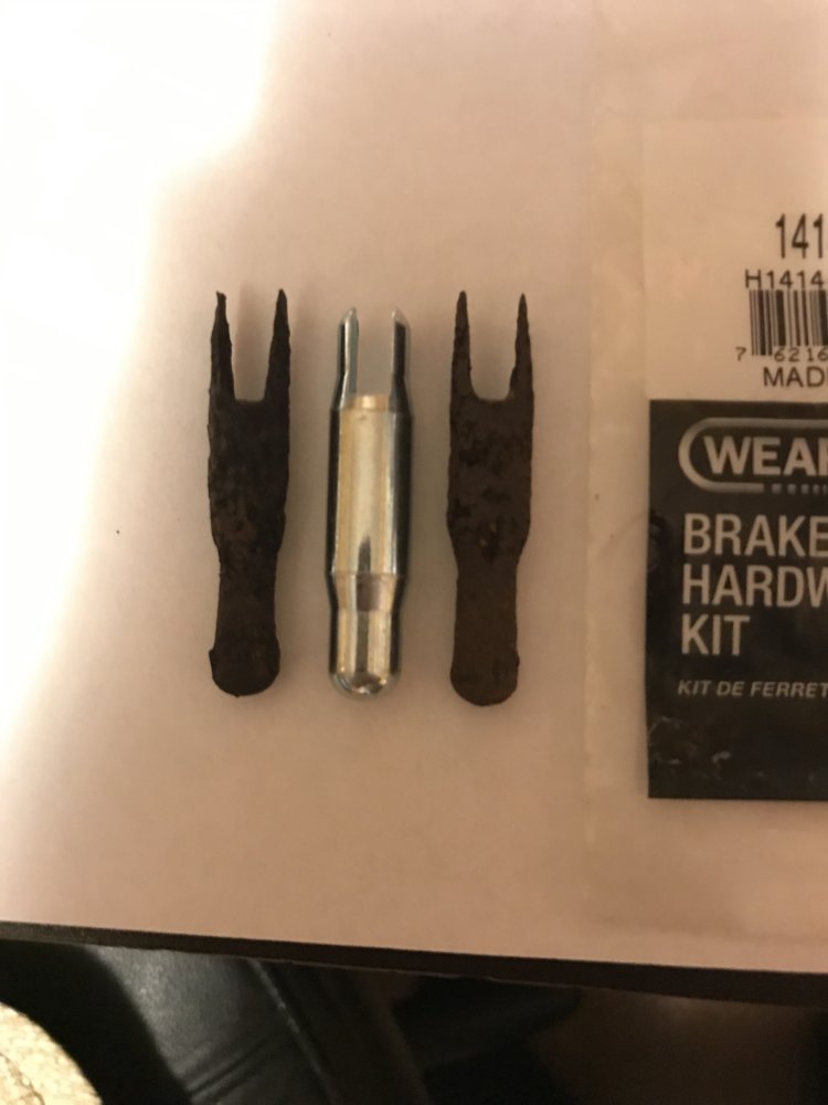

ask and 'ye shall receive,
looks close, will be a snug fit into the rubber end seal.
the slot is wider, and the seal area is not as long.
EXCELLENT!
Thanks for the pic! I would say "yes, these might work"... but it is a "might"... my pins look exactly like your crusty ones in the pic! I blasted them and put them in a lathe to emery cloth them, but they are still heavily pitted...
You cut the part number off...
Are those the 1414-2a?
yes, genuine made in China Wearever brand 1414-2a from Advance Auto Parts.
one per pack, about $6
