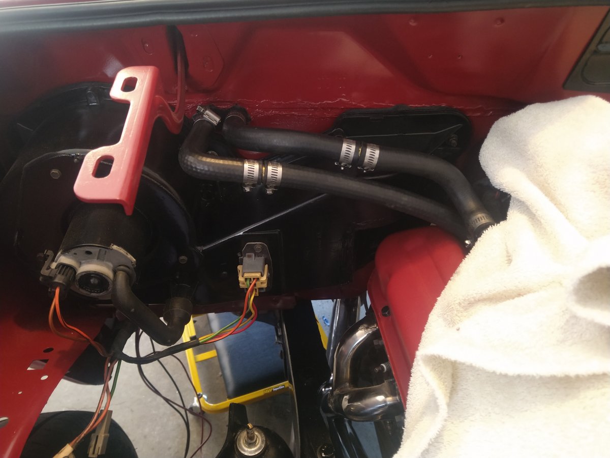

Haven't posted on this thread in a while but this where my project has gone so far.made radiator hose for upper.and heater core hoses

How'd you connect your cut radiator hoses? I used aluminum tubing (1/16" wall) and it eventually started leaking. I ended up making a bead crimping tool out of a pair of electrical crimpers from Harbor Freight. I heated the tubing and crimped beads in both ends, then sanded the beads super smooth. No leaks since..
The sleeve went in pretty snuggly.i ll be real surprised it leaks

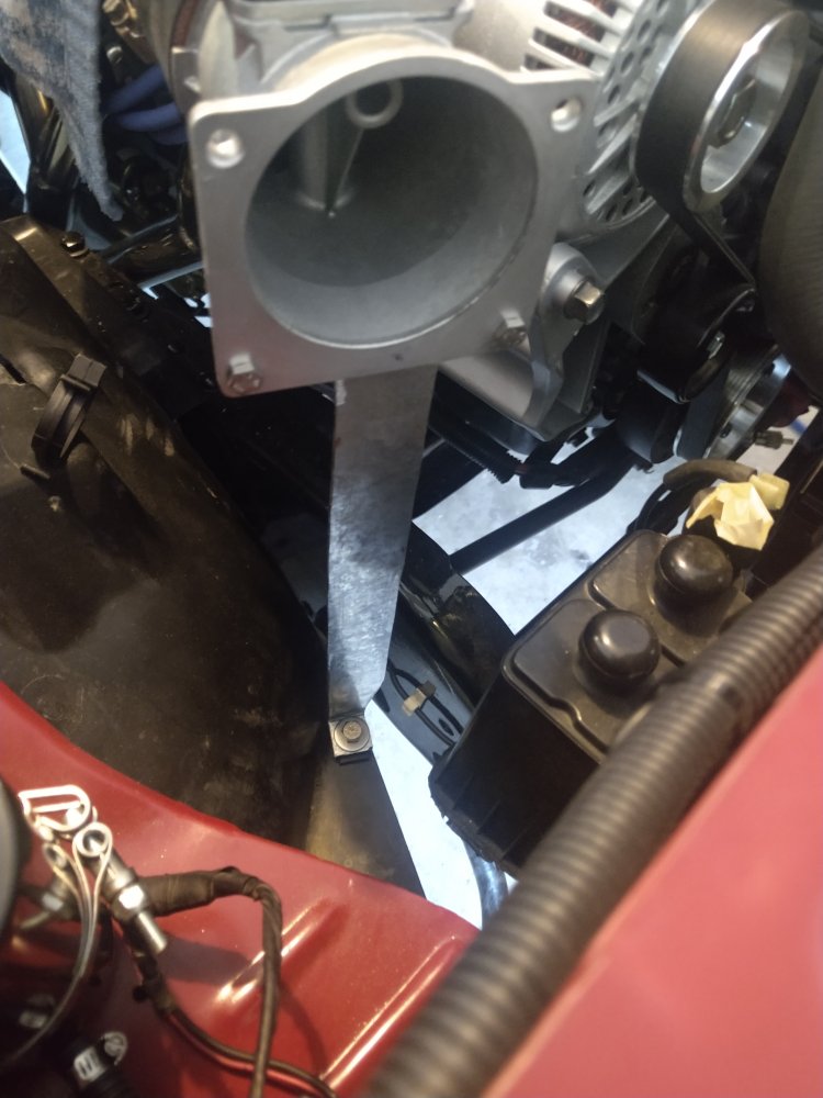

Finished making my bracket for my air intake today.a little tricky but I think it'll work.

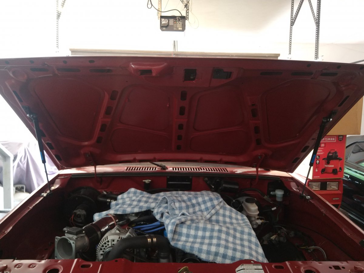

Intake completely in now fitting pretty good.i also remounted the hood.a few more things and I'll be driving this beast

I have a Crown Vic engine in my truck, had the same thing going on with the heater hoses except one went straight down into the intake on the front through the coolant temp sensor nipple and the other had that ridiculous metal mess under the intake. I eliminated that part and just ran it straight to the water pump.
I didn't want to use 5' of heater core hoses if I could help it.so I modified coolant tube.and thats what I came up with.
