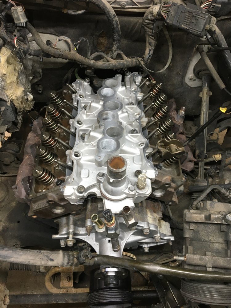

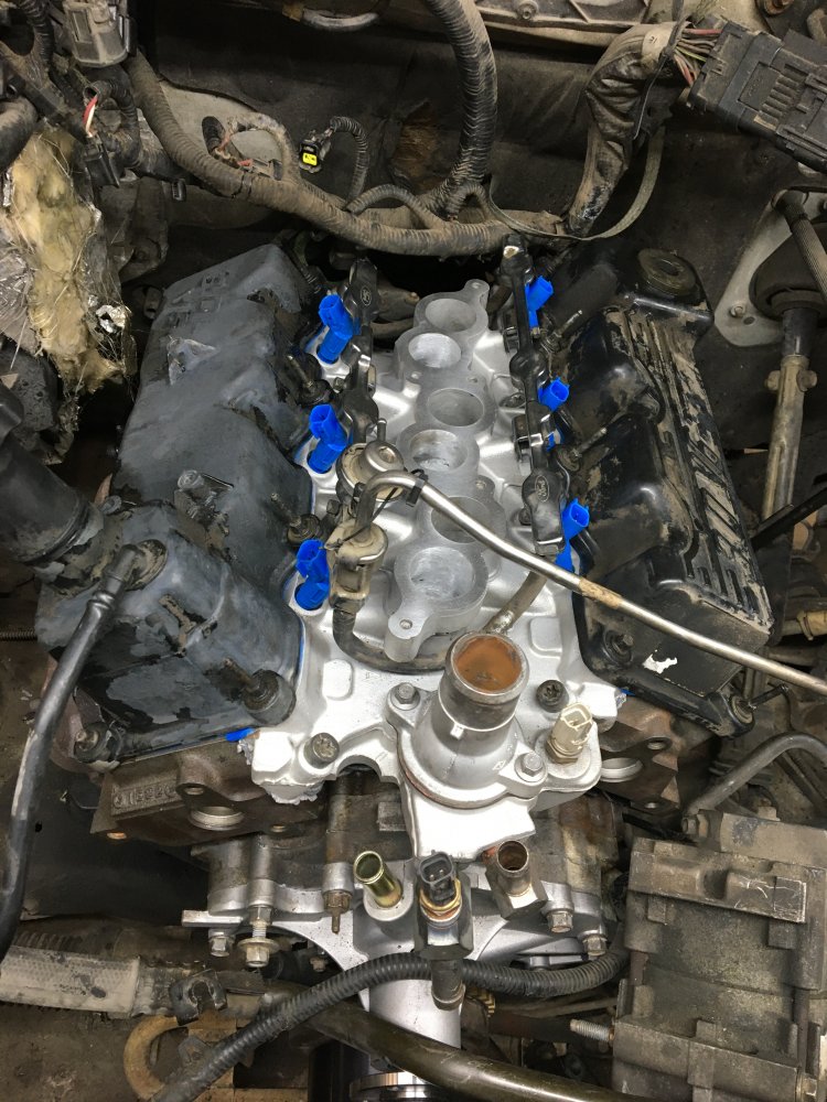

I finished porting my heads and intake and put the motor together. Initial start up was hard and truck shakes from apparent dead cylinders. I did find two different injector clips that didn't go on correctly and 5 of them that would not stay down due to broken clips. I fixed all of that (tyrap over injector clip) and it made a big improvement. I now only have #1 cylinder that is not running. I have verified voltage to the injector. I can feel the injector pulse while engine is running. I also verified the valves are opening and closing. I removed the injector and bench tested it. (good) They are all new FORD injectors.
I removed the plug and set it on the intake and looked for spark. It is yellow, doesn't look healthy. So I swapped the plug wire with another, same results. I tried a fresh plug, same results. I put that all back as it goes and pulled #2. This one has a better "looking" spark to it. My plugs and wires are 6mos old, the coil pk is an auto parts place "BLUE" pk, an upgrade from el-cheapO. It is 2 months old. Can it be that the coil is too weak to work correctly? I did also swap all of the wires from one side of the coil to the other and the problem remains as is. And last, I have a strong unburn gas smell at each startup. Thanks for any assistance.

Ran compression test, 120. Pulled valve cover and made sure we have lifter movement. Swapped coil packs and all good now. Changed the oil and drove it to work this morning. After it got well warmed up, it bucks while holding speed. Tracked that down to a PDFE sensor. I left it on the intake during bead blasting and water washing lol. Dumb move. Got one on the way.
