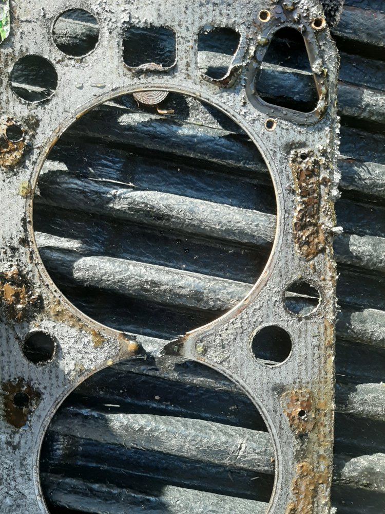

2.5L ('98-'01) Dead cylinder?
Head bolts need to be torqued!?
Damn thing still started right up and ran on only 2 cylinders... limas is tough lil bastards.
Oh and the burnt through drill mark... yea that was factory. It is the mark they put on the piston for "this side forward". It wasn't burnt through, just looked that way on the scope... :rolleyes:
Just replace the head gasket with some Red RTV and send it.
Pretty much what he said to do. He asks what other stuff it needs and I said every gasket I just removed and he goes "why can't you re-use that stuff".
I said get new head bolts too and he was confused. I dunno if the Lima engine of that era has TTY bolts but I'm not even messing around trying to re-use head bolts. It's not going back together with me doing it unless everything is replaced.
To give the kid credit he did torque all this stuff to spec, problem is he used anti-seize so you need wet spec. Everything was loose. The exhaust manifold was leaking everywhere, bolts practically came off by hand but they were "too spec".
Im sure @RonD knows but isn't lubed torque higher? I dunno I'm gonna research and make sure this thing goes back together right.

I dunno. I always lube my lug nuts and still torque them to 90 ft lbs? Either way those head bolts literally came off with a 3/8" ratchet with like no effort. They should have taken a 1/2" breaker bar... only one was tough, and it blew rust out, all the others were soaked in oil.
