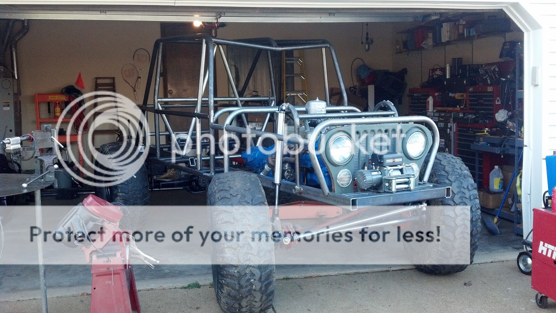

IMHO you gonna regret having the frame out past the front tires. 0* approach angle is the greatest thing you can have when offroading.
Dont get me wrong, i dont mean to nit pick, its gonna be sweet.

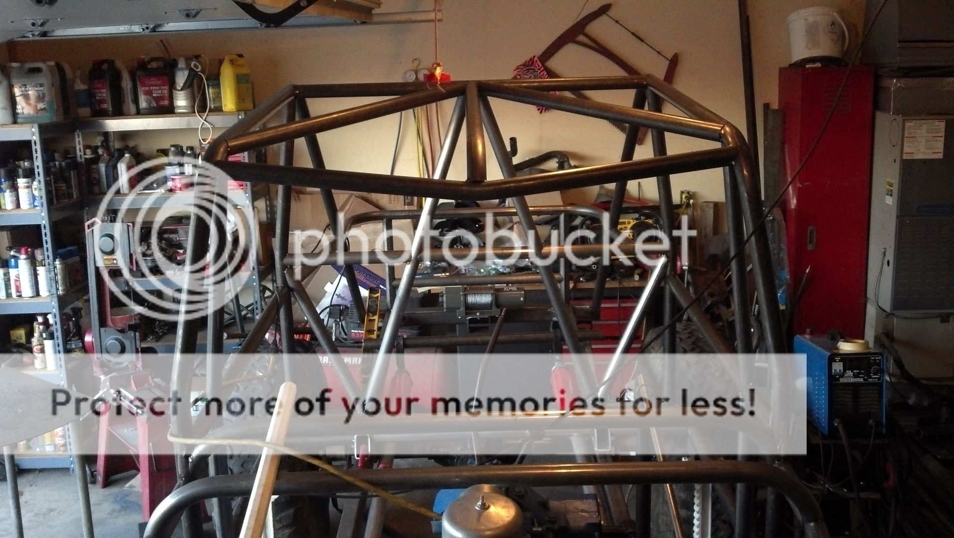

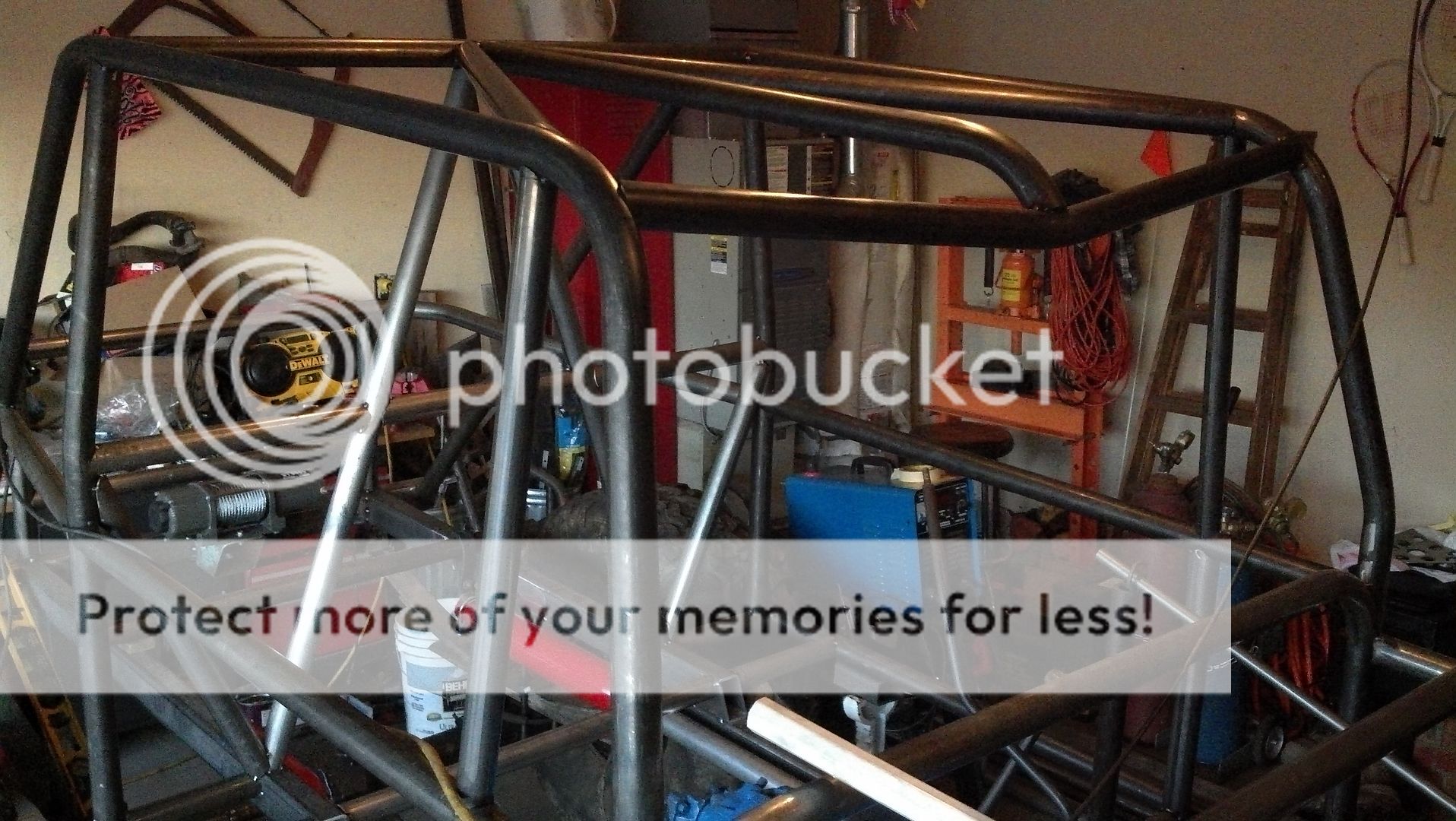

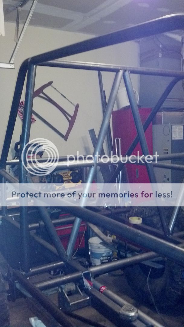

Went with an A instead of an X in the b-hoop because the x would have been right behind my head. Also had to put the harness bar higher than the sides to get a better angle on the shoulder straps.

You starting to add a lot of toob there...
SVT
Tubular! LOL
SVT
What bender and notcher are you useing?
Looks nice buddy

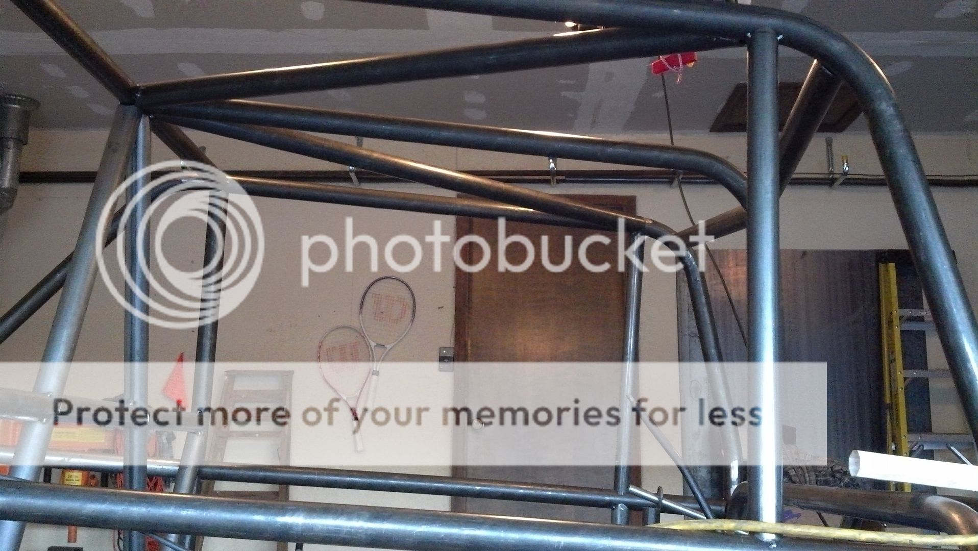

Now I dont think the roof looks high, just the cowl is lowish along with the horizontal, elbow area bar. I bet as you add more tube it will all fill in, keep up the good work.
