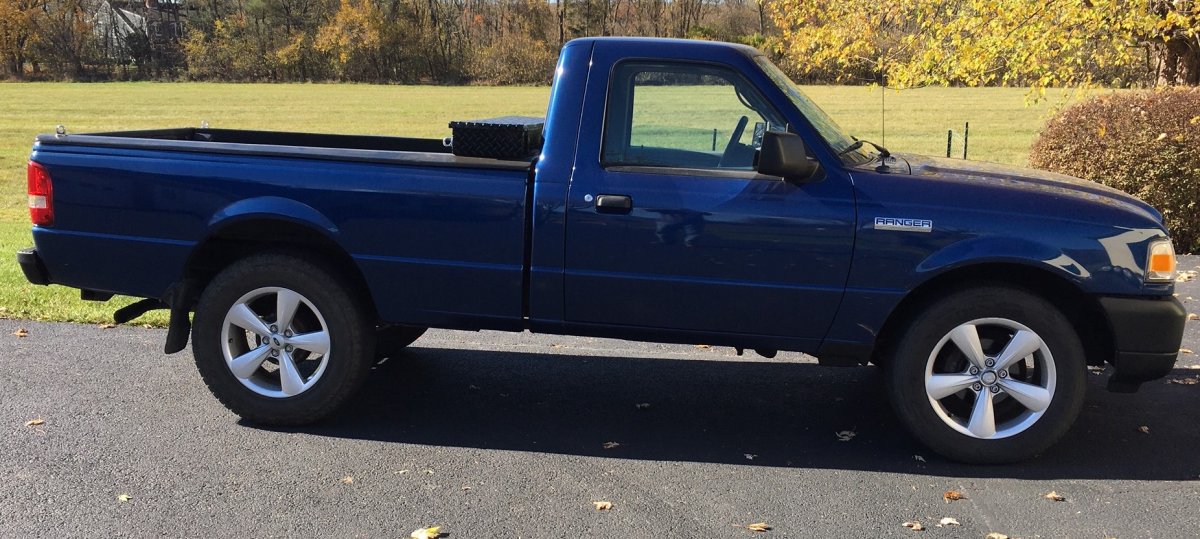

I have seen a lot of older Rangers with Mustang Wheel Packages so thought I would share a "newer" Ranger with "Newer" Mustang Wheels. For $200 (asking $325 but waited a month) got these with real good tires. Front are 235/65R18 and rear are 265/65R18. They were a direct bolt on, no spacers needed, good clearance behind them. Only issue is the front wheel caps do not fit over the axle grease caps. Raised the general height 1.5inches and raised the rear stance a bit. I run heavy duty rear springs. Kind of reminds me of the late 60s very early 70s style stance which was my teen era.

I like it. Spices it up without going overboard.
Thanks. Wanted to keep it simple with a "natural" lift and a little spiffier for $200 for wheels and tires got a "wheel" deal!
