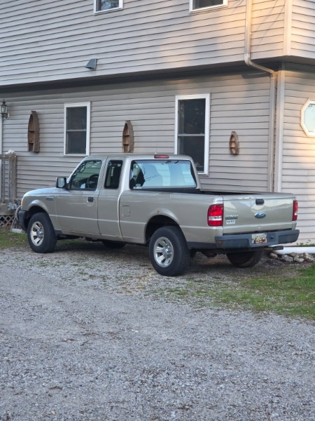

Howdy and welcome to TRS! Post up a pic or 3 of the new ride.

She aint much but should make a decent daily driver for a new driver. I have kid that should be driving about the time I get this back into shape.
