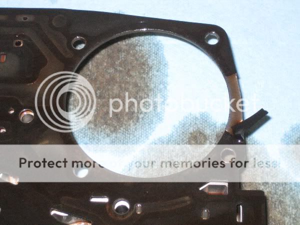

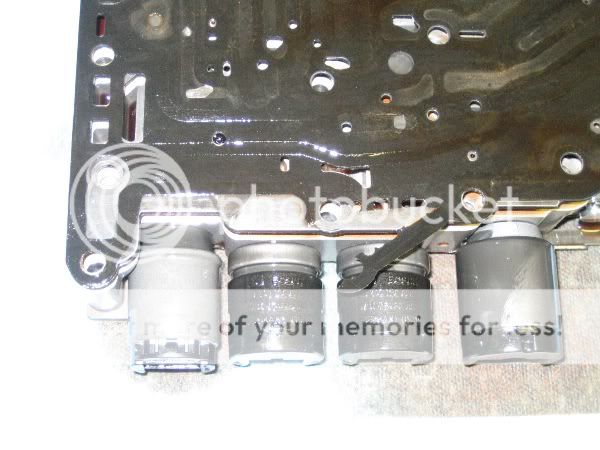

IMHO, based on your description, Lube Guard won't do anything. I think it's a valve body issue.
Like a bad gasket or something deeper?
With that low of miles, my guess is yes.
EDIT: Here's some pics I found at this link: http://www.explorerforum.com/forums/showthread.php?p=1319743
Thanks for the pics. It was my understanding that the bad gaskets were primarily a '02 and prior issue and the symptoms were flares during shifting. I haven't had a single flare the whole time I've owned the truck. I'm not arguing that this isn't the problem but I want to explore all the possibilities.
