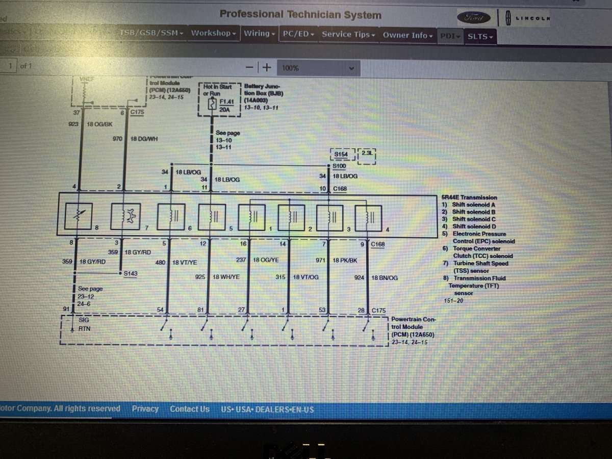

03, 2.3, 2wd.. Recently installed a Remanufactured 5R44E trans.and installed new input and output speed sensors.

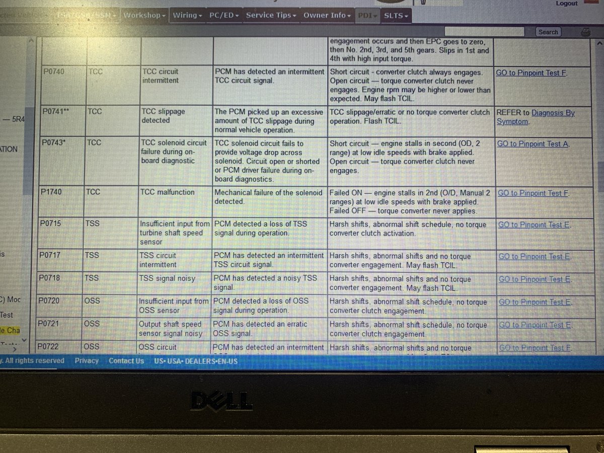

Drove it app 700 miles and the OD light started flashing. I'm getting 0715 and 0717 DTCs. I tried replacing the input sensor with another new one but still having the same issue. Any ideas as to what to do next? I've seriously about had it with this truck....
Try looking at the turbine shaft speed sensor.

It’s number 7 in the pic. Looks like a gear.
