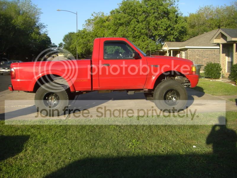

i basically have the exact same truck. 01 4.0 edge ex cab....i installed a set of fabtech spindles and the t bars were already cranked when i bought it. from stock its about 5.5 to 6 in lift...im running 32s but can easily run 33s.

I have 33x12.50s with a fabtech spindle lift no problems. I did trim fenders previously because I was running 33s with only t-crank, but doubt the trimming is necessary after the lift. My 4.10s are fine except on highway with hills.

As far as the spare and water...If offroading mainly at speed I would put the fullsize spare in the bed. But for on-road I am keeping it light, I still get 20mpg highway with the 33x12.50s.
Really is your truck a stick shift? I get 17 at the best, and I am babying it. Maybe its because you have a single cab...i hope. Haha.
