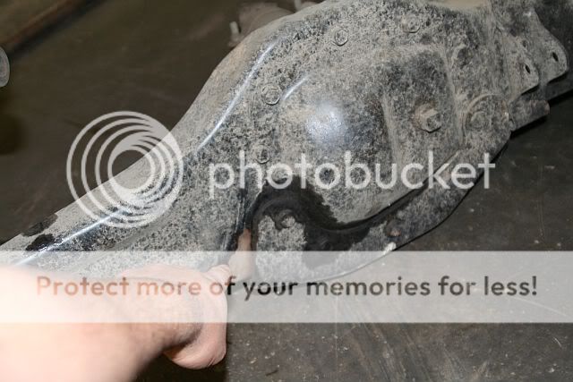

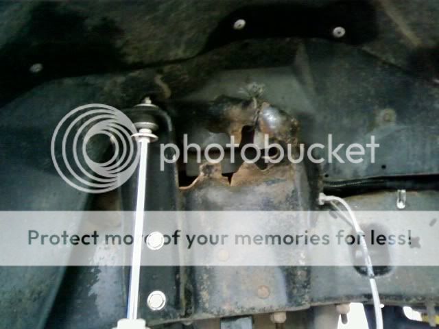

Well as some may know, I bent the front end up in my 91 ranger in August during a club annual event. The drivers side beam was bent in the middle enough that it was rubbing on the drop bracket for the passenger side beam. The coil bucket on the drivers side was starting to give out as well, the passenger side bucket bent on me a year ago sending the coil up under the hood on a trail run. I replaced that side, but never got around to the drivers side yet. Now that I have the front end out, I figured it was time to tackle it. The new buckets I'm using are from an early bronco and are much more stout. I also figured it was time to build some extended arms for it as I'm still running stockers with drop brackets. Here's some shots of the rebuild so far.

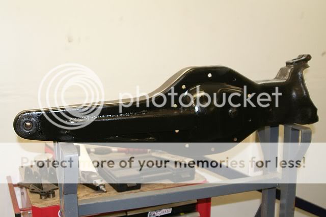

Here is the new drivers side beam with a truss welded into it to prevent any future bends here.
Here is the old beam, you can see where the paint had popped off of where it bent. I hit the diff skid plate hard on a rock and it caused the beam to bend to the side of the skid, so I know the skid is tough enough.

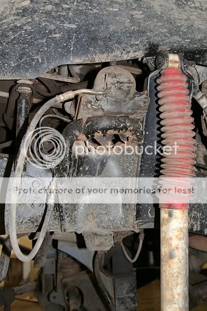

Here is the bucket that is starting to get bent/mangled up on the driver side.

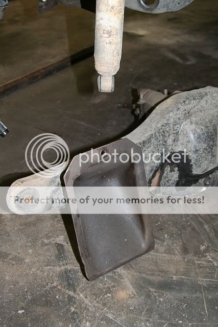

The 'new' bucket waiting to be installed

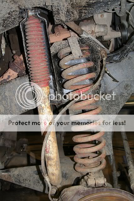

Here is what the bronco bucket looks like on the passenger side

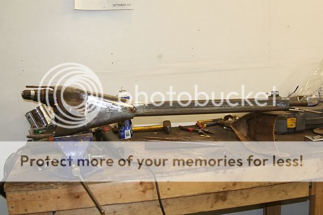

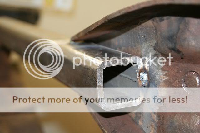

Here is the start of the new extended radius arms. I'm using 2x2 .250 wall square tube to extend them. I'm using 30" of tube for each arm. The total length of the new arms is 41". I got the drivers side all fabbed and tacked together. I built a touch of caster into the arms. Still need to come up with a transmission cross member that will have the radius arm brackets built into it.

looking good bud. You going to be running the same coils or go to something else?
i've bent a few of those arms myself.a brace is a good plan.one thing i found with the bronco buckets is they push the top of the spring out a bit further,sometimes this can mean clearance issues.
hope it all works out fine!
Same skyjacker 6" softrides for now. No money for fancy steering to go to softer coils right now.
I found the coils actually sit better and straighter with less bow in the bronco buckets. The passenger side doesn't have any clearance issues and its been that way for a year. The drivers side coil has so much bow that it rubs the tire under compression.

Got the other arm fabbed and tacked together...will post more pictures later once I get them fully welded.
The key to re-using stock buckets with the longer shock towers is to gusset them behind, weld them to the shock tower and put a piece on the front edge to keep them from folding upwards. I did the same thing only much worse on my truck before installing a kickass new set of JD buckets.

one thing that always perplexes me...is why someone would intentionally combine radius arm mounts with a tranny mount?
i am always pulling trannys....working on smashed exaust etc...whether its to clean the frogs and swamp juice from the clutches...or simply replace the overheated and cooked seals, somethings always happening.
though i am sure yours will be sectioned. i see allot that are not.

The passenger side on mine was like that when it gave out on the trail one day...it folded straight up...coil busted through my air box....fun day and a long night on the trail with a generator and mig welder piecing it back together to get it off the mountain!
Haven't come to a final idea yet for the mounts and If I will make it part of the tranny xmember or not....we shall see
