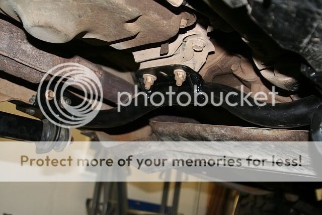

Alright...gave up on trying to reuse the factory cross member and fabbed a new one from some left over tube I had kicking around. Used my bender to get the right shape to it to clear the exhaust and front drive shaft. Got some paint on it all and as soon as its dry its time to start bolting this puzzle all together!

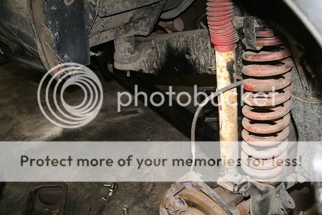

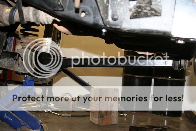

Alright...finally making some headway! Got the brackets mounted to the frame, new transmission cross member installed and the passenger side arm installed and re assembled.
Here's tonight's pics:

Oh....and has anyone had to cut the lip that hangs down on the passenger frame rail off to clear the radius arm? It looks awful close, but I don't think my current coils will compress enough for it to be an issue?!

as far as the lip is concerned....that is where my arms mounted :D
Yes...but no.
I had to cut a section out to make my passenger side bracket mount flush. :icon_thumby:
