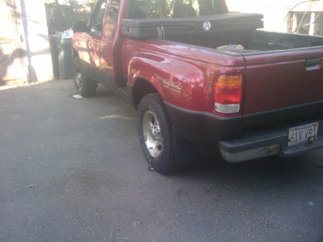

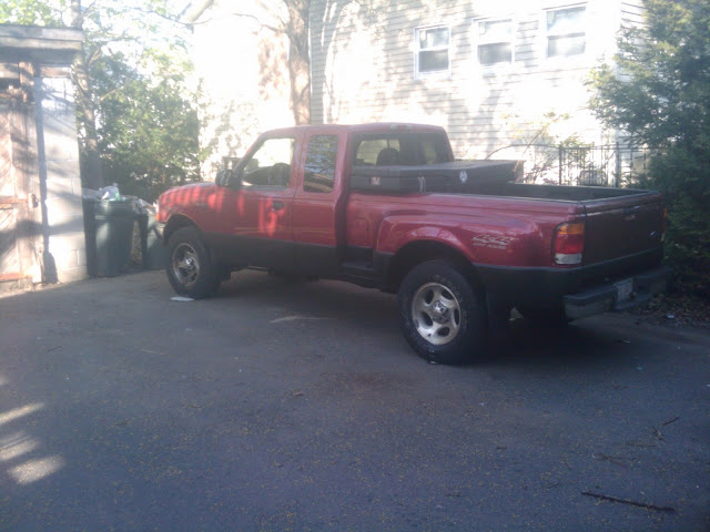

What does TRS think of my bedlining the body of my ranger? I had some problem with rust eating my rocker panels and the bottom of my doors. i sanded it down, fiberglassed it and re-sanded it. I put on a few coats of spray-on bed liner and the rest is history.
That turned out great. Nice truck by the way. btw if rust was eating away the outside of your bed you got bigger issues :) .

If you didn't unkrimp that seam along the bottom of the door and clean it all out the rust will continue to have a good time under the bedliner.
the rust is now gone and it was only on the rocker panels under the door. i cut it down to the metal and fiberglassed it. Rather than spending a few hundred to get this rig painted, I used spray on liner. This whole job cost me about 20 bucks for 2 cans or spray.
