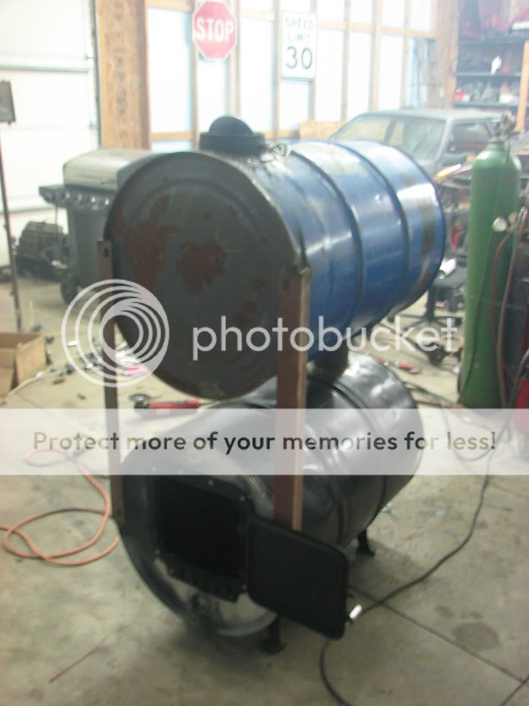

got tired of it being cold and considering they are calling for 20 degree high's for the week so i decided to get some heat going out there

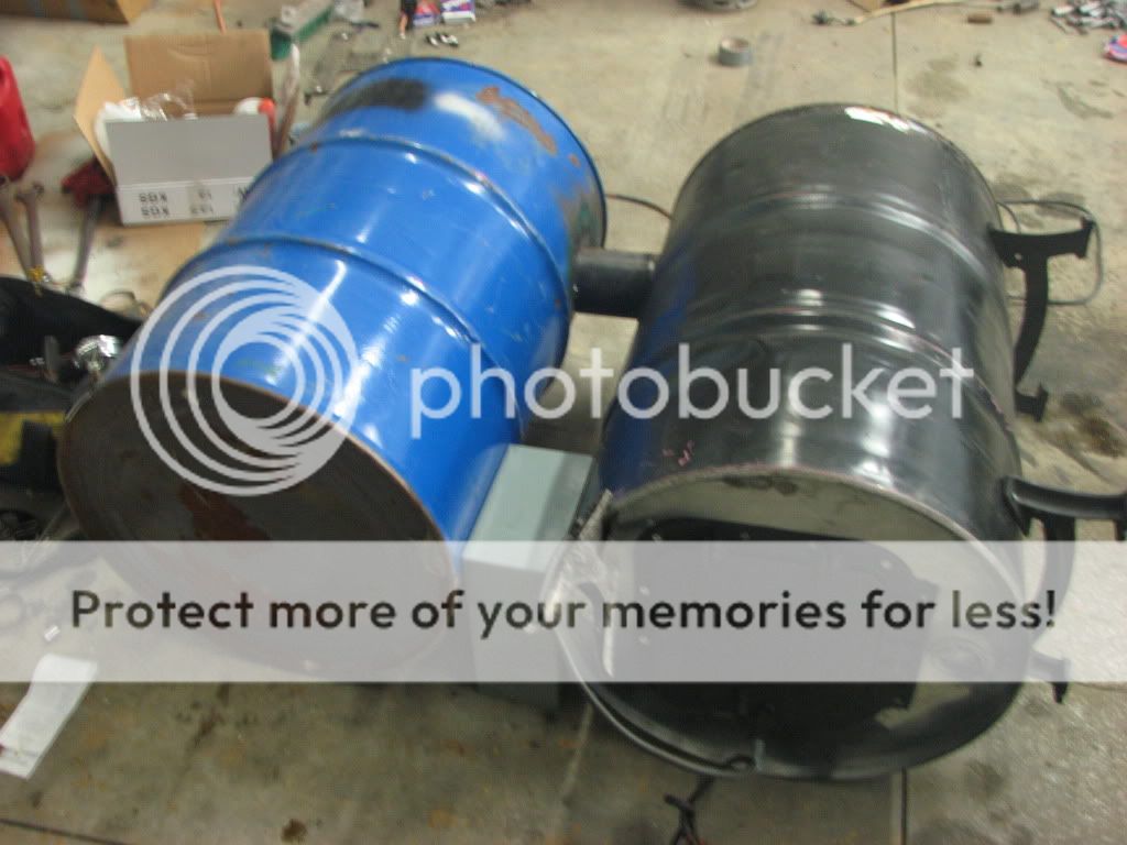

started with 2 55 gallon drums and a cast door from a local farm store

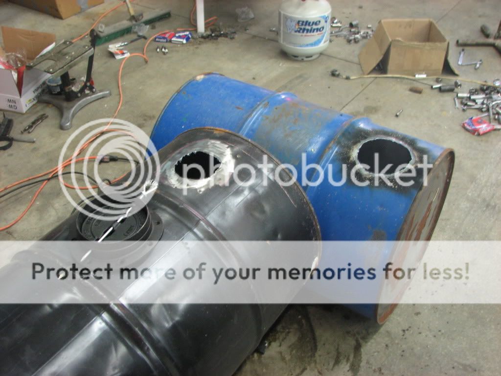

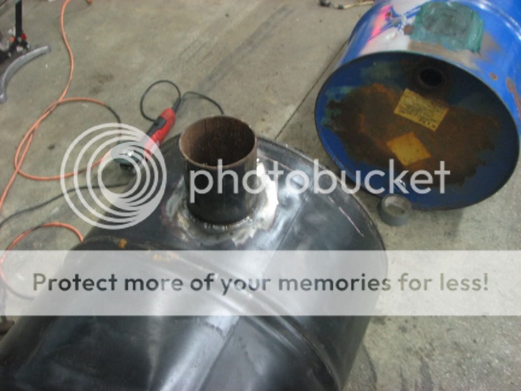

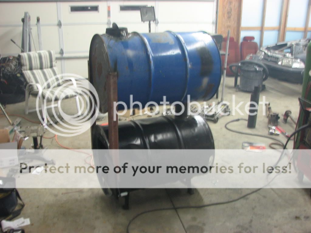

started cutting and welding and this is what i came up with

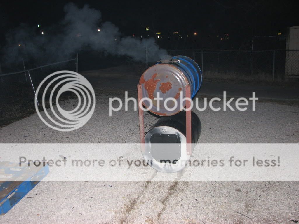

and put it out back threw some wood in to test for leaks
from what im told this thing should heat my 30x40 realll nice
btw welding on the drums suck lol they are real thin!

Here a dumb question but whats the top barrel for and whats it's suppose to do??
Top barrel recuperates heat from the exhaust. This kinda acts like a furnace. Since the fumes escaping the burn chamber is still pretty hot, having it stay a little extra time in the 2nd barrel will actually radiate more heat.
yup exactly right the top barrel is pretty much just a heatsink pulling as much heat out of the air coming out of the bottom barrel...if i had a 3rd barrel laying around i probably would have even thrown it on there but 2 was all i had
also after reading around when i put it in the garage im going to stack blocks and bricks around the bottom barrel...once the fire dies down and even after it goes out the blocks will dissioate heat that was soaked into them while it was going hot...
