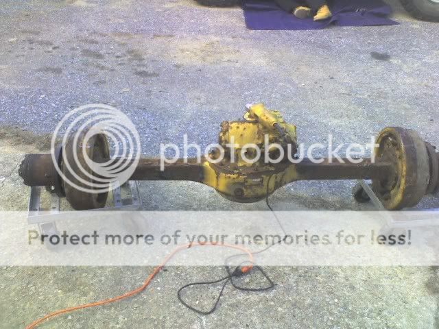

rear ready for stripping brakes blasting high clearance pan and paint
rear torn down

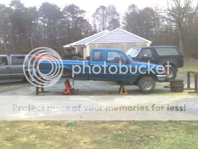

the best way to take up space in your best friends garage thanks jay!
in the beginning and yes its 2wd but not for long
