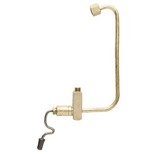

Someone on a Facebook group was asking about a regulator for a 508 and someone else posted this:
Maybe it is what you are after?
Man… that is exactly what I needed.... cause I don't anymore!
I just ordered one... lets hope they really have it. I actually found a guy on the Coleman forums that has a new one out of the package... after the holidays... I'm gonna buy that one too.
Thanks for sharing that... and good memory!

Well I got an email that said my generator shipped yesterday...
A nice little Christmas Gift for me from me!
When I got home yesterday my 508 generator was here. Took a few minutes today to clean up the stove and install the new generator. I think it works better then it ever has.
Interesting enough... the instructions on the new generator package states "After burning the first tank of fuel through your stove, TIGHTEN the packing nut 1/2 turn. This will prevent a possible fuel leak through the packing nut."
I went through the original instructions and it never said that... and sure enough that is exactly where mine failed. At least I know now. It feels good to have this stove up and running.
