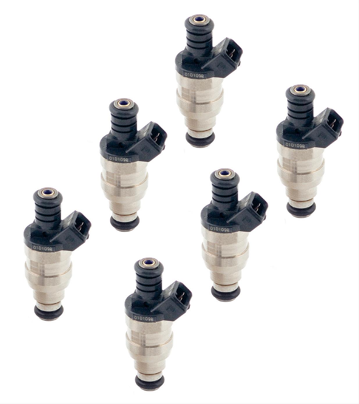

If the 4.0l has 19lbs Injectors would it increase horse power to install 24lbs Injectors?

I put v10 injecters in my stock 2.5 it helped it a lot low end and mid throttle responceEricbphoto is correct.
Increasing injector size without tuning will likely make your engine not run, or run like sh*t.
I run 24lb injectors on my 2.9, but I also have an aftermarket ECU. Injector changes for most tuning systems are 3-4 keystrokes. My ECU is set up to change the fuel map to match the volume of fuel my injectors can flow
If you do want a crisper throttle response, you can go to multiple hole injectors. May not do much for power, though. Then again, it may. Ymmv.
