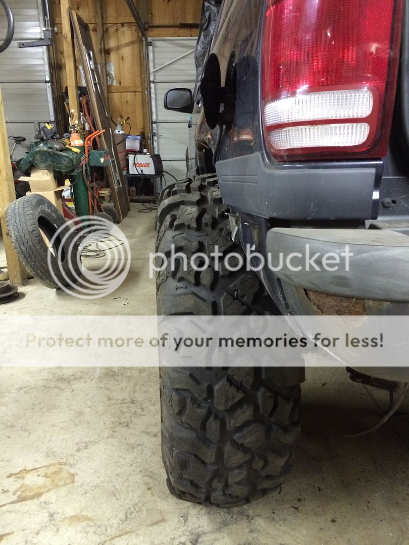

I want to see width of wheels on axle damnit

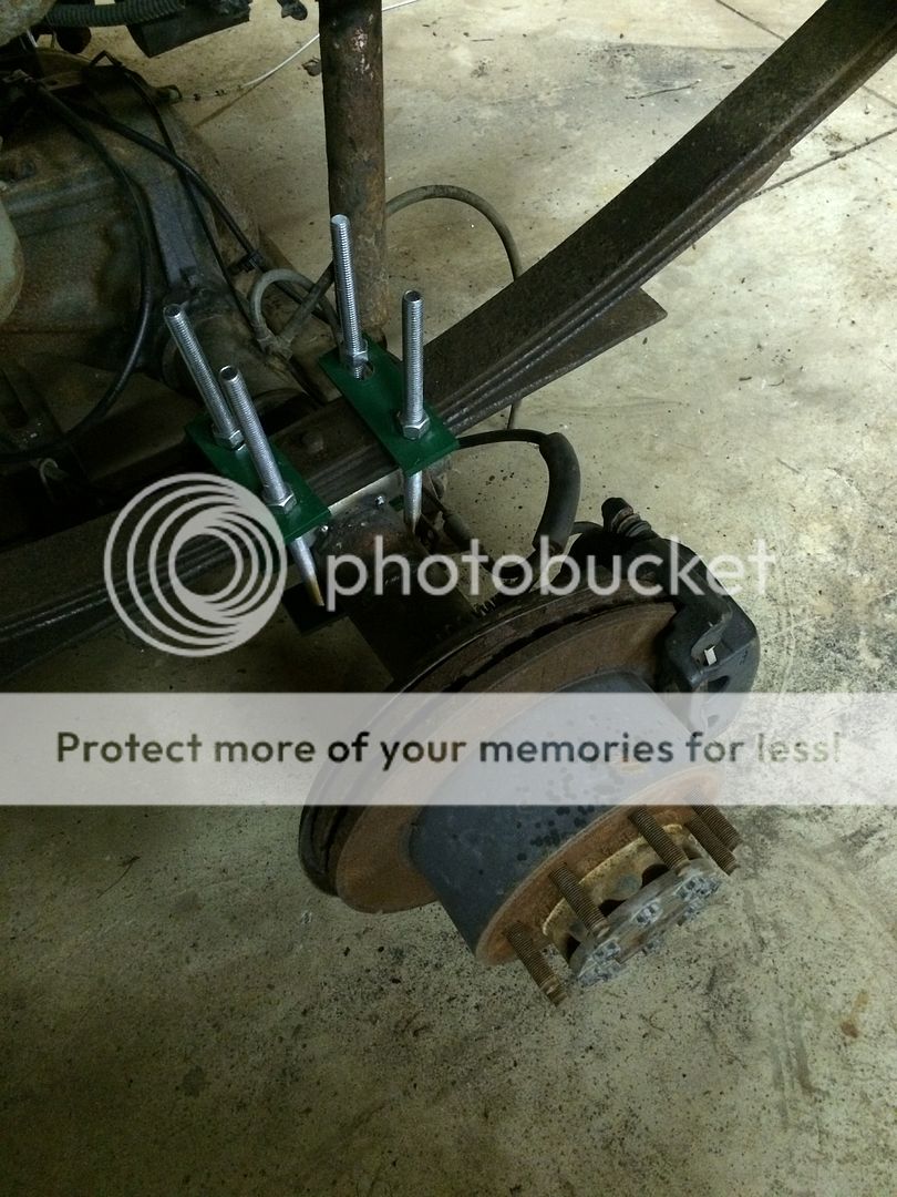

Couldn't wait. I needed to see where this thing would sit with a SOA. I tacked the perches on with a 10 deg pinion angle at this time.
Homemade "square" bolts for the time being
Going to order 10" u-bolts now that I have see how it sits.

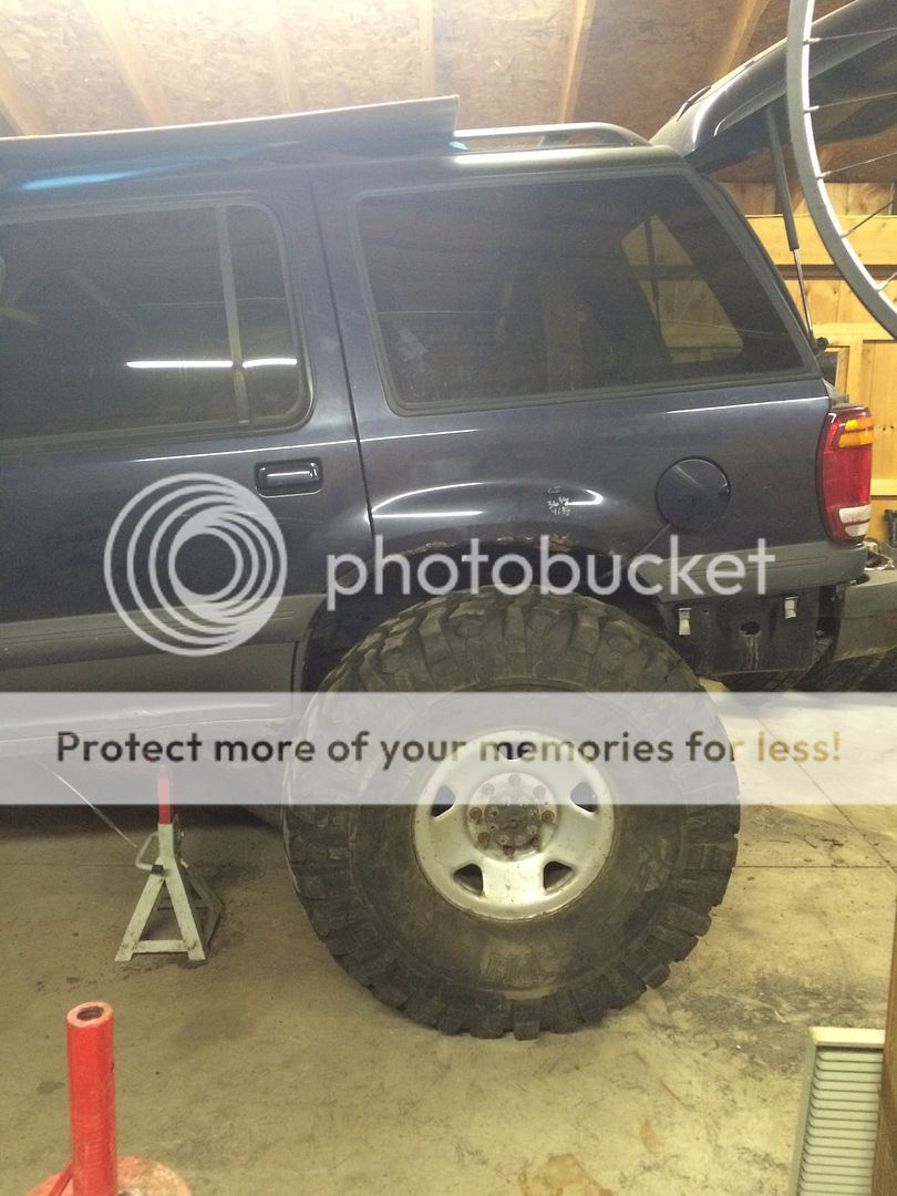

On its own weight. But no lug nuts yet lol

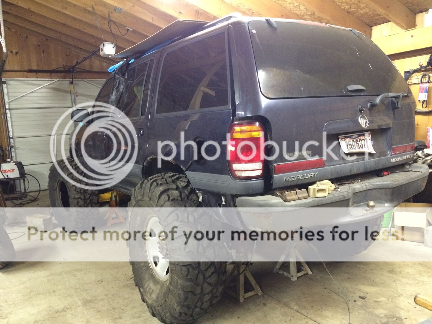

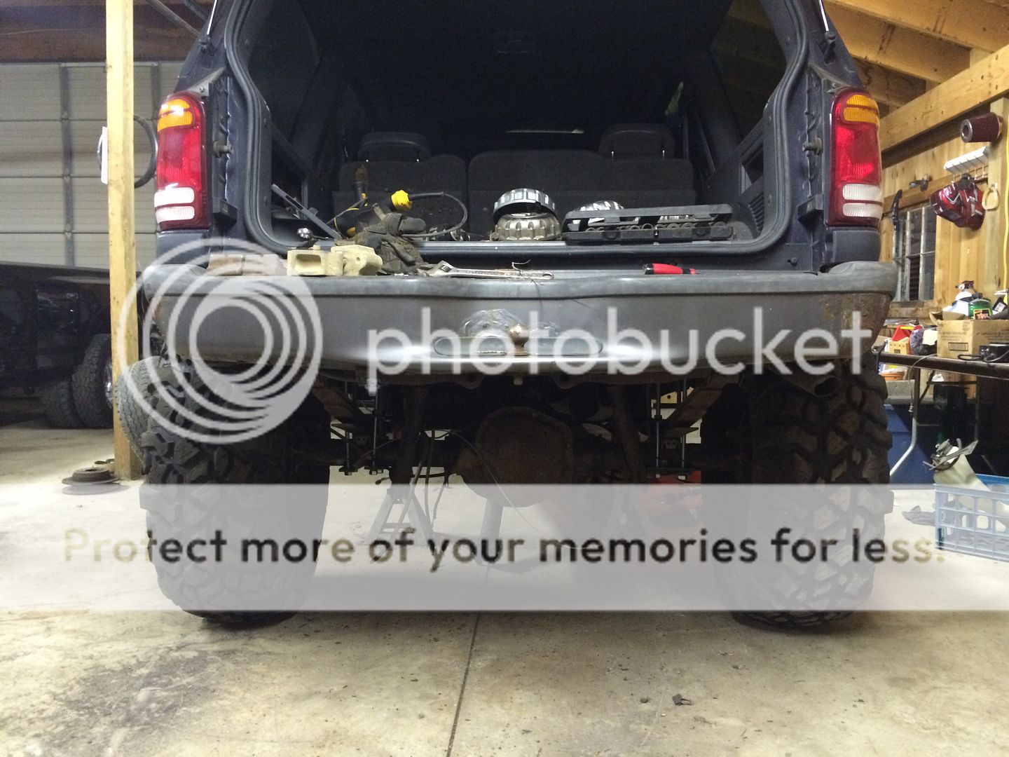

Going to move the axle back a few inches to avoid cutting too much out of the door. This is the height I want to be at depending on how I can get the front to work.
How do you plan on moving the axle? You don't have much room to move the leaf springs. Or are you going to flip the springs around?
Sent from my SM-N910T using Tapatalk
I am thinking links and coils. Just a thought at this time.
That would be your best bet. Both leaf springs on mine are very worn out. I will have to get new ones before I finish mine. The pass side main leaf has a negative arch....not good
