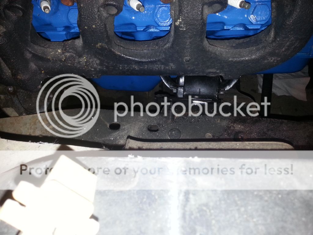

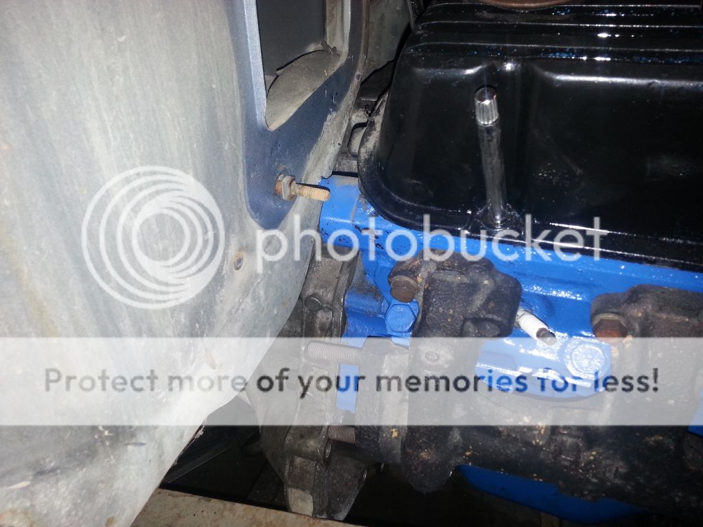

That's one of the reasons i cut out my core support. The other reason was my rad.
Sent from my rooted SPH-D710 using Tapatalk 2
I really really dont wanna cut the core support, so i managed.
Small success :icon_welder:

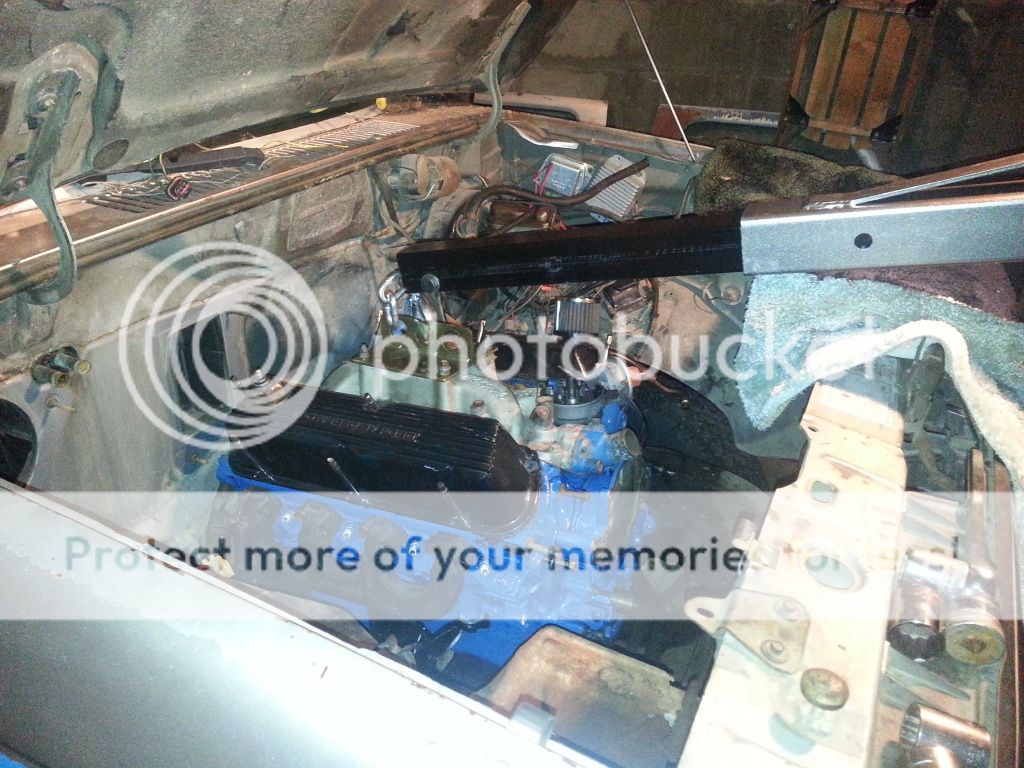

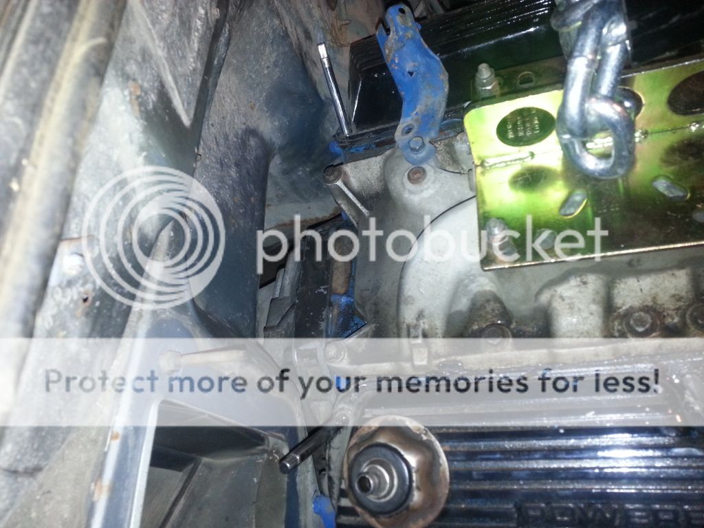

This last one is of the tranny inside the car, to me it doesn't seem like it fits as well as i was lead to believe, but it is far better than where the v8 version would have been, and that with the engine touching the firewall which is too far back. So i am going to need to cut just a tad in front of where the shifter will be.
At least you can see your trans through the factory trans hole. With mine all i saw was the spacer adaptor thing. My shifter chines out through the floor way under the dash.
