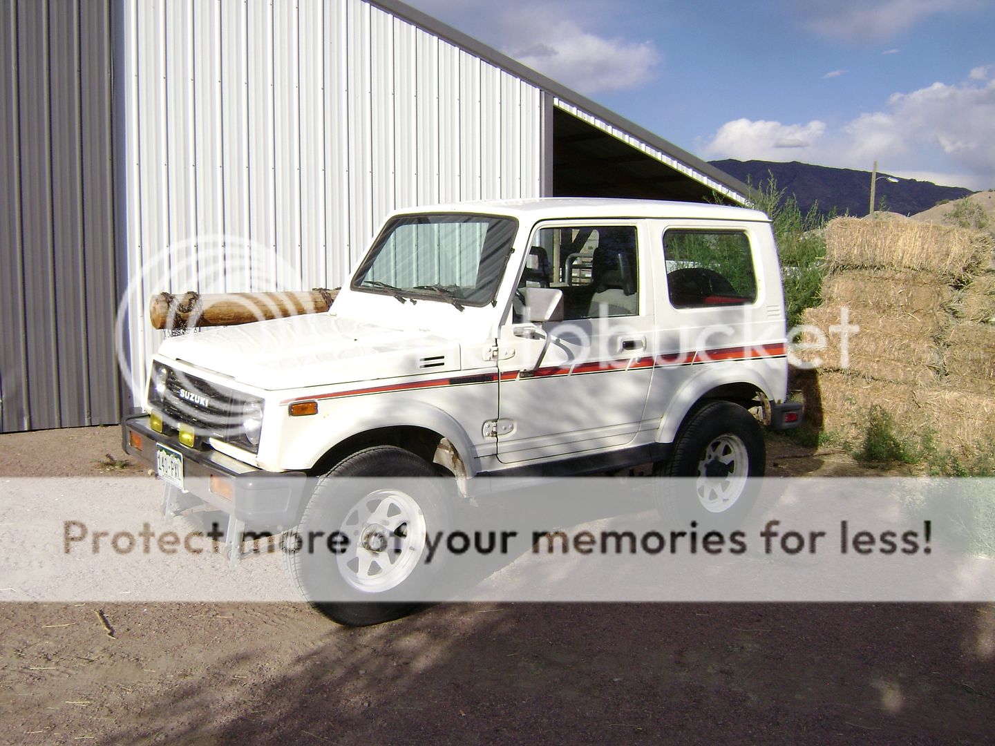

This one is a 87. I only gave 1000.00 for it originally. The one thing that really tics me off about it, is I have no dash lights and haven't really had the time to track down why.
Wow, good score....down here they would probably ask around 2800 for one that looks that nice.....:icon_surprised:

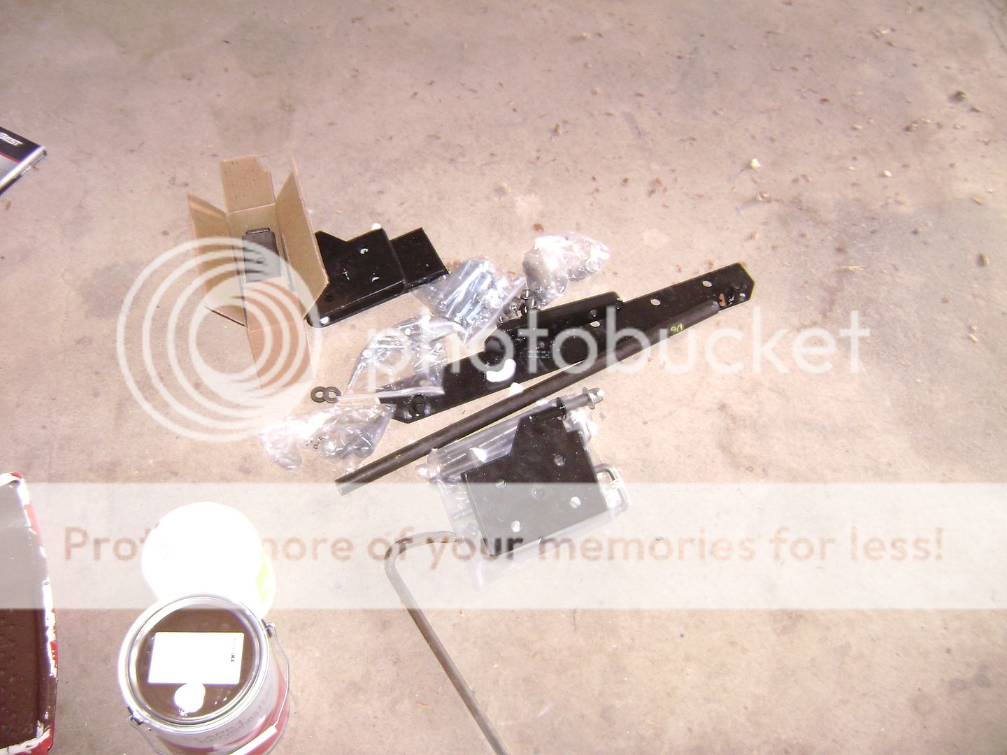

I snapped a few pics today so here they are......
Last pic is the lift kit (I'm used to big springs, RA's ETC.). No real work done on it yet (I do have it up on some Jackstands now though), maybe this week I can start on it.

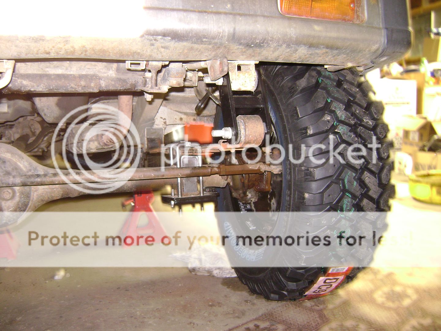

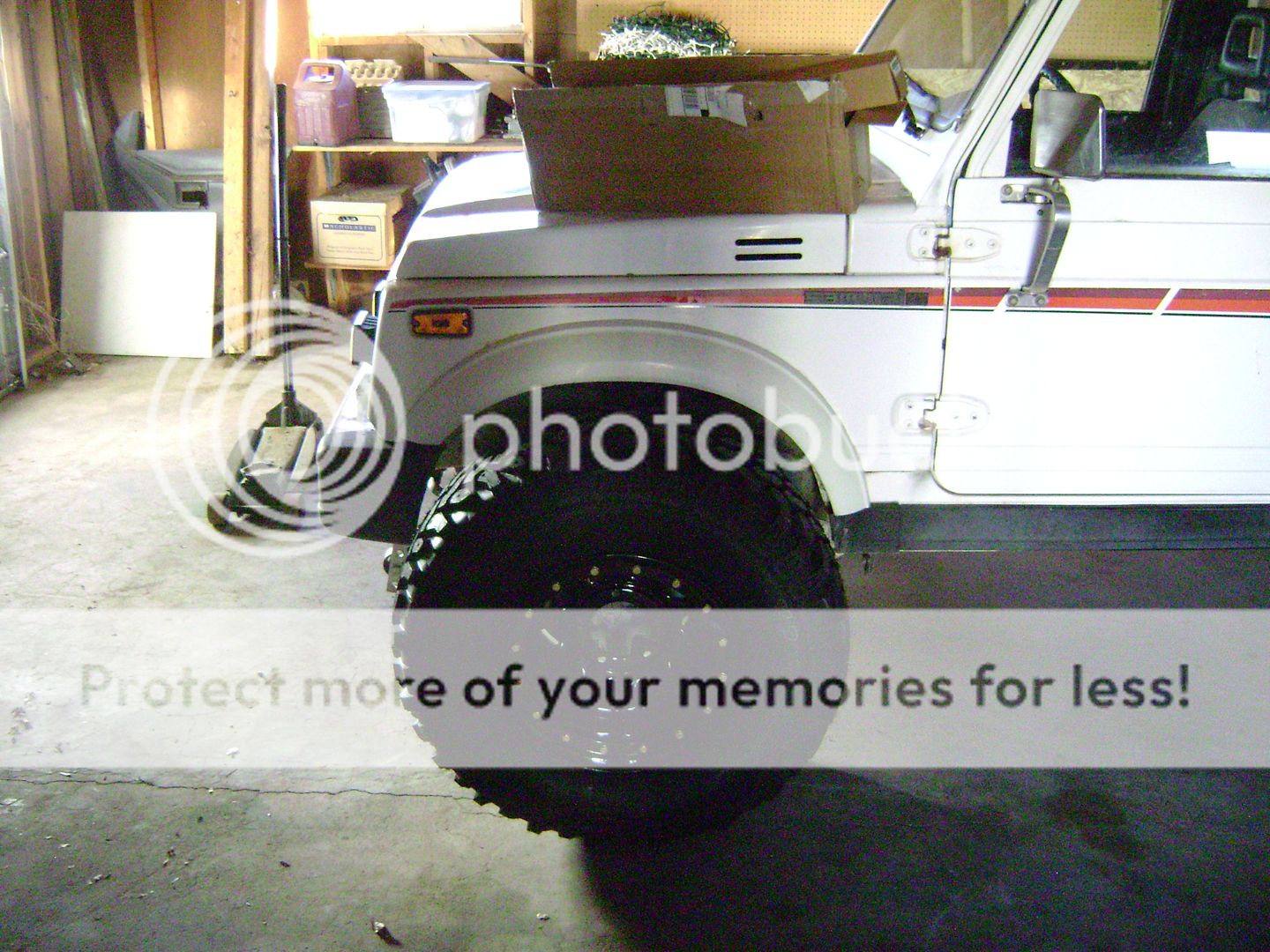

Got some more work done on the old girl tonight, and the kit I got is really coming along nicely. It would have been better if they would have included pics, but I'm managing through it. Anyway here are some progress pics......

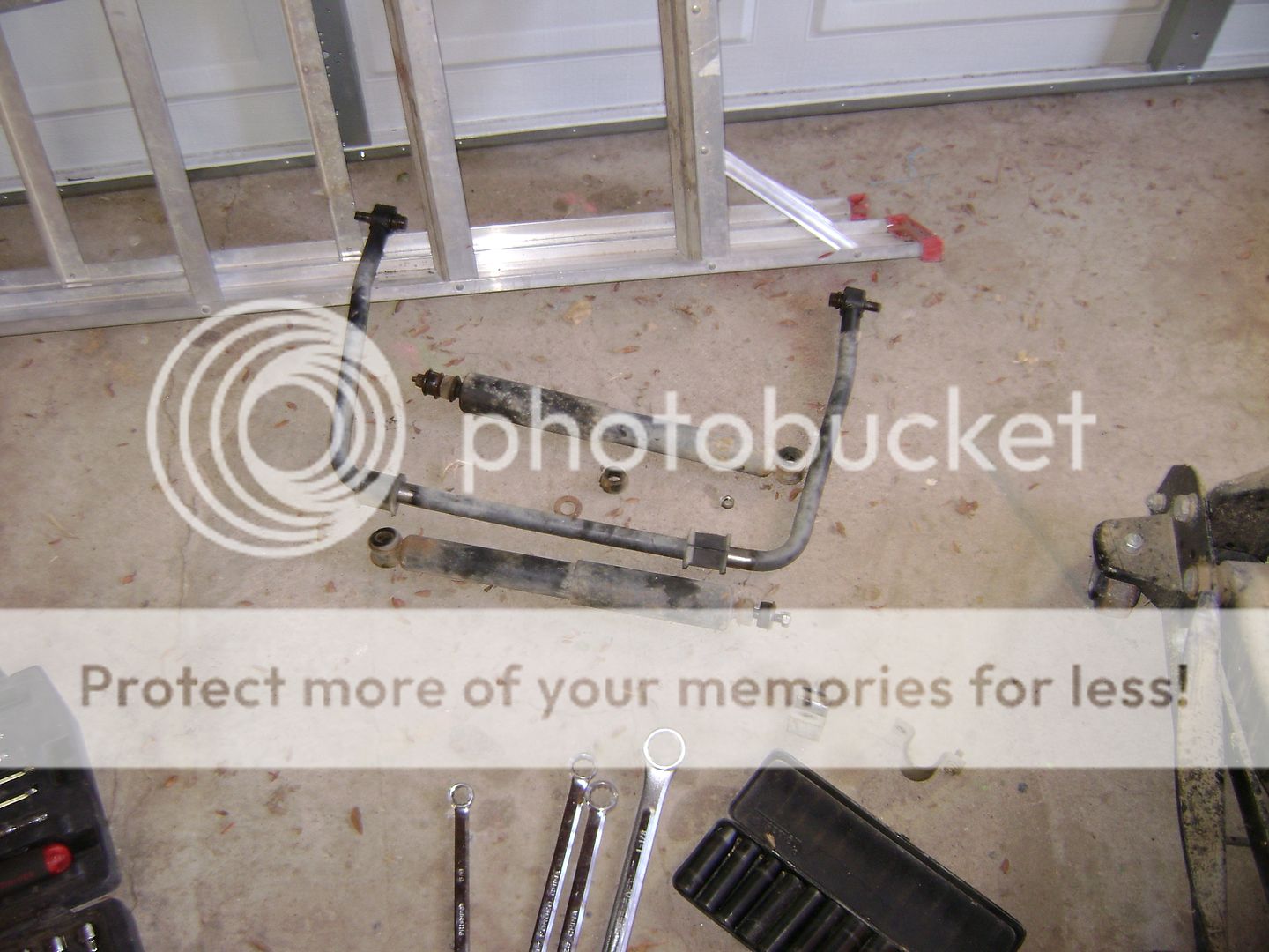

Wheel and shock off, had to take the sway bar off as well (not really needed on a vehicle with this short of wheelbase anyway.

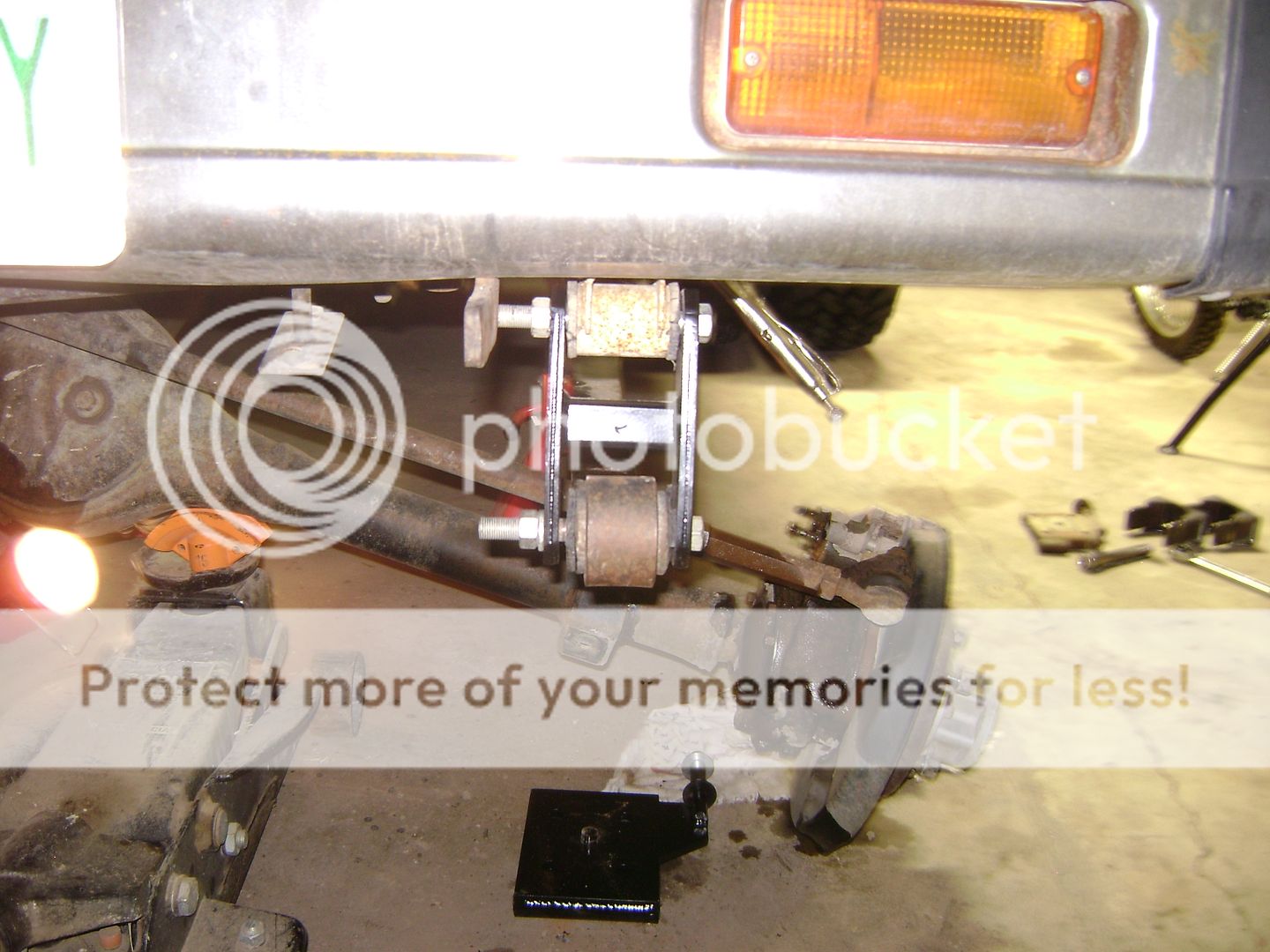

Heres one of the new shackles installed. Way nicer than the "vampire fangs" that were on it(heavier as well)

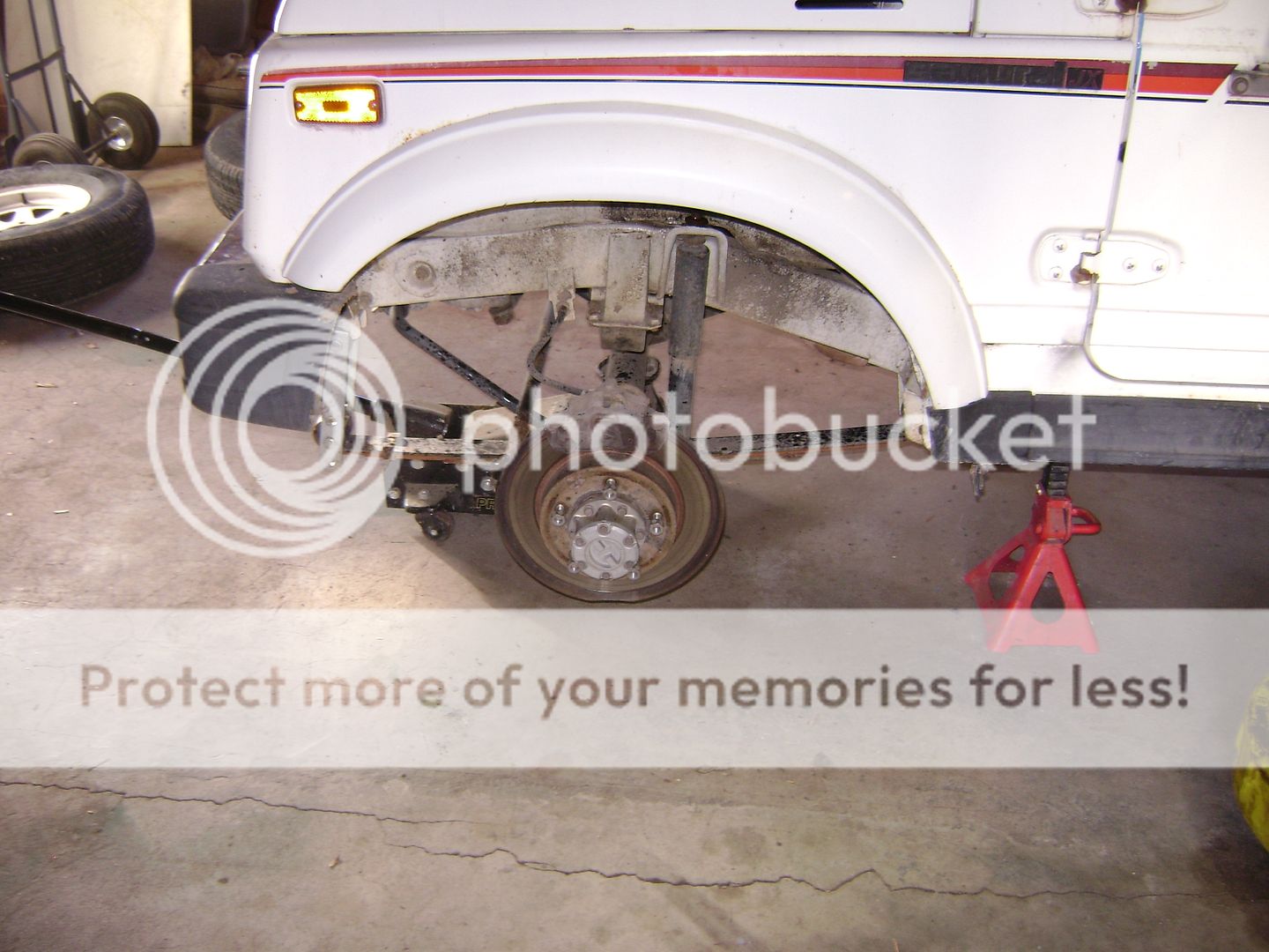

I did one side at a time. I removed the entire spring, clamped it together, removed the centering bolt/turned it around per the instructions and re-installed the spring. My girlfriend helped get the U-bolts started, and she went back together...

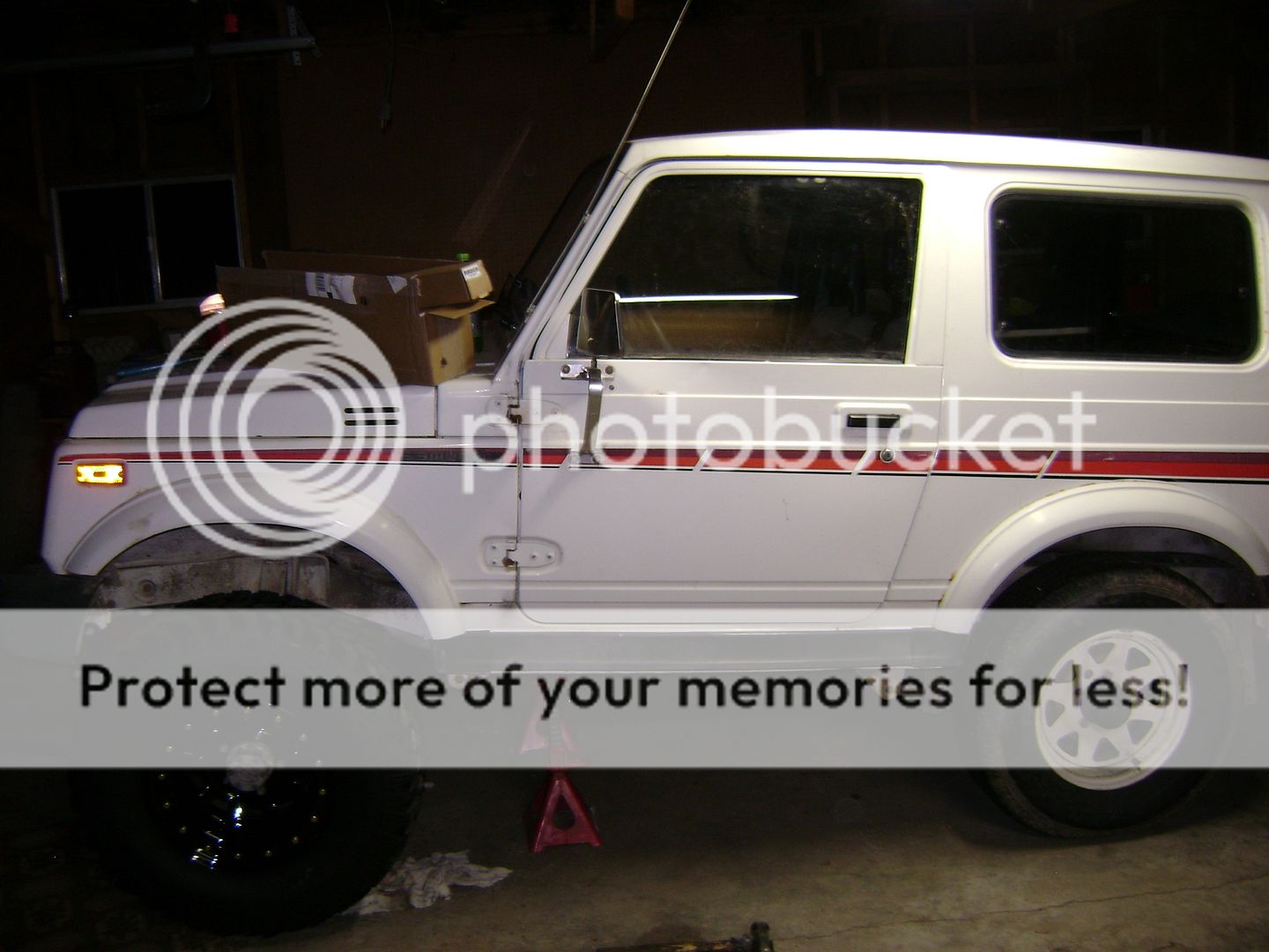

Thats how she's sitting tonight. I still have ti install the longer brake lines and the steering, but hopefully she will be mobile at the end of the week. I will run a few beads with my MIG once its driveable (new garage isn't wired for 220 yet) on the spring pads.
you cant get u-bolts that would have the threas pointed up? like a RBV rear axle. i've never been a fan of them hanging down. just something else to get hung up or have the threads ruined so you cant get them off.
