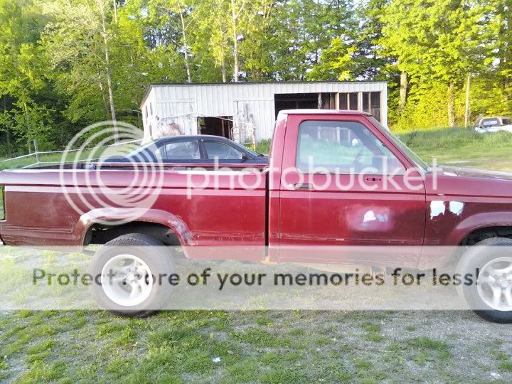

:icon_hornsup: The start: 1989 Ranger with 72k miles on it from south jersey. Picked it up with a 5.0 and AOD already in it for 2,000 bucks. Truck was solid as ive ever seen anything let alone a ranger. It was driven daily previously by a 40+ year old lady.
motor was a 92 mustang block with HO cam and e7 heads with headmann shorties and 3 inch exhaust, and a 750 carb, LOTS OF OVER KILL.

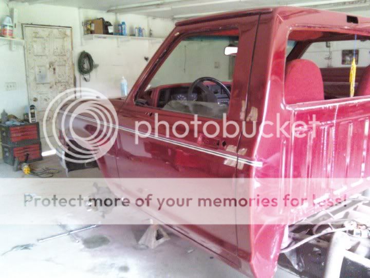

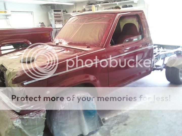

Had it for 2 months before paint work started, yes it came with those ugly rims

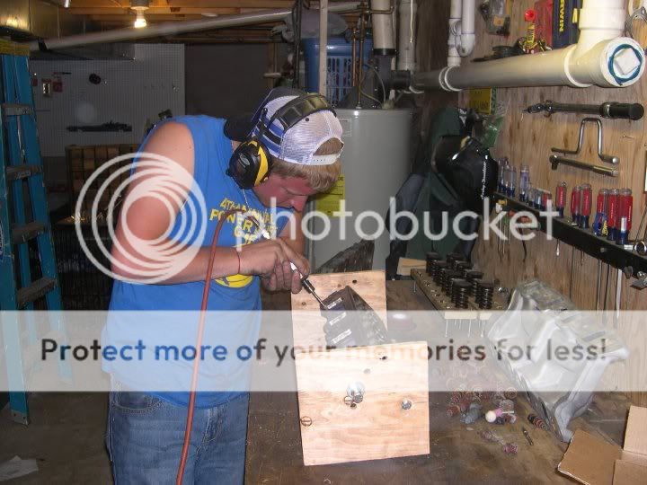

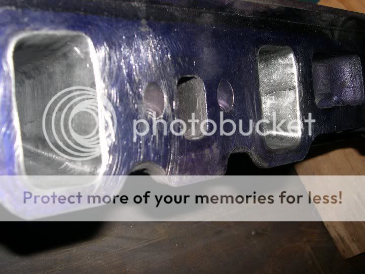

So after losts of practice on old briggs lawn mower heads, I decided to port the e7s
then did an E-303 cam ford racing lifters and a 600 cfm holley

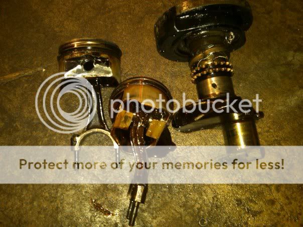

After that summer of shitty performance due to no stall in the aod and heads that didnt flow enough for the cam...... O and the fact that the crank snapped and split block plus two rods :thefinger:

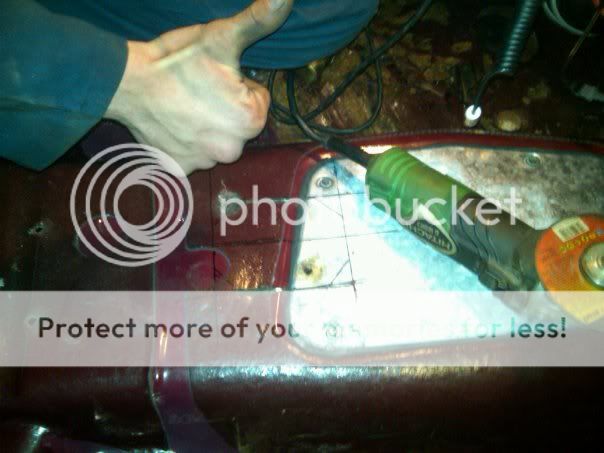

Install of t5 and removal of the old auto stuff underwent cut hole in the floor for shifter (hurst short throw) and pedal install.

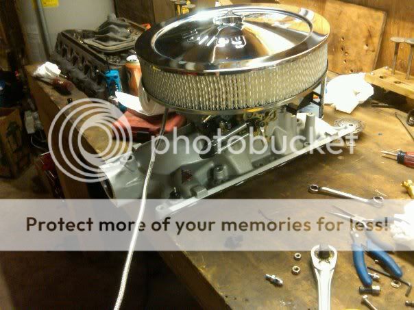

Then ported the gt40s and bought FMS double valve spring to allow for the e-cam to work correctly. I re-barringed the whole motor and honed the cylinders, the thing was CLEAN!!!!!!
Bought a zoom clutch, weiand intake, and pro bilet distrib and new msd box as well.

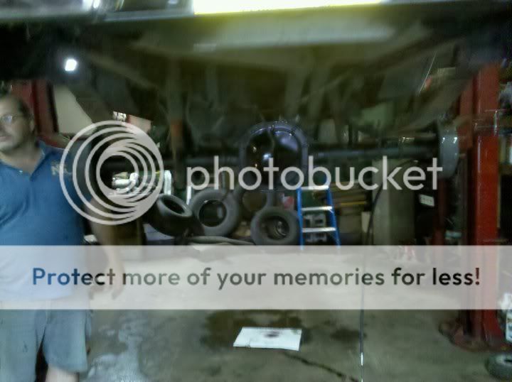

Then it was time to say goodbye to the 7.5 for another good deal at that same yard got whole thing for 40 bucks. 8.8 373 and trac loc.
Then installed it all and got it tuned :icon_welder:

Thanks alot man! Thinking I should take that pin stripe off what do you guys think?
Looks good, but please please lower the back like 12 inchs it looks like my 4x4 ranger
I know. :-( its got a 3 inch body lift from last owner YUCK! BUT the body mounts are here so it comes down in next couple months

Nice rig dude. For some reason I thought you had GT40P heads from another thread.

Forgot to comment on those busted parts, the crank and rods... love the shop carnage. I have a "wall of shame" in my shop with thrown rods and all kinds of other cool broken stuff...
Looks good though!
Thanks man. And no gt40 irons non-p that after porting 4 sets of e7s I ported them myself and had good results.
Lol ya it went boom! U can tell y. There now part of a "redneck windchim" that has my parts a buddies 440 6 pack runner bent push rods and another blown up SBC. As a little reminder of hi revs on tired motor doesn't go well
