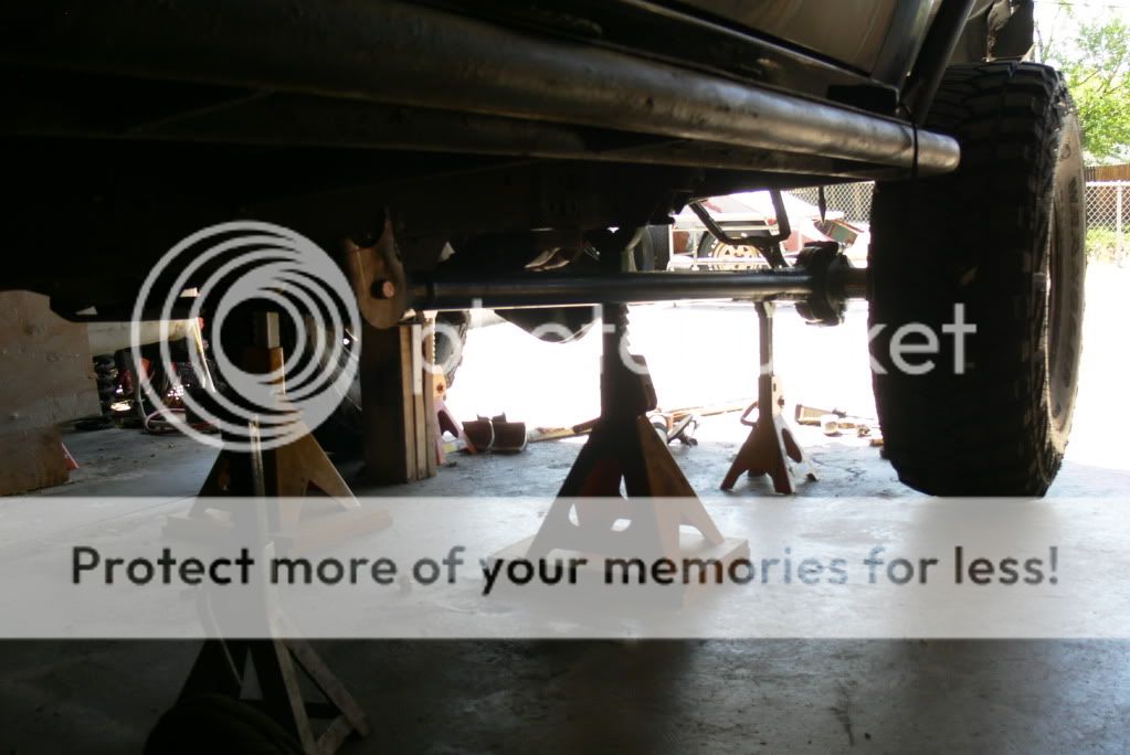

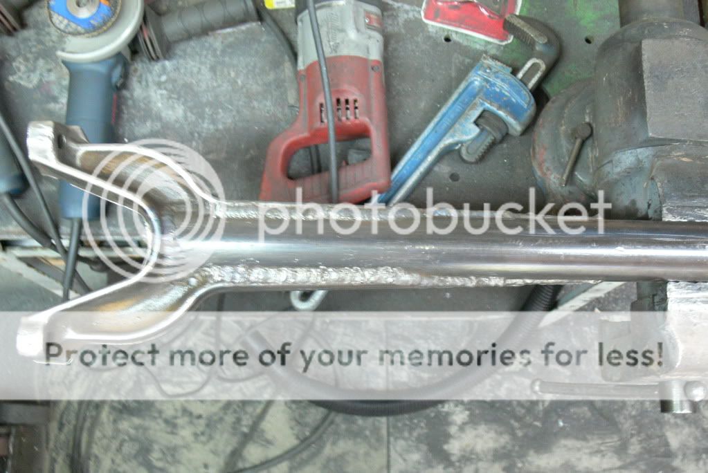

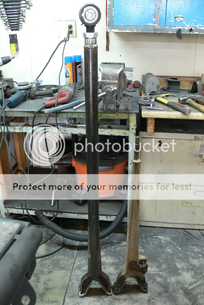

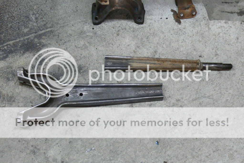

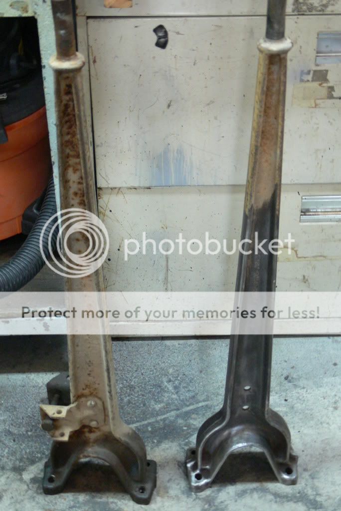

Well plans changed and I lengthened the arms and used Creeper Joints on them bought some mounts from Ballistic Fab since I did not have time to fab them myself nor did I feel up to it. Here is a couple shots of the arms. The tubes are 1-1/2"I.D.x1/4" wall DOM.

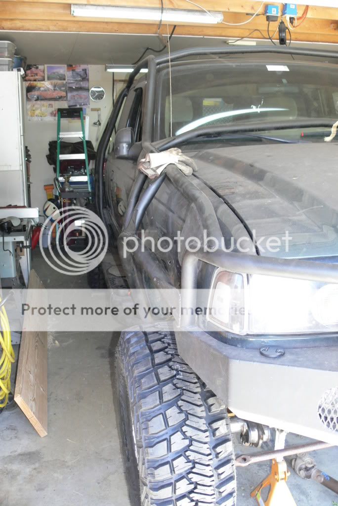

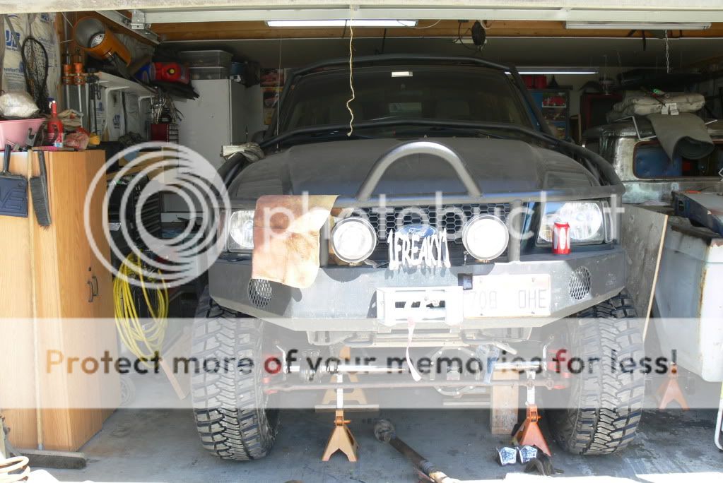

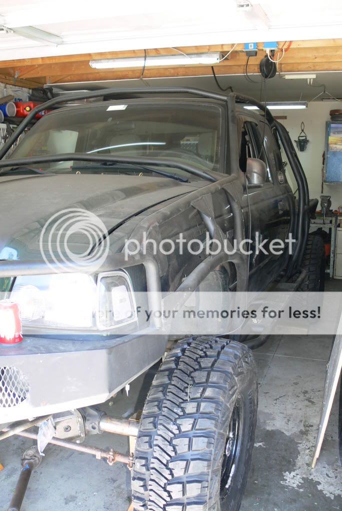

Ok here is the pics with tires on it, and how the longer radius arms look done up

The last 2 day presented a couple of challenges but I got it worked out.

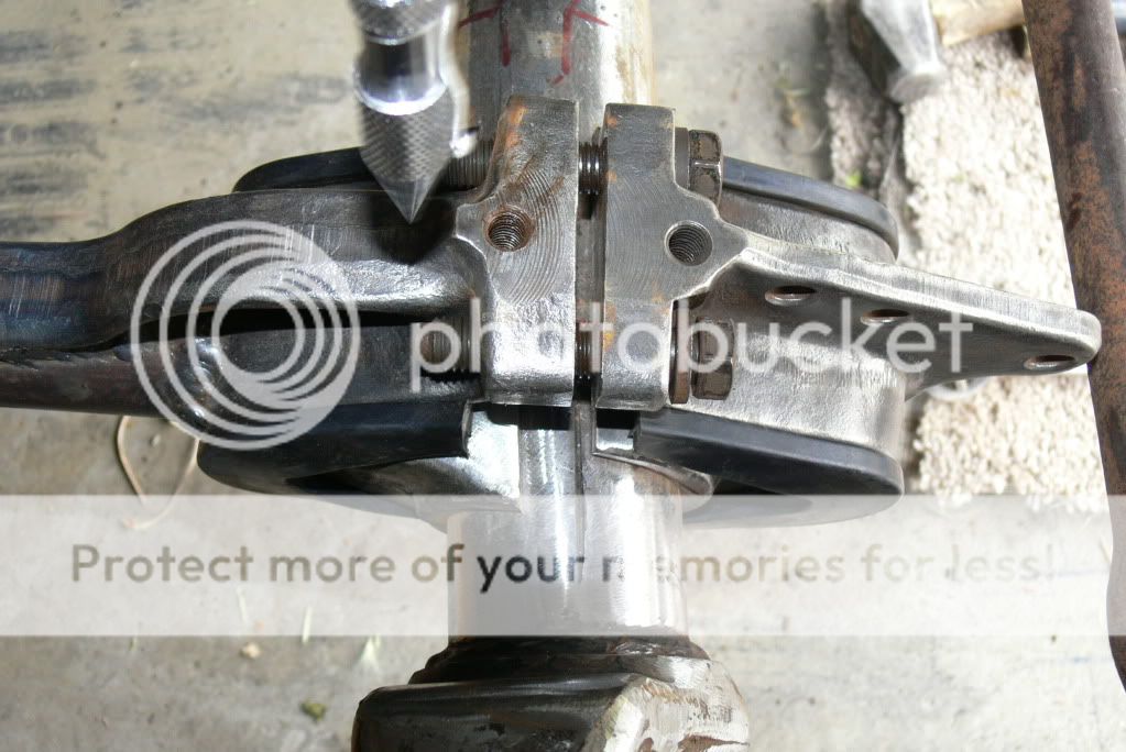

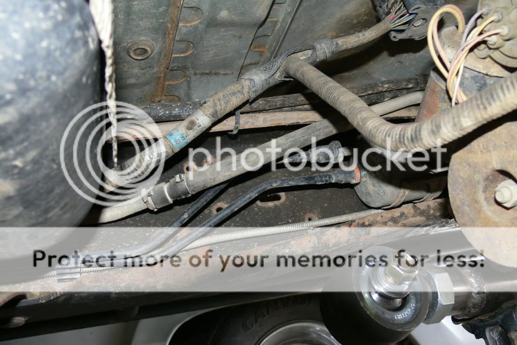

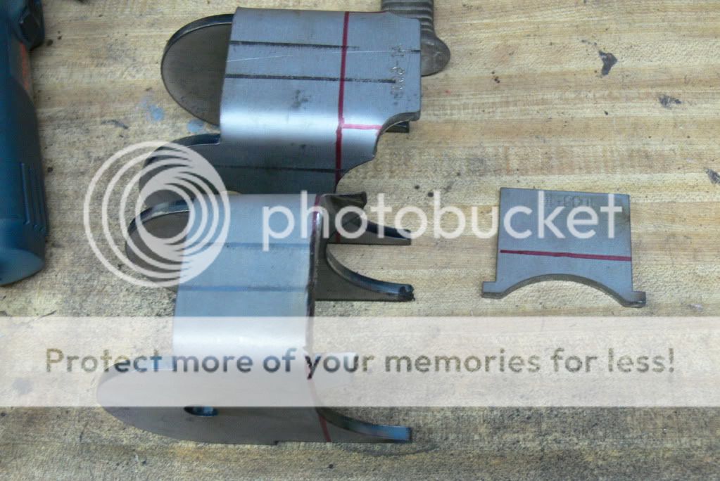

The radius arm mounts to the frame like I had hoped would not work. It caused the steel wedges to sit offset which would have prematurely worn out the wedge bushings (pics 1 & 2). So back to the thinking process! What I came up with was that the mounts needed to sit just inside the frame rails so now to come up with a way to make a solid mounting point since the rails are basically a "C" channel.

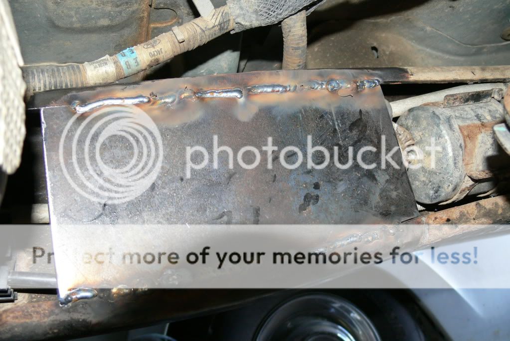

Walla! I used some flat plate to box in the frame and then used some architectural steel angle iron 3x6x 1/4". Which is fully gusseted. Here are the pics:

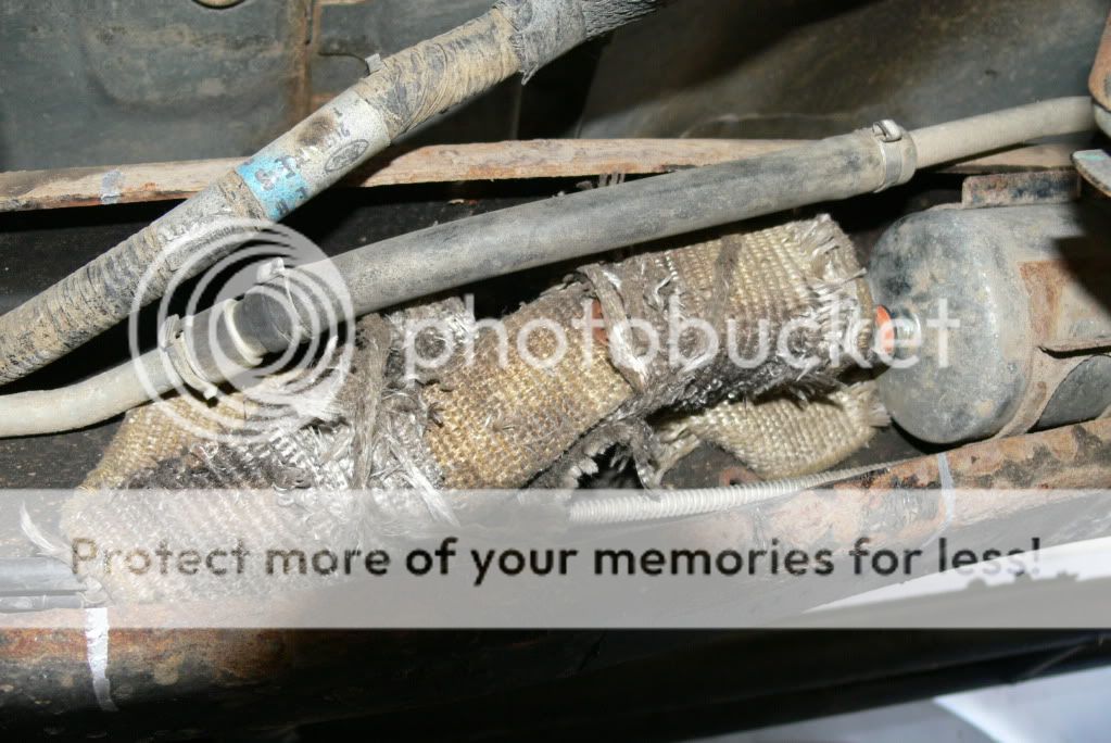

The passenger was a piece of cake to do, but on the drivers side all the fuel lines run on the inside of the frame (1 steel line & 2hard black plastic lines) and of course there is the fuel filter there too not to mention a major wire harness.
So I had to re-bend the steel line out of the way and then wrap all the lines w/ fire proof material so I could weld in the boxing plate. Then today I can weld on the angle iron and mount. I HATE welding near fuel lines! The next time I have to change the fuel filter I will be relocating the fuel line & filter location.
Did you turn the wheels with tires on to see if you hit the RAs? We had to put bends in the tube because the tires kept hitting the RAs.

They did hit when I had the mounts on the frame but since I moved them to the inside I haven't checked yet, will do today.

That tubing with stock d44 radius arms deal is amazing, I would have never thought to do that. Its looking real good, good luck with the rest.
Nice welding too btw

I got 95% of the driverside mount welded on to the frame but now the fuel filter is too close to get in and finish welding that mount. So I am going to have to figure out what I am going to do next to finish it. Did I mention how I totally hate welding aroung fuel lines!:icon_welder:
I would disconnect the fuel lines myself and relocate the fuel filter if it would be a pain to change with your new setup.

Those brandy new Kevlars are straight cake lookin'

how long you extened the arms? whats the total length?
From the flat surface to the center of the bolt hole on the joint is 51-1/2"s and I can still adjust them in or out another 1-1/2"
